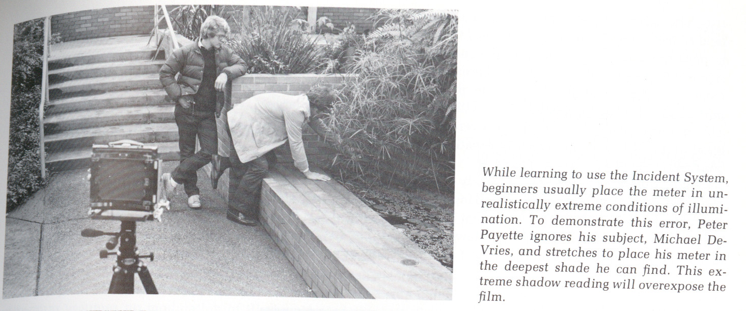

There is a book called Beyond the Zone System (often abbreviated here BTZS) where Phil Davis explains how to use an incident meter in a way that considers subject light range.
Here he's showing a mistake of reading light that's too far in the shade.

You used the Gossen correctly.
Evaluative (ESP) metering is different than weighted average. It runs a matrix of readings through a library of stored pictures. It CAN avoid being pulled towards shorter exposures by the bright background. It will try to throw out bright readings that are not important if it sees the pattern (like a sliver of sky)
Yeah. The incident meter is sampling just one spot (presumably the subject) while the reflected light meter can't avoid being pulled toward shorter exposures by the bright background.
A small point, but it can be important.
Your Gossen meter is similar to most of our meters when used in incident mode - it employs an integrating "dome" over the sensor.
As such, the incident light that is measured is integrated from all directions - e.g. the sun, the open sky, the reflections off nearby surfaces - everything that may serve to illuminate the subject. The directionality of that light is "integral" (pun sort of intended) in how the subject is modeled in the resulting photograph.
That integrating function is the reason that, when you are using the meter in incident mode, that you place the meter near the part of the subject facing toward the camera and point the meter at the camera - not at the light source.
Some incident meters offer a choice. If you are using them for general photography, employ the integrating dome and point them toward the camera. If you are using them for photographing artwork or documents or something similar, use them with a flat diffuser and point them at the light source(s).

To put is precisely: The incident meter NEVER 'samples the subject', it samples the LIGHT STRIKING the AREA in which the hemisphere is located ) and if the subject is within light similar to that area, the subject brightness will fall wherever within the range of brightnessesn it inherent falls withing. That is, if the subject is darker than 'midtone' by -2EV, it will be exposed so that it falls at -2EV relative to any midtones in that same light. An incident meter will never be influenced by the brightness of anything around because it never sees that brightness (unless the hemisphere falls into light area of same brightness)...it see LIGHT falling on the hemisphere...it sees no 'subject'
(The preceding description is somewhat simplified (to base principle), as the description does not factor that angle at which the hemisphere is aimed, when it is (correctly) aimed at the location of the lens shooting the scene. -- which influences the measurement)
Back to your metering situation...so it so, which is as if your hemisphere was indeed located in 'light as same brightness as the subject tree was located in (shade)', in which case the exposure made was indeed 'for the subject'.

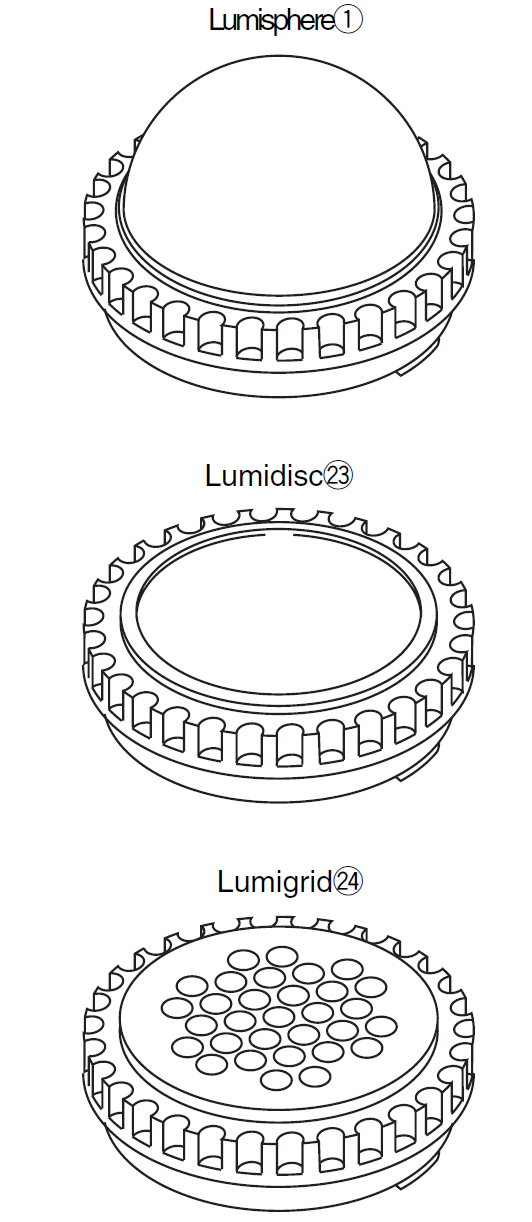

Interesting. I hadn't heard of meters with flat diffusers.
As an example, the Sekonic L398a comes with a sphere (Lumisphere), a flat diffuser disk (Lumidisc), and an attachment with a grid (Lumigrid) of holes in it. They desscribe their use like this:
Lumisphere: Incident Light Measurement. From position where subject is to be measured, point Lumisphere in direction of camera.
Lumidisc: For illumination contrast adjustment and illuminance measurement. Hold meter at subject position and point lumidisc at main light. Repeat for fill light. Calculate contrast ratio by comparing footcandle readings. Can also be used for reading illuminance (lux) reading in footcandles.
Lumigrid: Reflected Light Measurement. Point lumigrid directly toward part of subject to be measured. In case of measuring narrow areas, as close as possible to the subject, measure reflected light from main point of subject.
