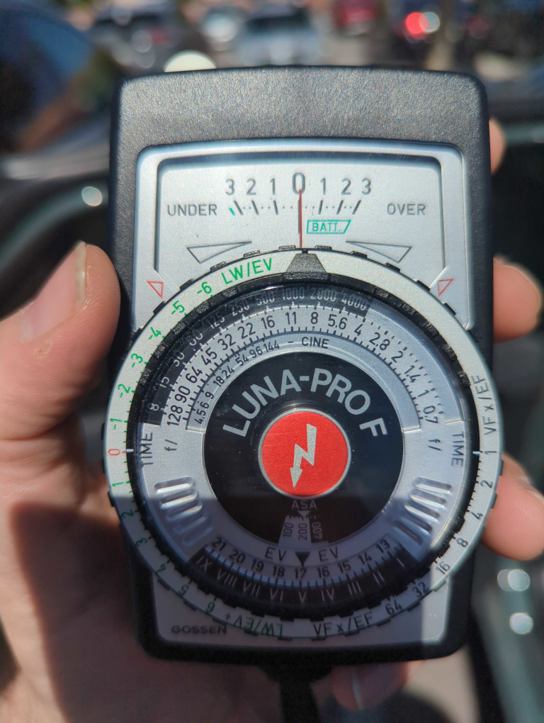

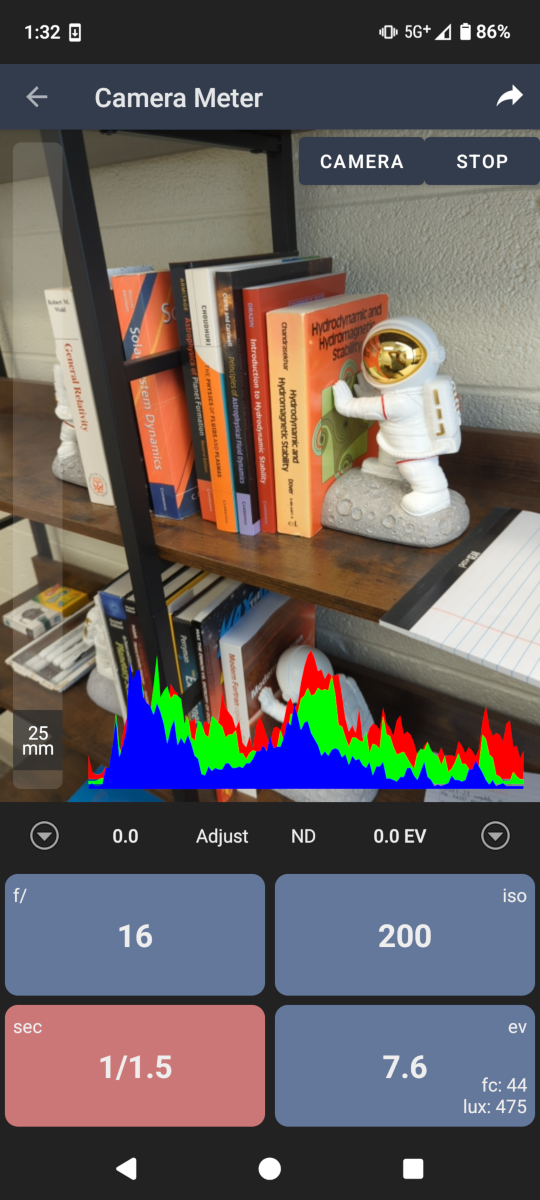

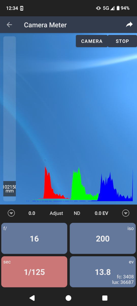

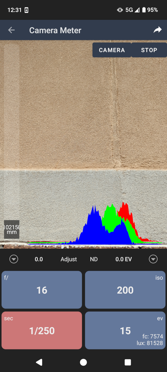

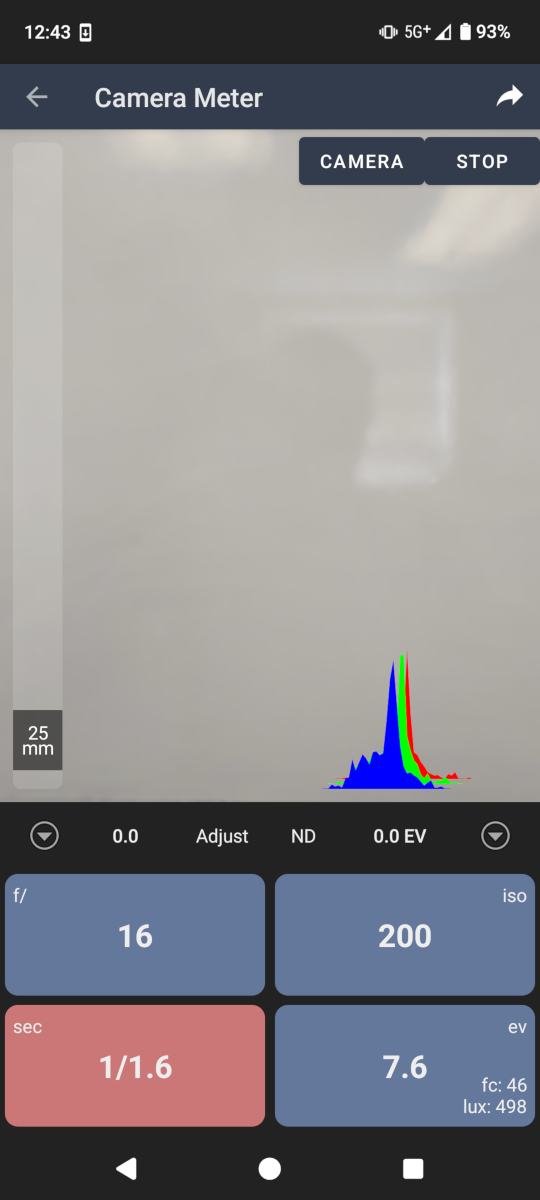

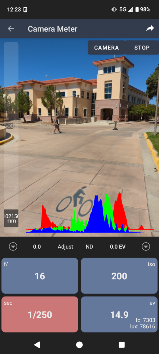

Hi dcy… whenever you can would you please re-do your post #1 measures and re-verify that your phone meter reasonably measures the scene and determine how close the LunaPro F is when used in the correct mode. Sooner than later would be nice as the arguments can easily be resolved with just a couple of minutes of effort.
Yeah. Sorry it took so long to get to this, but I've now completed a test with several different scenes.
Summary:
  • On "normal" scenes with some amount of complexity, the Luna Pro F meters about +1 stop brighter than the phone.
  • On mostly uniform scenes, the Luna Pro F meters about +2 stops brighter than the phone.
For most of the uniform scenes, I don't have a good intuition for what the correct exposure should be, but one of them is pointing straight at the cloud-free blue sky (see "Uniform Scene #4" below). The sky should be brighter than Sunny 16, right? The phone is telling me to expose the sky as if it's 1 stop darker than Sunny 16, and the Luna Pro is telling me to expose it as if it's 1.3 stops brighter than Sunny 16. So it looks to me like the Luna Pro is right and the phone is going wonky on uniform scenes.
Full Results:
For every test, I am keeping the aperture at F/16 and the ISO at 200, so we can just compare the shutter speed.
Normal Scene #1: Outdoors, in a bright sunny day with clear sky at noon.
Phone = 1/250" vs Luna Pro = 1/400"-ish ---> 2/3 stop difference.
Normal Scene #2: Indoors -- a shelf in my office.
Phone = 1/1.5" vs Luna Pro = 1/3"-ish ---> 1 stop difference.

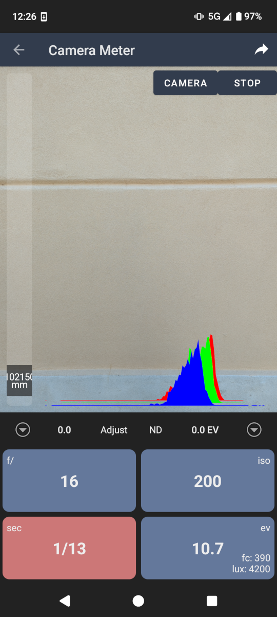

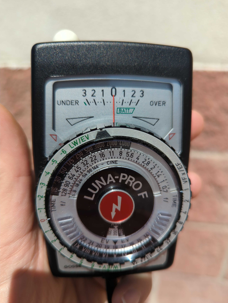

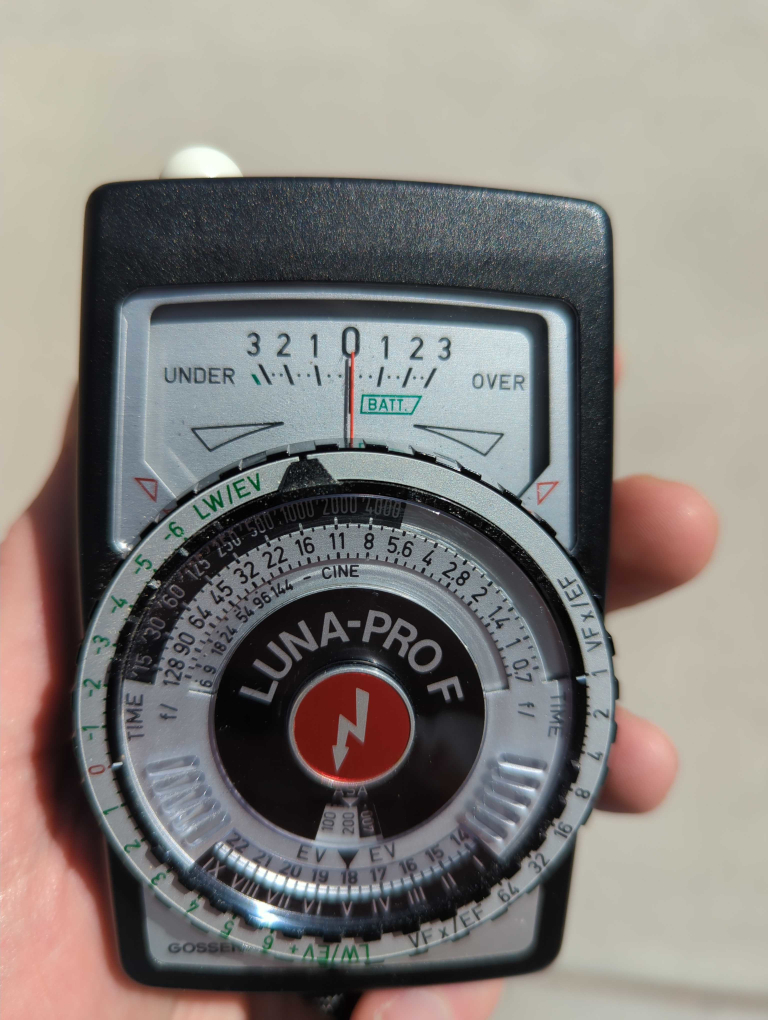

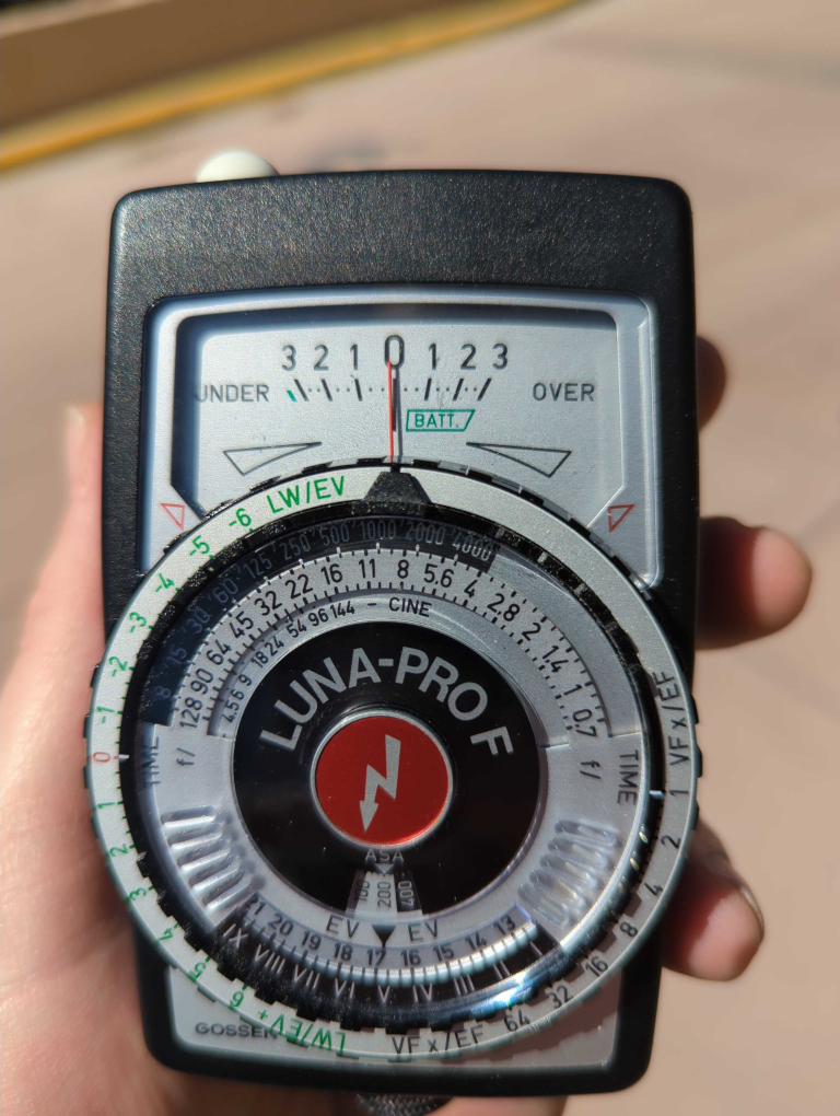

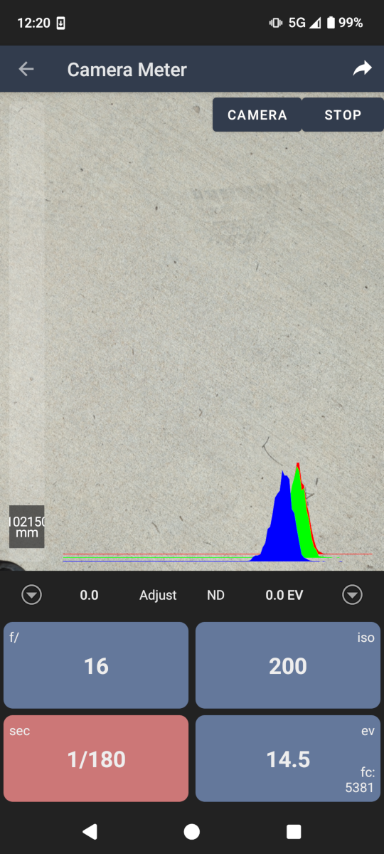

Uniform Scene #1: Outdoors, pointing at the sidewalk.
Phone = 1/180" vs Luna Pro = 1/1000" ---> 2.5 stop difference.
Uniform Scene #2: Outdoors, pointing at a beige wall in the shade.
Phone = 1/13" vs Luna Pro = 1/60" ---> 2.2 stop difference.
Uniform Scene #3: Outdoors, pointing at the sidewalk.
Phone = 1/250" vs Luna Pro = 1/1000" ---> 2.0 stop difference.
Uniform Scene #4: Outdoors, pointing up at the blue mostly cloud-free sky.
Phone = 1/125" vs Luna Pro = 1/500" ---> 2.0 stop difference.
Uniform Scene #5: Indoors, pointing at a whiteboard in my office.
Phone = 1/1.6" vs Luna Pro = 1/8" ---> 2.3 stop difference.

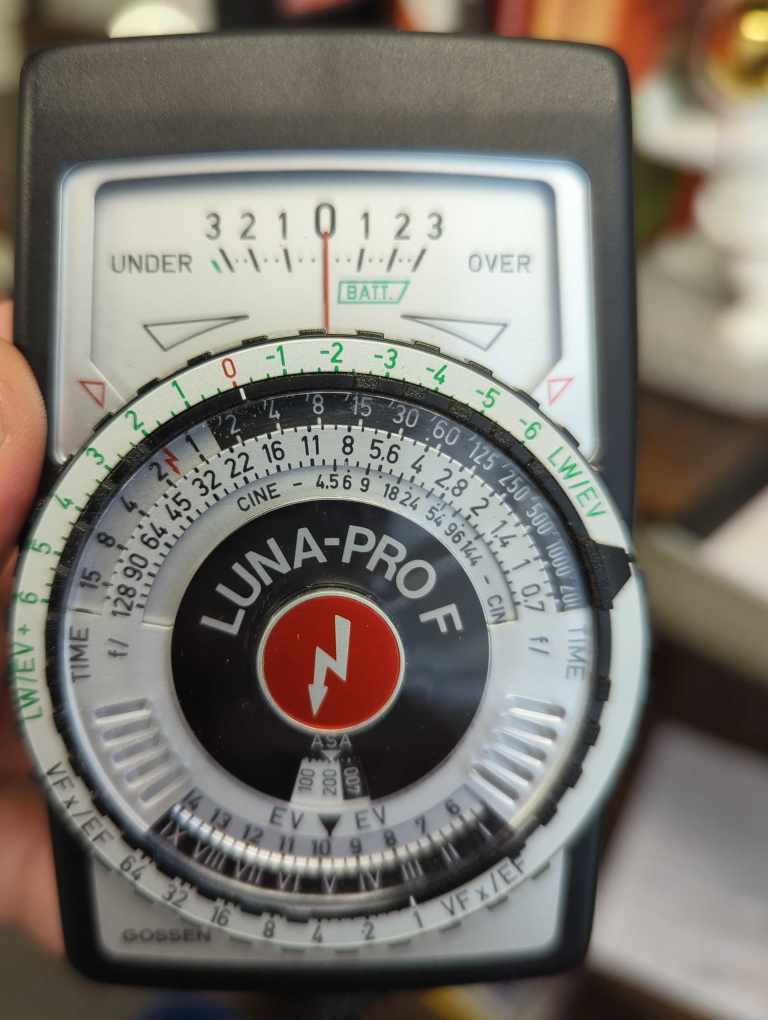

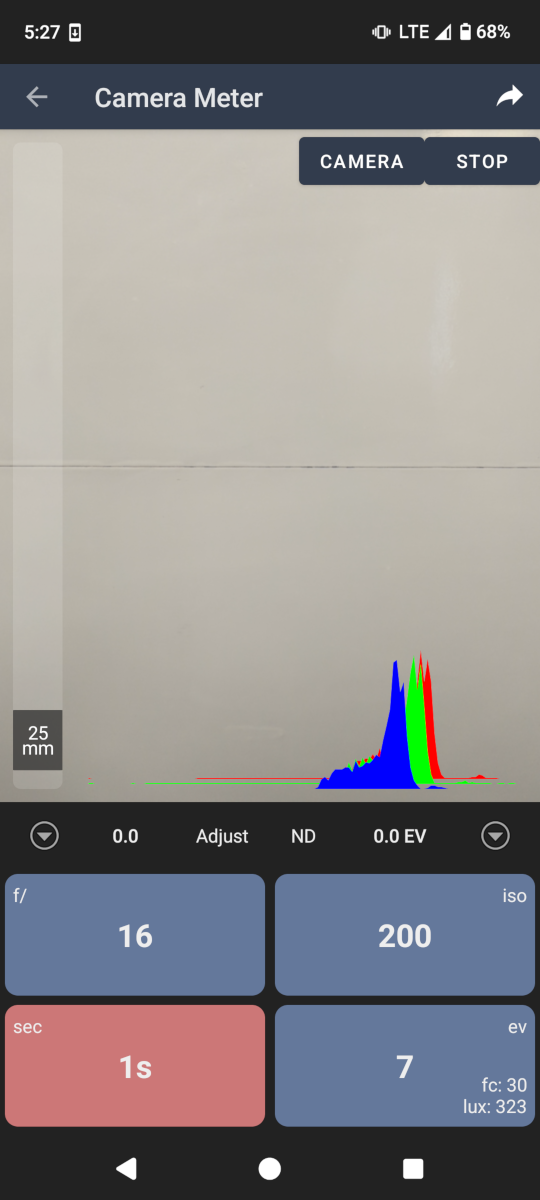

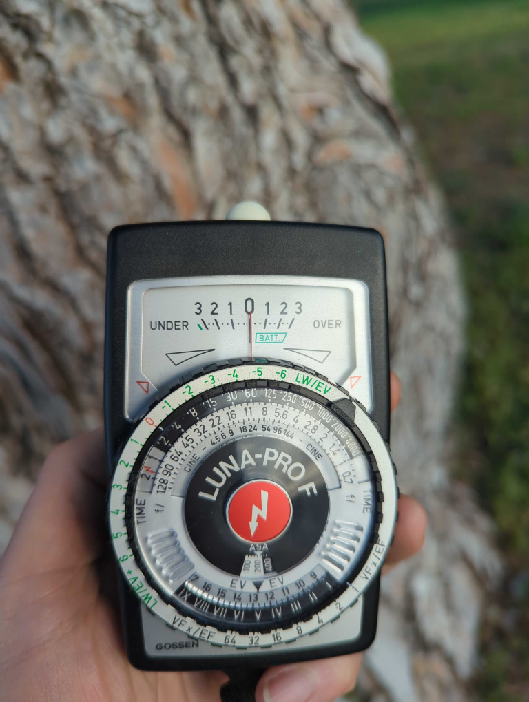

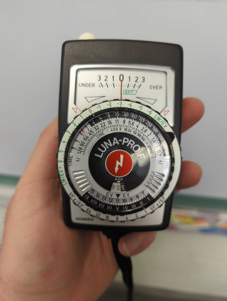

If you could, under sunny 16 condition use the Luna Pro F in incident mode and see what you get.

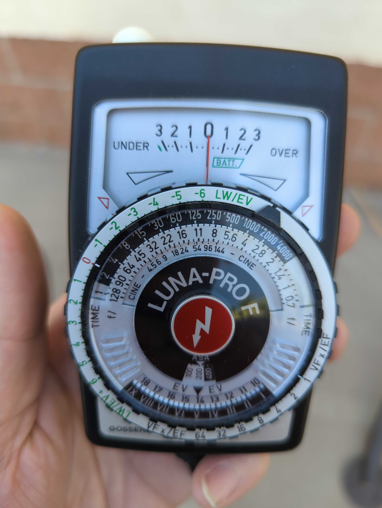

Conditions are no longer Sunny 16, but I decided to try anyway. It's 5:20 pm here and there's some cloud cover.
Summary: Phone vs Luna Pro F in incident-light mode.
  • On a normal scene outside, there is a 2/3 stop difference.
  • Testing again with my whiteboard as a uniform scene, the Luna Pro F now gives the same answer as the phone.
Full Results:
Normal Scene in Incident Mode:
Phone = 1/15" vs Luna Pro = 1/25"-ish at F/16 ---> 2/3 stop difference.
Uniform Scene in Incident Mode: The whiteboard in my office.
Phone = 1" vs Luna Pro = 1"-ish at F/16 ---> same.
Kino
Jan 20, 2006
7,876
Orange, Virginia
The app is measuring reflected light, which is sampled from the circle.
The Luna Pro is measuring Incident light, which is measured from the dome integrator.
The white board is also acting much like the dome integrator, so the readings are the same.
Apples and oranges. Nothing needs fixing.

A whiteboard would only be an appropriate subject if you are using both light measuring tools as reflective light "meters".
A better target closer would be something that reflects 18% of the light, but the whiteboard will di in a pinch.
