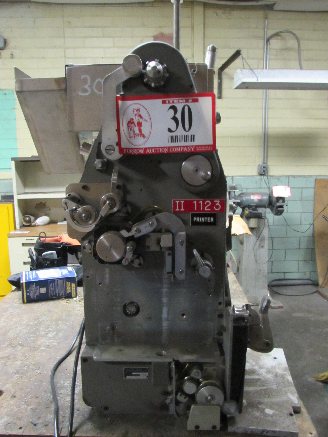

This machine must be a BEAST...
Considering the 3,000 rolls minimum daily production, working two shifts (16 hours) straight, it would perforate and pack (into a cassette) one roll of film every 19.2 seconds. Doesn’t sound too fast for me...

I don’t think so. A roll every 19.2 seconds is pretty slow by my standards — which are based on my limited experience in industrial equipment. Oh, and most industrial equipment are huge and hungry beasts, based on my experience.

As you can´t perforate film at infinite speed i assume that such a machine does perforate etc. more than one 35mm-stripe at a time.
You want to perforate long rolls as the operation takes place in complete darkness or very subdued green light. Bell & Howell perforators such as Ferrania is equipped with run at up to about 20 strokes per second. Typically single strips are perfed, rarely two together. The energy necessary for punching through double thickness is more than the double.
You want to perforate long rolls as the operation takes place in complete darkness or very subdued green light. Bell & Howell perforators such as Ferrania is equipped with run at up to about 20 strokes per second..
20 strokes, each punching 4 perfs, would be 1 1/4 feet a second. it takes 5 1/2 feet (plus an inch) to make one roll of 36 exposures. so lets say 5 seconds a roll. 3M engineering may have been able to hot-rod the process.
Movie Film is shown at 24 frames (each 4 holes) a second so such speeds are quite within the realm of normal engineering possibility.
And it is not unheard of for perforating to be accomplished as a separate process with a un-edge-printed but perforated "Pancake" delivered to the packing section. (roll of film on a core) that would allow for several perforators to work in the process. (several years ago, EFKE sold an EFKE 400 which was packaged on their line with their edge printing but made from HP5 or AgfaPan 400 Pancakes)
BOTH ROWS of double perforated film generally MUST be done at the same time to ensure that they are lined up in the correct position in relation to each other.
OH and FWIW, Kodak has patented a newer style of perforator that can work MUCH faster by not stopping and starting the film.
That’s the T perforator of the late 1940s.
