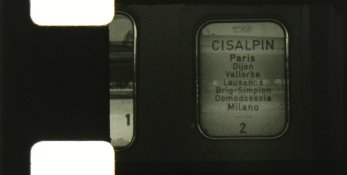

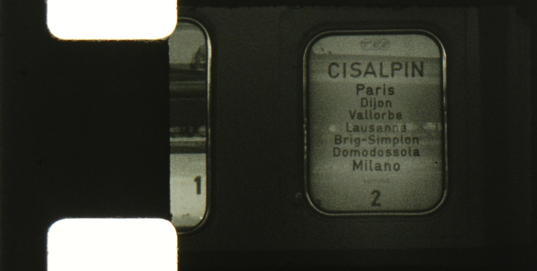

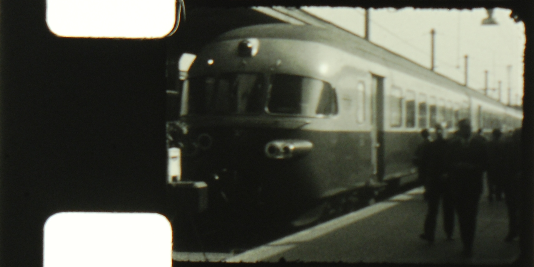

These are a couple regular 8mm frames of P30 from the 60ies, looks very beautiful when projected. It would be a very nice alternative to fomapanr. In the meantime, I can't wait for my 35mm P30 :smile:
