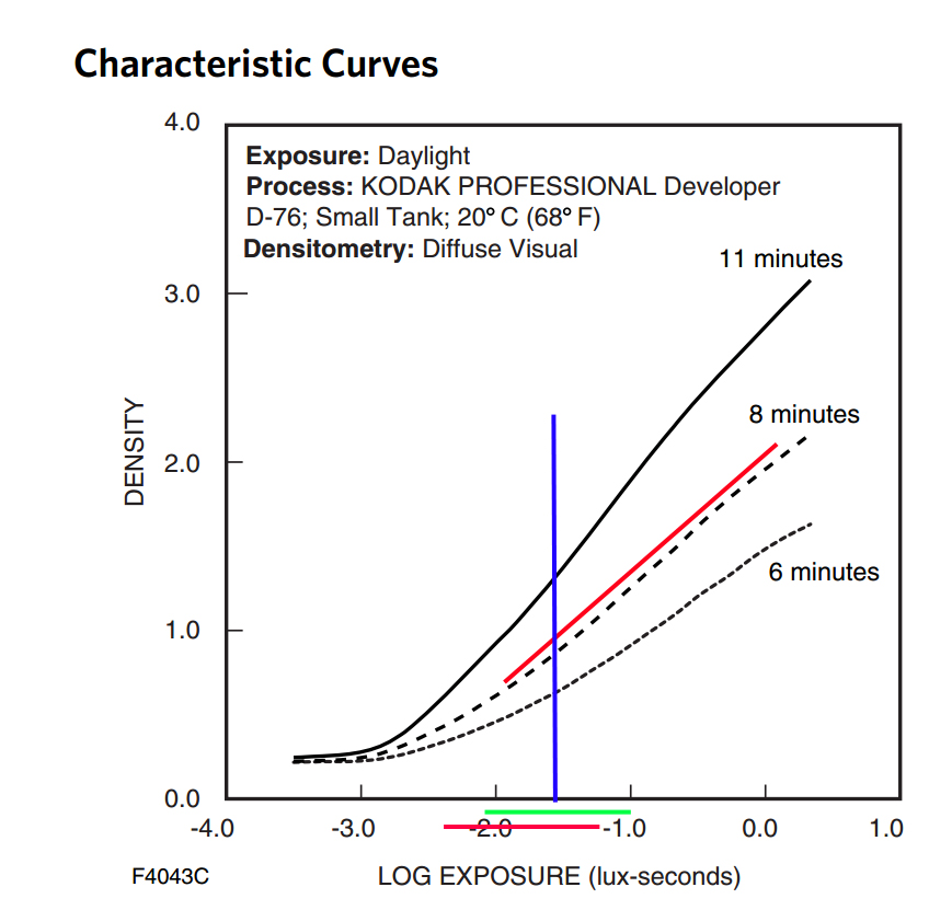

Matt, that graph tells what gradient the sensitometric "curve" will have depending only on development, use the EI you want and will you have exactly the same CI.
Of course EI may have a dramatic impact in how scene is depicted, but not from a change in the CI.

What else? Nothing. A different contrast index means a different characteristic curve. This can only be obtained by different development. For a given developer, dilution, agitation and temperature, only time can give a different curve.
Anon, anyway perhaps Matt's point comes form a different effect, if changing CI then film speed is marginally modified, a higher CI moves Speed point a bit to the left.
So it's not a two way relationship, modifiying EI does not modify CI, but a change in CI modifies a bit Film Speed thus having an interaction with exposure.

What should the correct CI be when developed for the same time at speed 800 compared to 400. Can this be worked out?
If you develop the same time you obtain the same CI, see this graph:
Blue bar shows the right exposure as recommended by meter at EI400, and aprox 8 min gives the ISO normal contrast of 0.62 CI gradient: density woud rise additional 0.2D for each stop of additional exposure, If yo don't change the development (8min) you always have the sensitometric response labeled "8 min".
At the bottom I placed a sample scene dynamic range in green of 3 stops latitude, in red shows the range that it would take the same scene if closing 1 stop the diafragm. If using EI 800 you will have the same gradient but densities would be lower.
If the CI remains the same because the development time is the same then what will be the changes in a 800 negative compared to the identical negative exposed at 400 and will these changes be noticeable in the prints from the 400 neg and 800 neg respectively?
If you don't change development (say you alwys use 8min), a lower EI will produce lower densities, for the gren range (EI400) the 8min curve shows the densities you will obtain, at EI 800 (red range in x axis) densities will be lower.

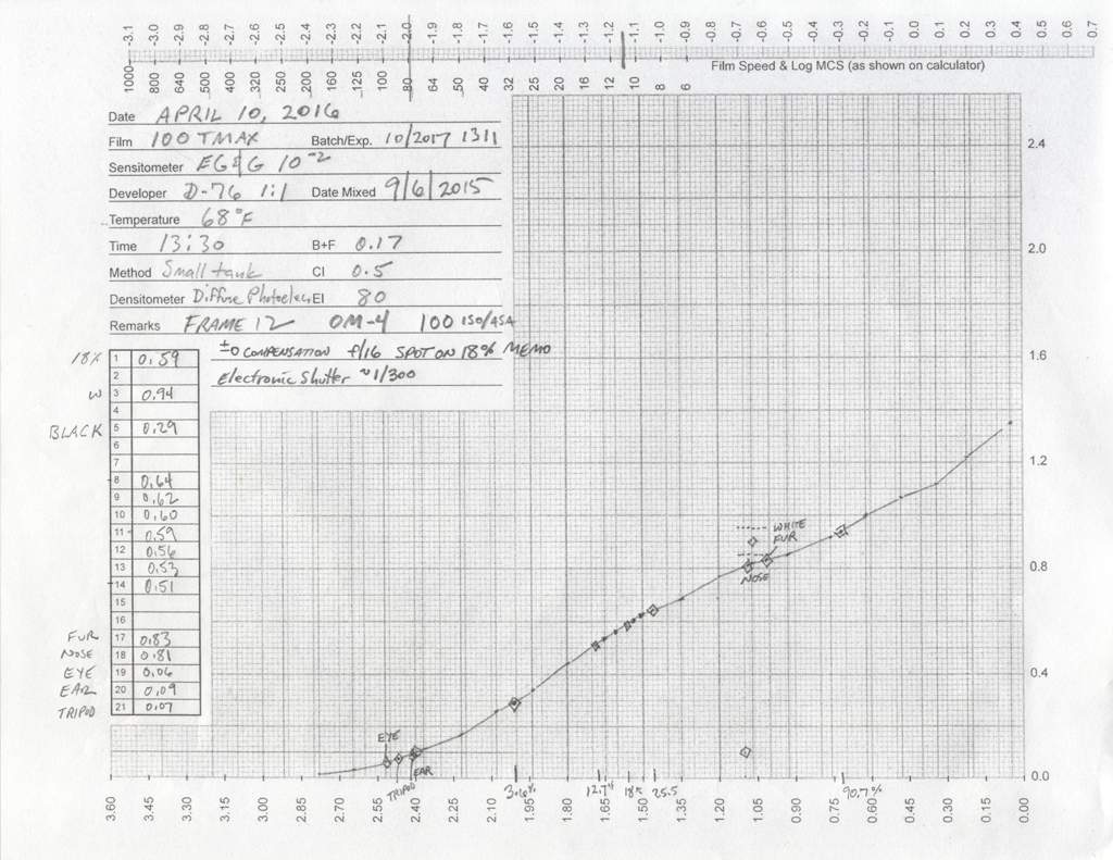

This might illustrate what’s going on. This is TMAX-100 but it’s similar to the study we need here. It’s a properly exposed full scale picture shot at ISO speed and developed to 0.5 CI.
Notice how “if” I had set the meter to 200 instead of 100, the darkest point in my picture (my dog’s eye)... would be shifted “to the left” by 0.3 units.
This would put the eye at 2.82 on the horizontal scale. Just about 0.00 density.
Notice that the curve has pretty good contrast all the way down.
You almost wouldn’t be able to tell the difference.
(I might have to say flare probably steals a lot of the contrast in the toe. So I probably wouldn’t get a clean zero.)
So TMAX-400 developed to 0.5 and exposed at 800 would probably just use up that little extra bit and put my dog’s eye at zero. It works because we have good meters and coated lenses. And that short, straight toe that is characteristic of TMAX films.

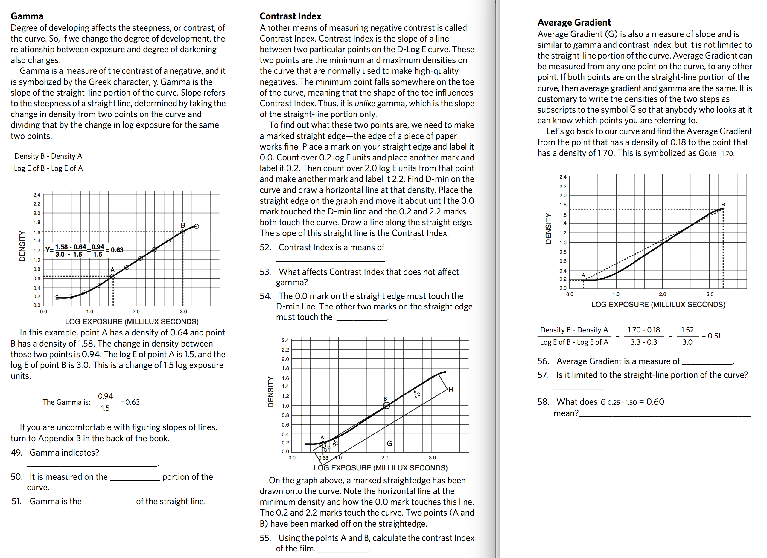

Here's the transparency, scaled to fit my graphs if you desire...
http://beefalobill.com/imgs/cntrastindexmeter.pdf

In the majority of photographic applications, the level of exposure is such that much of the toe of the D-log e curve is involved. The use of CONTRAST INDEX [rather than GAMMA] is then likely to be advantageous. "Contrast Index"; C. J. Niederpruem, C. N. Nelson et al 1966.
