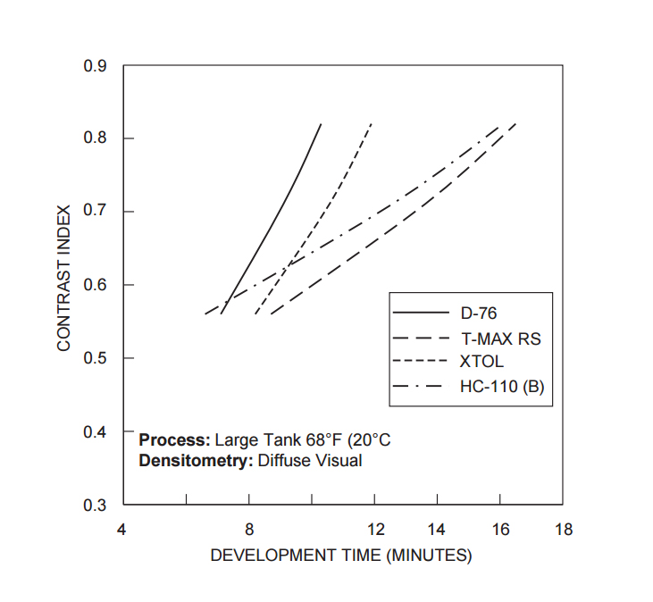

The Tri-X datasheet has the chart you need. For several developers actually.
Right! The graphs you want are labeled "Contrast Index Curves" and you pick the one for your film size that best fits how you develop your film. For example the time I use ( 13:30 for D-76 at 1:1) best fits the graph "Contrast Index Curves KODAK PROFESSIONAL TRI-X 400 Film / 400TX, 35 mm and 120-size"
Aiming for 0.62 meets the contrast parameters of ASA/ISO. If you develop to that contrast, the reference point for measuring speed is where the curve crosses 0.1 above base plus fog. If you develop to 0.56 contrast and want to find speed... you'll have to locate the 0.3 gradient and then determine the appropriate index based on that (I use a Delta-X transparency for the purpose). But you should probably develop a test roll to 0.62 to keep things simple.

See this graph from TMX datasheet, for each developer and development time it tells the exact Contrast Index you will obtain, independently of exposure, development directly determines CI:
I'm not going to disagree, but I would point out that the graph doesn't say anything about how contrast index is determined - it just says that it changes with changes in development - which isn't the issue, because it does.
What else can change it?
@pentaxuser It seems there's something wrong with the times/CI for TMax 400 in the j-109 datasheet. Other films have the same time and CI for box speed and plus one stop, but not TMax 400. TMax 400 isn't a 800 ISO film. Had it been so, Kodak would be noisy about it and would proudly be labeled accordingly, as the world's finest grain, sharpest, etc 800 ISO film. If you underexpose this film (and any other for that matter), you will simply lose some shadow detail. You'll probably need a harder paper/filter grade, but you will be able to pull something fairly decent, or even fine from it. If a stop less exposure is crucial to get something usable and sharp, instead of blurry, then go for it. No need to alter development time and push process for a stop less exposure, it's just not worth the hassle and complexity. Just mix such exposures with proper ones and be done with it.
