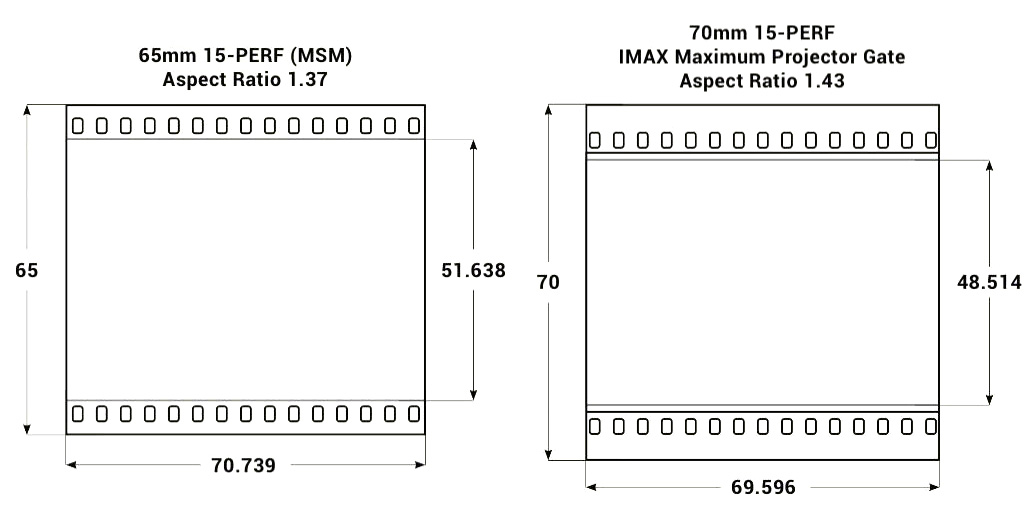

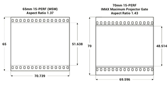

What I found on Kodak's page is: "filmed in a combination of IMAXยฎ 65mm and 65mm large-format".
The 70mm film is the delivery film โ€“ they use it for prints distributed to theatres (attached). It has different sprockets father from the edges compared to 70mm Type II film used for photography, but if you swap the roller/gear to o-ring you could in theory expose that too. And should be available in colour slide!
