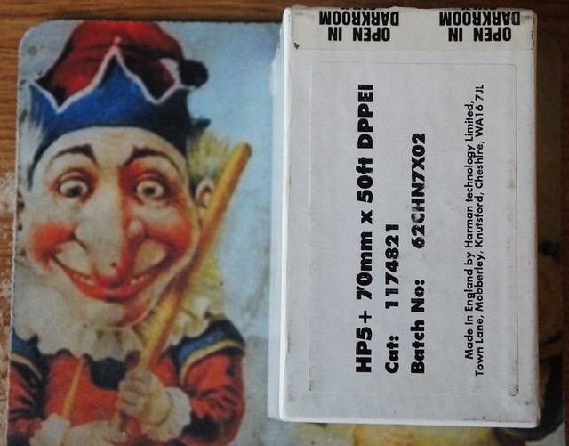

This arrived last week from B&H, they discounted a slug of 70mm HP5+ so I bought a roll of 50 feet about 25% off the regular preset Ilford price. I think I will load these into 12 and 24 exposure rolls.
Punchinello and 70mm Cheap HP5+ from B&H by Nokton48, on Flickr

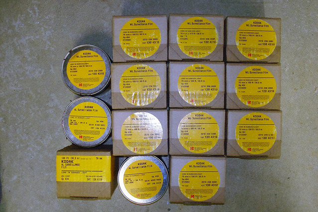

70mm Kodak Surveillance Film by Nokton48, on Flickr

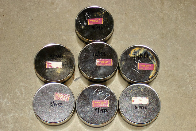

70mm Kodak Plus X by Nokton48, on Flickr
My current 70mm favorites are Kodak WL Surveillance film (a lot like old original Tri-X IMO) and a stash of original Plus-X from around 1981. It has gotten better with age :smile:

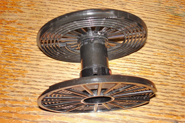

70mm 2502 Jobo Reel by Nokton48, on Flickr
This is a JOBO 2502 reel I made wider, by hacking in a plastic 35mm cannister cut down, from a roll of Efke 25. The other cannisters won't fit! So I can run up to 220 lengths of 70mm in my JOBO Multitank 2500 units.
Jobo 2502 70mm Reel Modification by Nokton48, on Flickr

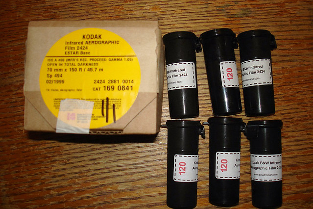

70mm Infared 2424 by Nokton48, on Flickr
This is the same emulsion Kodak released as 35mm High Speed Infared. I found a 150 foot 70mm roll on Ebay hopefully it has aged OK. Also David Romano used to slit this stuff down and reroll it in 120 paper. I still have six rolls, plus one that needs to be developed. I always liked 35mm High Speed Infared in D-19 back in the day..
