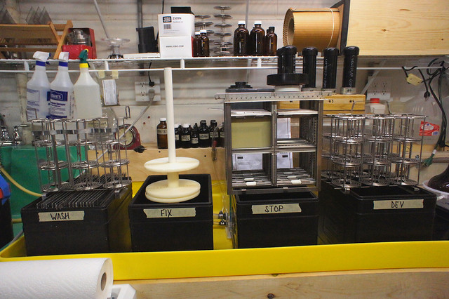

In the fix tank is the 70mm Dental XRay reels from NDT, along with the NDT dipstick. This part is simply made by NDT of PVC pipe and a plug. The NDT reels hold about 12 feet or so and load from the inside out, like a steel reel. I can run two twelve foot rolls of 70mm in the 8x10 Kodak 3F tank. Of course you could use plastic pails, too.
I cut into 12 exposure strips for drying and then into strips of four when Vue All neg filing.
I realize I set up my film developing graduates left to right too! :D
But that is because the sink is to the right of that spot of the counter.
It only really matters when I use trays to develop prints. If you have the tongs in your left hand, it is easier to pull the prints from right to left!
A couple of questions about these 70mm plastic NDT reels. I have watched the trick of assembling two Paterson reels into a 70mm-capable reel, but I'm curious about the 70mm reels. What is their height and diameter? For example, could they fit into the larger diameter Nikor steel tank (about 4.25" ID, wider than a Paterson)? That may be wishful thinking, but it would be cool.
Second, has anyone found an low-overhead NDT supplier? I can find several suppliers that sell the reels for $16-20, which is reasonable, but then they tend to have very large minimum orders or expensive shipping - their market is industrial companies, not photo hobbyists.
