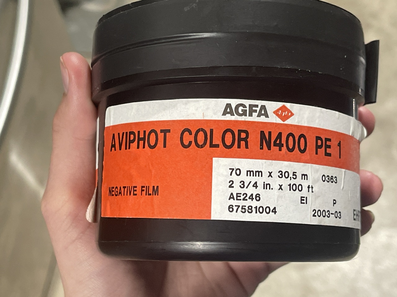

I acquired this roll of Aviphot Color N400 a bit ago, and I have no idea what to expect. Apperently it has been frozen or cold stored since new, but with 400 speed C-41 film, I still feel like it’s kinda If a crapshoot. I’ve tried finding examples online, but no such examples appear to exist. I really don’t want to unseal it unless I know for certain that it’s something I want to use. Anyone who can shed some light on this?

I bought a fresh roll from an Agfa Dealers/ Aerial Photography Guys down in Florida. Don't shoot color, they also had Aviphot 200 B&W (same as Rollei 400s). Heard N400 is rather grainy, I believe mine is type II perfed. I think Europano here has some experience with it. Might be OK in C41 chemistry?? For color shooters it might be worthwhile.

I bought a fresh roll from an Agfa Dealers/ Aerial Photography Guys down in Florida. Don't shoot color, they also had Aviphot 200 B&W (same as Rollei 400s). Heard it's rather grainy, I believe mine is type II perfed. Might be OK in C41 chemistry?? For color shooters it might be worthwhile.
Supposedly fine in C-41 according to the data sheet, but that data sheet is the only info I have on this stuff. I bought it on impulse because it was so unusual, and relatively cheap, not realizing how scarce info on it was.
Half tempted to try and sell/trade it for something else, but also curious to see results. I asked Zach at Mercury Camera about it, and he said that he was planning to test it, but I haven’t seen any results from it. Guess we’ll see.
