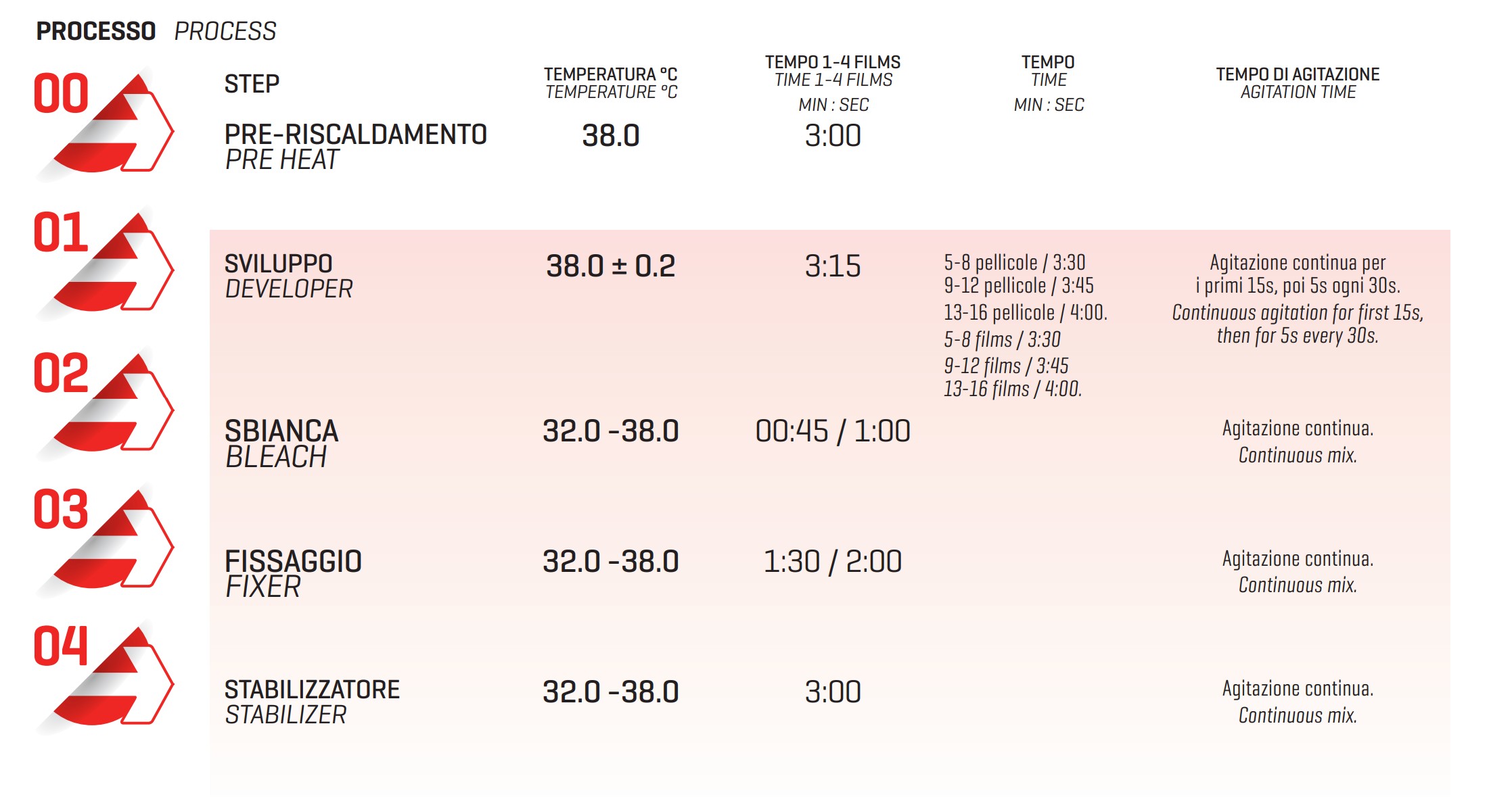

I normally do follow the manufacturer's instructions:
This coming from the instruction sheet which is included with the kit.
And their processing instructions:
Yeah, it's an oversight in the Bellini instructions that they mention a processing sequence that does not include a wash step. I can't explain why they recommend a washless process; it doesn't make any sense for home processing.
