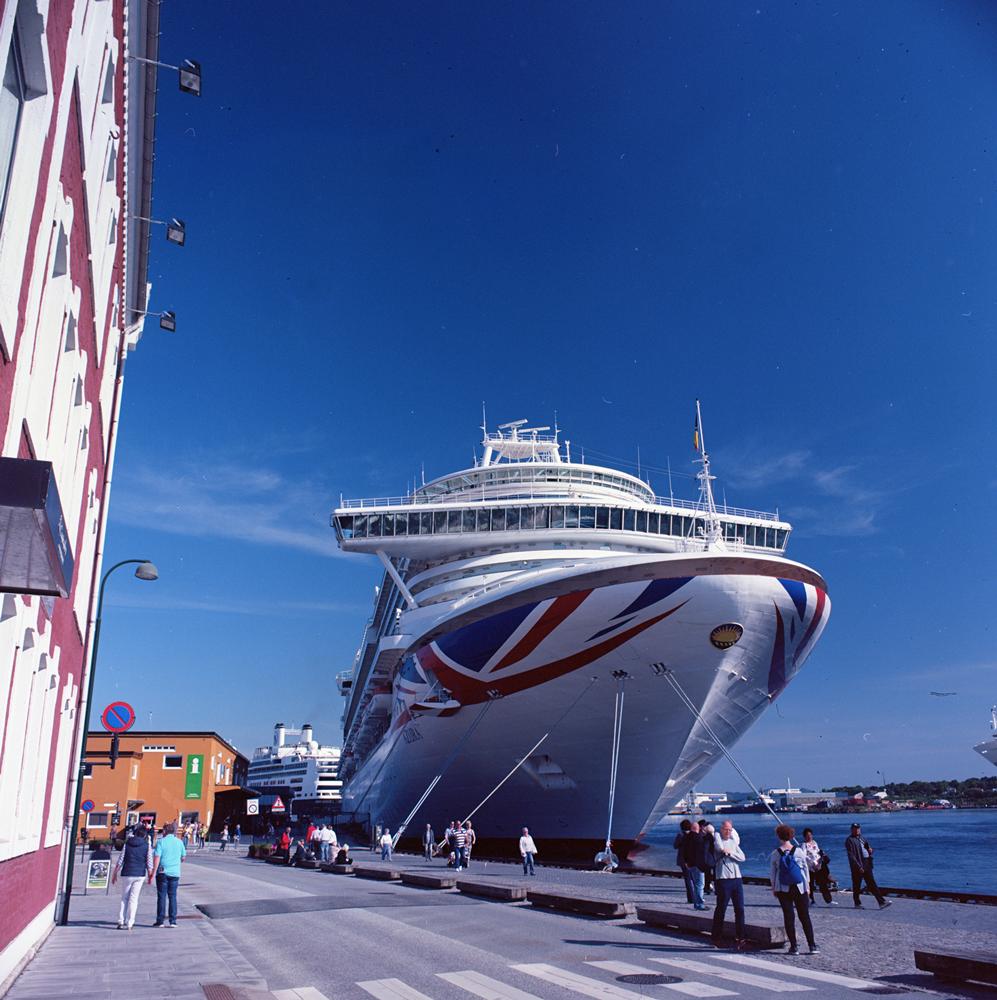

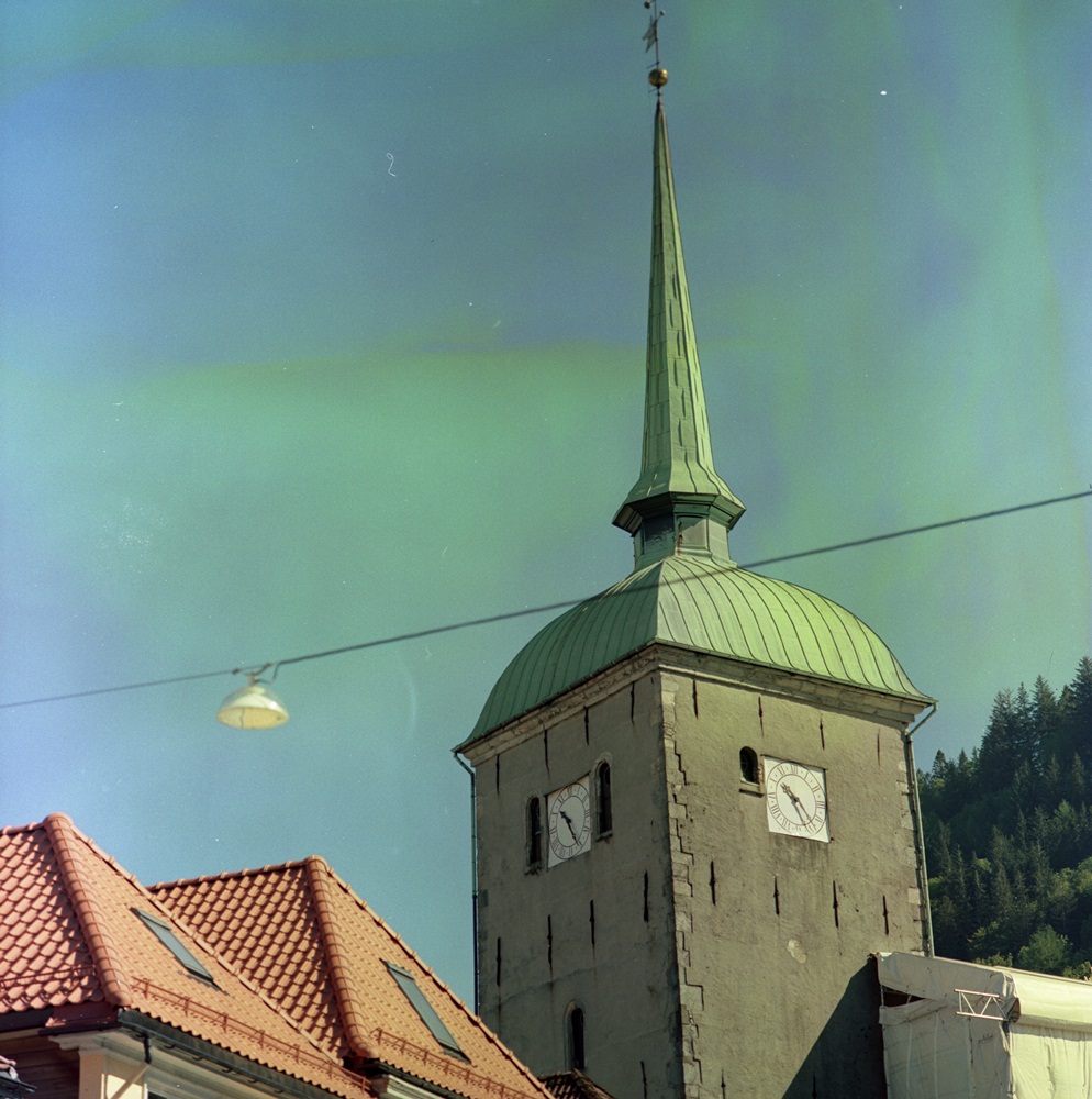

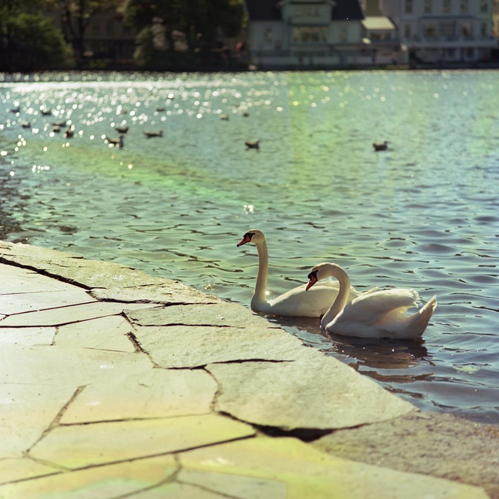

Bollocks to Bellini!
Sorry, no. Just no. Not happy with it at all. In fact, it's safe to say I'm pretty pissed off with the way some of my films have turned out.
Despite my usual regimental temperature control (which is AFAIAC is spot on with 2 accurate digital thermometers, a Sous Vide, metal tanks and all that) and despite agitation that matches not only Bellini's recommendations but also my own that I always use with the Digibase kit (also E6 and B&W with great results), and adding a wash step before the stabiliser, I get streaky coloured films straight out of the can. Only, it's not the whole film, just random frames that get the streaky effect.
From Ektar 100:

Moar Bad - Broken Swans, still the same roll of film

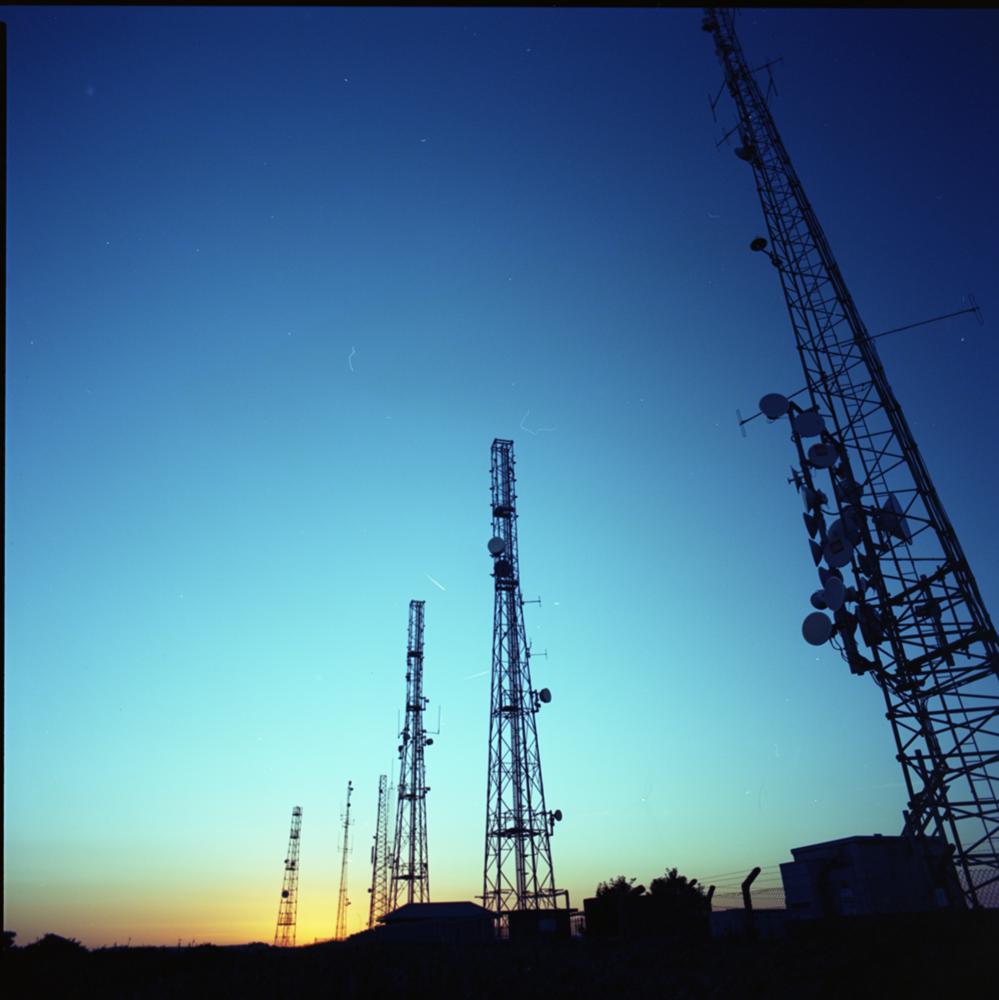

Another Roll of Ektar 100:
Good - The view behind me from what I was there to photograph...
Crap - Erm, oh... And this frame was the one before the antennas.

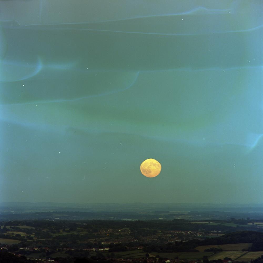

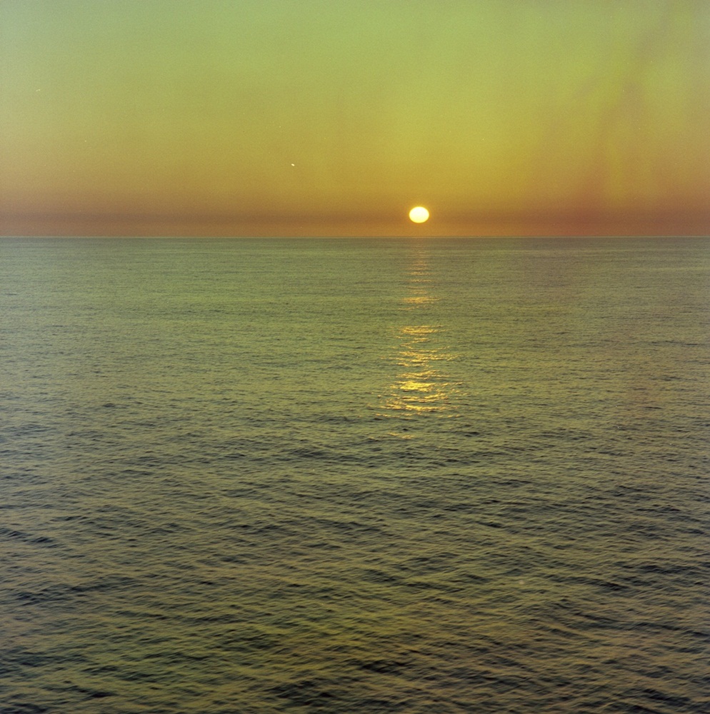

And Portra 160 got ruined too:
Good - Happy...
Really quite f*cked off with this now. Not happy. Same roll of film again.
These are just 3 of the 7 that I've developed using this rubbish. I did a few 35mm rolls the other day which turned out just as randomly ruined.
In conclusion then: Nice try, but no. Some of the step times are stupidly short to a point where you can't get the chems back in the bottle quick enough, like the 45 sec Bleach. And it wrecks your shots.
The rest of this crap is going down the drain and I'm going back to the Digibase C41 kit.
Notes: All chems were mixed to manufacturers specs using distilled water at the correct temps. Scanned in totally-everything-turned-off pro mode using a V700. All films were scanned within 12 hours of developing, and quite a lot of swearing took place.
