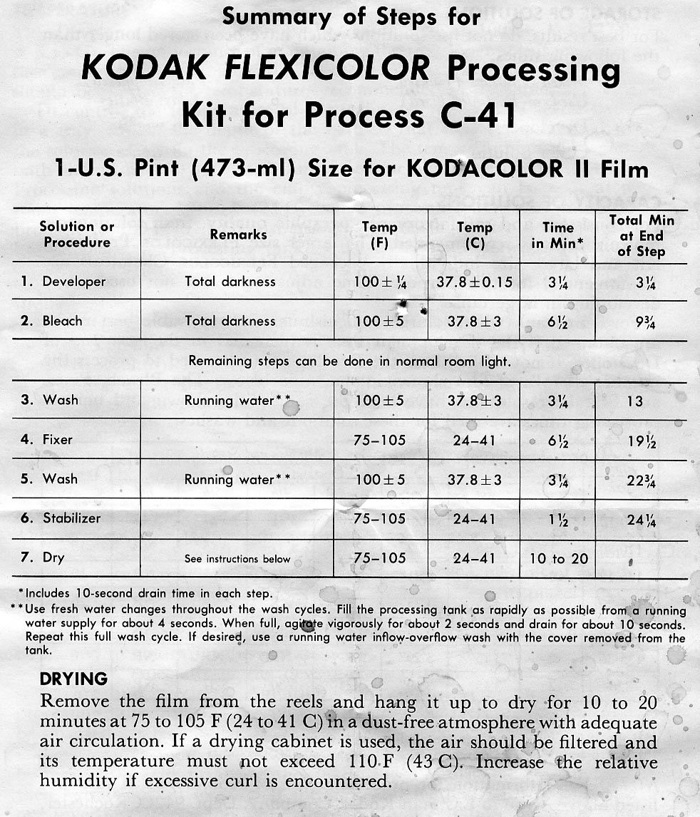

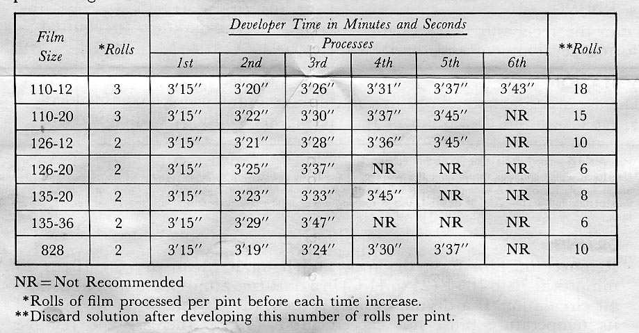

To simplify things, here are the process instructions and the capacities of C41 for home processing.
