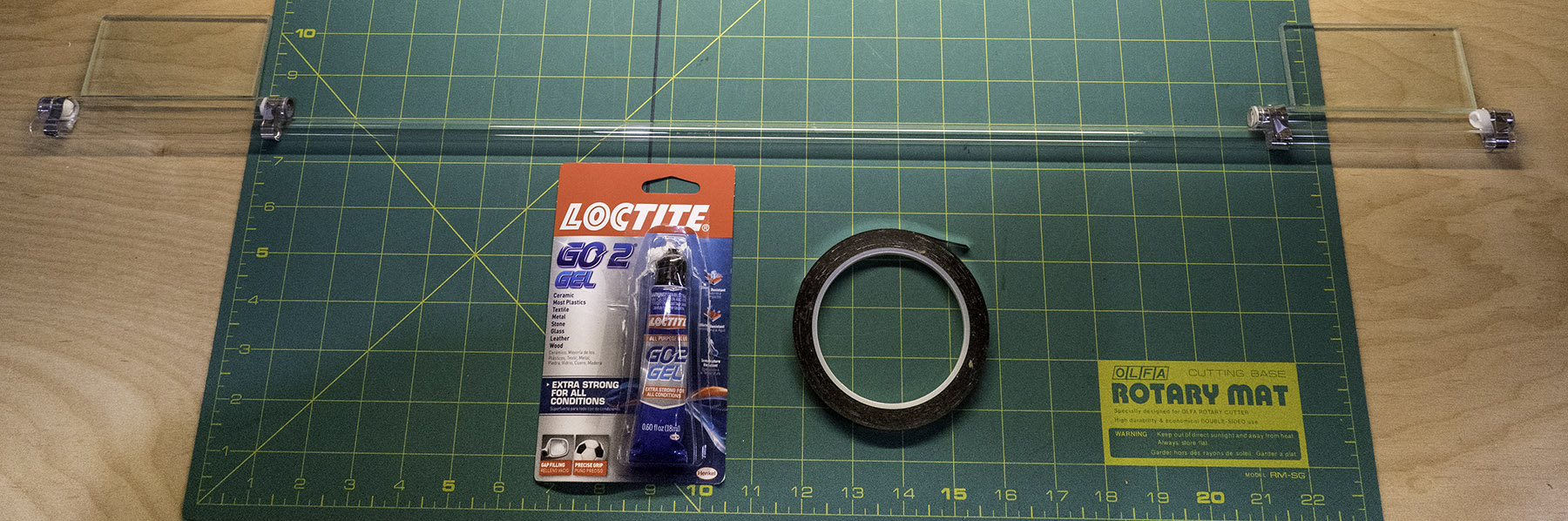

I think I have a way for you to make high-quality coatings without elaborate ventilation. You'll still need to source a few items, but they're almost certainly easier to get right now than anything to do with ventilation. The idea is to make a very long puddle pusher. You'll need a long glass tube (Pyrex or borosilicate) at least 11 inches longer than the width of the surface you want to coat, two 5 inch puddle pushers (sold as 4"x 5"), adhesive (I like Loctite G0 2 Gel), tape (preferably film tape), and UHU tac wall stickem, or a generic equivalent). Basically, you're using the two commercial puddle pushers to make handles for your long glass tube. Tape one to each end of the glass tube with the number of wraps of tape required to bring the coating gap to what you need it to be. Run a line of adhesive between the tube and the puddle pushers, let dry, and then flip the assembly and repeat on the other side. Plug the ends of the long tube and the puddle pushers with the UHU tac.
Use the wet paper coating technique, pulling the emulsion down the canvas with one hand on each handle.
The pic here is the mock up.

That's an interesting rig - but in my experience, there's just no way to get the canvas really flat, and this month it's around 28x36", but my goal is up to 50x60-some inches. I did just get a roll in of pre-primed canvas that's probably a thinner weight than I've been using, but another issue is the weave of the canvas can really show up with rollers or brushed since it's a little raised. So other than issues of how gelatin may react to spraying and health/environmental concerns, my brain instantly goes to spray coating. If it's a bust, I can probably live with brushing, but I'd probably need a way to brush it flat with something like a tight-stretched electric blanket under it, who knows.

Perhaps someday I can persuade you to make your own emulsion :smile:. If you first prime the canvas with handmade baryta subbing, you can coat handmade emulsion, made with a slightly lower water content, using wet paper technique. You'll wet the primed canvas and squeegee it flat to your coating surface. Then, a glass tube coater will work perfectly.

Thank you for giving me an interesting engineering challenge :smile:. I see an easy solution. I'm pretty sure you would, too, or perhaps something even better. Making your own emulsions is so much easier than your spray setup, I hope you try.
