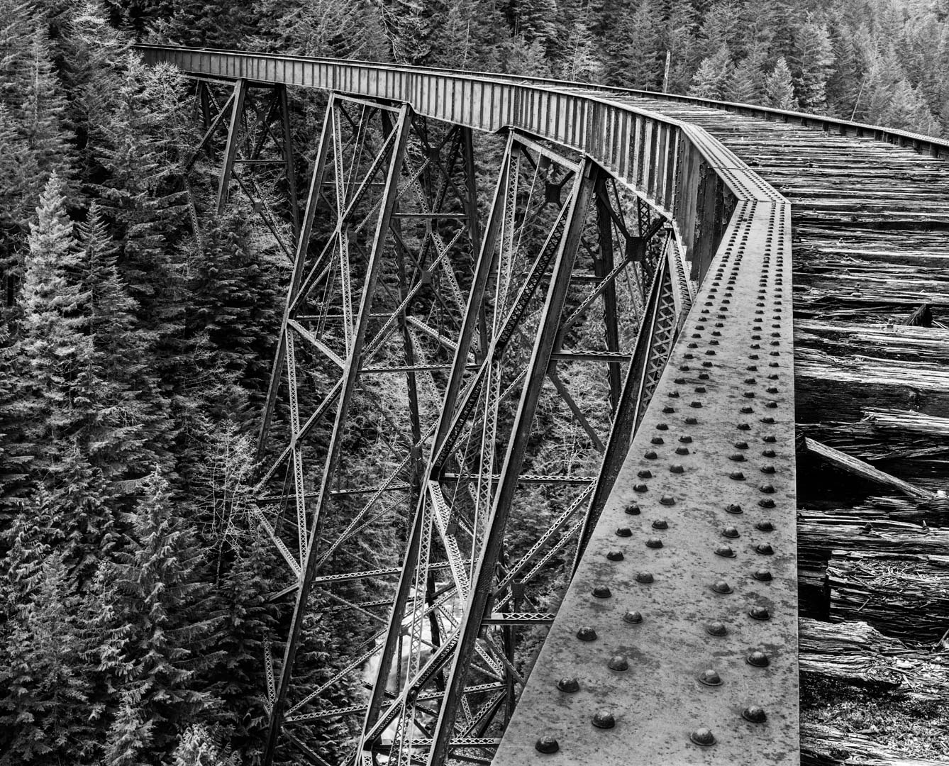

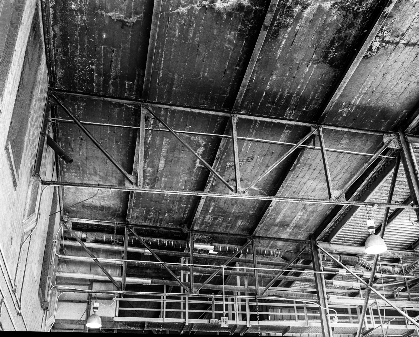

In the spirit of posting photos, Here are two photos, one is Acros, the other is HP5. Which is which? And how can you tell which is which?
To make it fair, both negatives are the same format, scanned with the same machine at the same resolution and exported at the same size.

@Craig I’m curious to know which is which. I would venture the one on the left is HP5, but your point is well-taken.

I'm guessing assuming this is designed to trip me up, but in my total lack of personal experience with either film, I would say img015 is Acros.
My first post was somewhat adversarial. I hope my second explained my perspective a bit more clearly. Even here, we've got an indoor shot of a relatively limited space, vs an outdoor shot with considerably more depth of field (and probably smaller aperture as well). If someone took either shot twice, on different film stocks, with the same settings, and developed to the same standard (and to be fair, Henning was quite rigorous with his analysis), I would expect it to be easier to learn from the comparison.
Regardless, I really do think the first photo is Acros, and I look forward to being schooled. 😆

Given that fact, the relatively bright rendering of the conifers in the train trestle image on the right make it the more likely candidate for Acros, unless some kind of supplementary filter was involved. But given that there is no foliage at all in the other picture to compare to, it's hard to say. A fairer challenge would be the very same subject shot with different films.
Correct! No filter was used when exposing either negative. The indoor shot is 4x5 HP5+, the trestle is Acros.
Holy Moly your Ladner Creek Trestle image looks like mine! Great minds thing alike!
