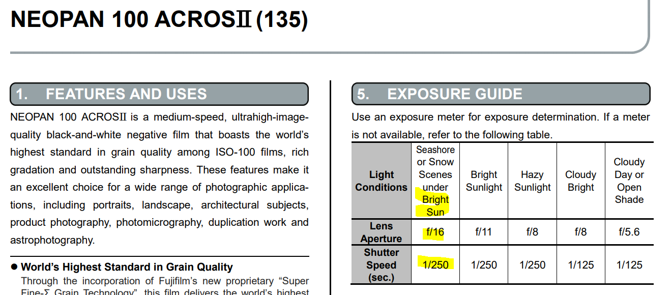

One thing I am puzzled about (because I don't remember this from the original Acros) The snip of the Fuji datasheet shows that the "sunny 16" rule doesn't apply the same way. Rather than 1/60th or 1/120th of a second at f16 in sunny conditions, Fuji recommends 1/250. That implies a faster film.
Thoughts?
Thoughts?
Bright sunlight is sunny 16. This hasn't changed. The beach and snow has always been sunny 22, so to speak.
Yeah, I'm tempted to slap my forehead Homer Simpson style here... I will refrain, mostly because my slapping hand is holding the Leica M6 which would dent my forehead.
