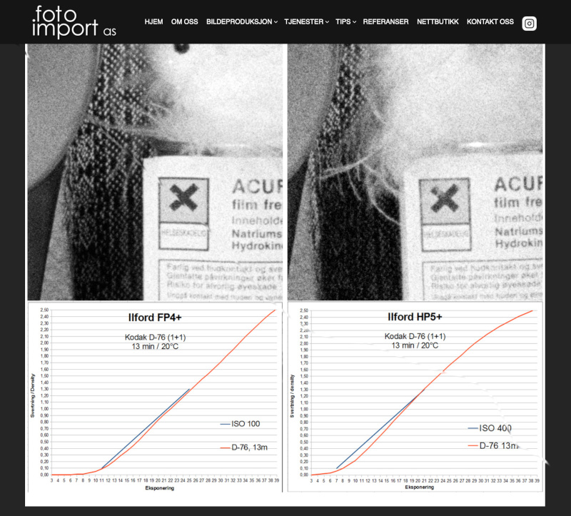

Answering the need for some actual test results in this thread, there is this excellent website, which I've referred to here on Photrio before. It's in Norwegian, but English speakers should be able to make out what's going on if they squint a bit. It is easily possible to set up on your screen a side-by-side comparison of FP4+ and HP5+ in the same developer. Here's a screenshot of them in D-76, but I've had to reduce resolution considerably to upload it, so you'll need to visit the site yourselves.

I may need some help with this from others with better insight, but the way I interpret the curves on that fotoimport.no web site is as follows.
HP5+ appears to have a longer toe than FP4+, implying less separation of shadow tones if you underexpose HP5+. HP5+ also has a pronounced shoulder, implying some compression of highlights (not necessarily a bad thing). HP5+ is renowned for its latitude, but surely its tonality would be affected by where you place your subject on such a curved curve? The shoulder of HP5+ seems to be straightened out by the use of TMax developer, compared with D-76 (I'd like to understand how).
FP4+ has a very long straight portion to the curve, so compared with HP5+ its tonal separation throughout the scale should be excellent. A shoulder can be introduced by the use of a semi-compensating developer like FX-39.
The people behind that website seem to have taken a lot of trouble to standardise procedures as much as possible, but it seems to me that the indoor test target is unavoidably low contrast, so that results for a landscape in bright sunlight may be somewhat different.
To repeat, this is only my reading of someone else's test curves. Other interpretations may differ. Corrections to my tenuous understanding welcome!
The most important factor is probably to know that characteristic curves are not completely "hammered in stone"!
Give me FP4+ or Delta 100 for example - both two being very versatile and flexible films in that regard - and I can create many different characteristic curves dependent on
- the specific developer used
- the specific dilution used
- the specific agitation rhythm used.
I can develop them just in the way I want / need for specific applications, with significantly different CCs.
For everyone who wants to optimize his BW developing results I can only highly recommend to use a densitometer and evaluate the characteristic curves.
Because that offers you all the information needed:
- real effective film speed of your film / developer combination
- behaviour of your comb. in the shadows, mid-tones and highlights
- you see immediately where certain problems have their origin with your individual workflow so far.
If BW film photographers would do that 90-95% of all questions concerning film development problems would dissappear.
A densitometer and CC evaluation is probably the most powerful tool you can use for optimizing your personal development process.
But unfortunately instead most photographers refuse to do it, come to forums and ask for the "magic bullet":
"Tell me, with what developer and time I have to develop film xy to get perfect results."
But it cannot work that way, as other photographers do use
- different cameras with different lightmeters which may vary to the ones you use by 1/3, 1/2 or even more stops
- the thermometers they use may also differ from yours, most photographers don't use calibrated ones
- their agitation method may differ as well.......
So the only way for perfect results for you, which you like and with which you are fully satiesfied with is to optimize your workflow for the equipment and procedures you are using.
With a very good, precise densitometer (e.g. Heiland TRD-2) and evaluating the CCs of your film-developer combinations exactly that is possible in a perfect way.
