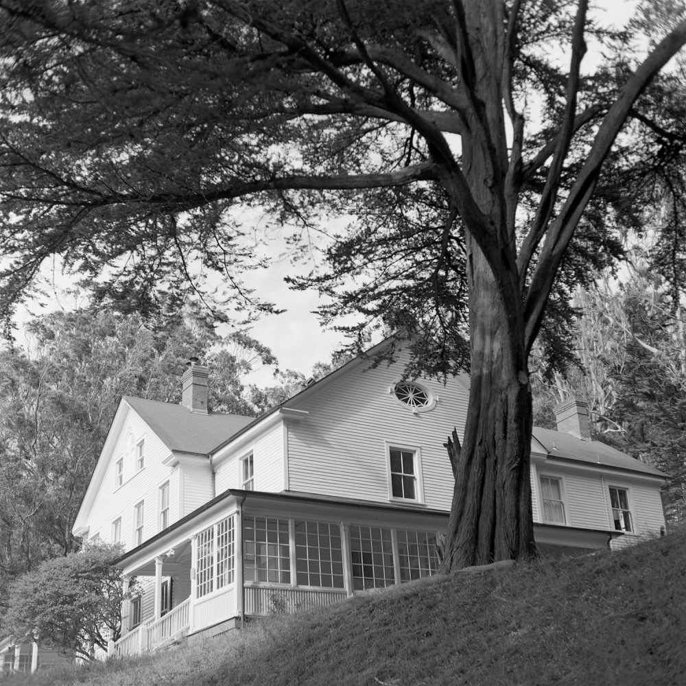

Here's an example of a subject I've photographed many times. This one is FP4+ but I've done this with both films:
There is plenty of shadow detail in the darkest areas, while the white house wall is not blown up, on both FP4+ and HP5+. If you see sections of the 100% pure black in the scan, that was intentional - there's detail in the negative.
But thanks for the response!
Nice shot. And how about the HP5+?
Thanks for posting the shot, Steven; and yes, that's a tonal range FP4 can easily handle, but not what I would personally classify as especially high contrast. Typical white paint is a lot less bright than many of the actual specular reflections I encounter where I still need textural differentiation. In fact, most weathered white house paints are only around 80% reflective, not even as bright as the soft fur on my white cat.
Similarly, your shadows in that picture contain quite a bit of fill light. So again, yes, FP4 is a good choice for most architectural photography, even outdoors. But due to get better shadow gradation, I routinely rate FP4 at 50. Doing so, the highlights rarely blow out with that kind of subject matter. Doing landscape work in the mountains or desert is a different story, where I really do need longer scale films.
I don't see anything "missing" in that example Steven. I like the composition.

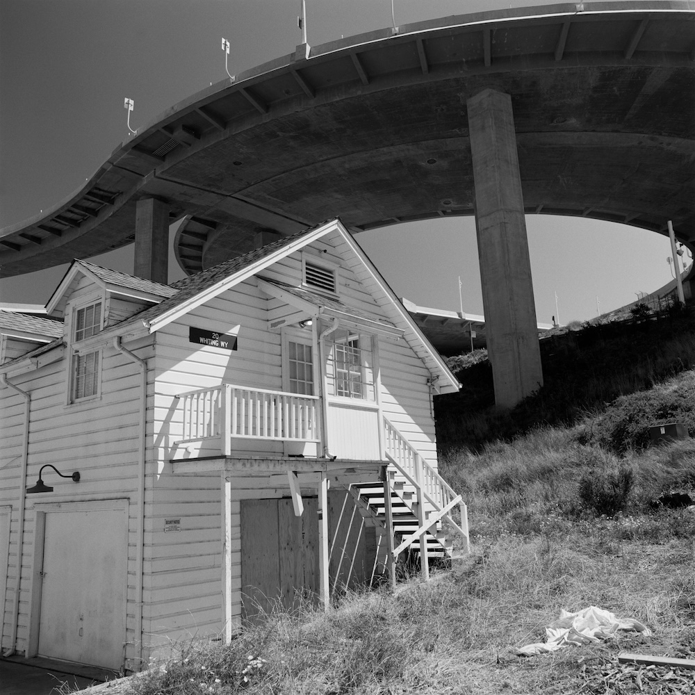

I don't have an HP5+ shot from exactly the same spot, but here's a similar light+subject shot nearby on HP5+ under the same light :
Same thing: the shadows and the white house siding have full detail. The 100% black areas are intentionally darkened after scanning.
