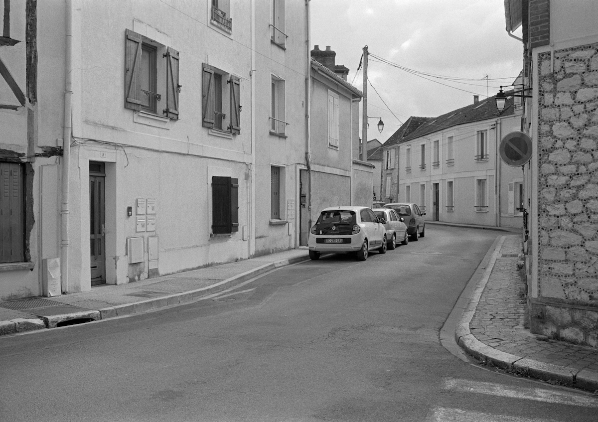

@DREW WILEY how about this one? It is the closest (to your description) image I could find in my HP5+ portfolio. Does this qualify as high contrast? I mean it's the harshest light possible at 1pm, snow+rocks, at 8k feet over Tahoe. The negative has full detail everywhere. Basically I can't imagine a situation where HP5 range won't be enough, but that's just my limited experience.

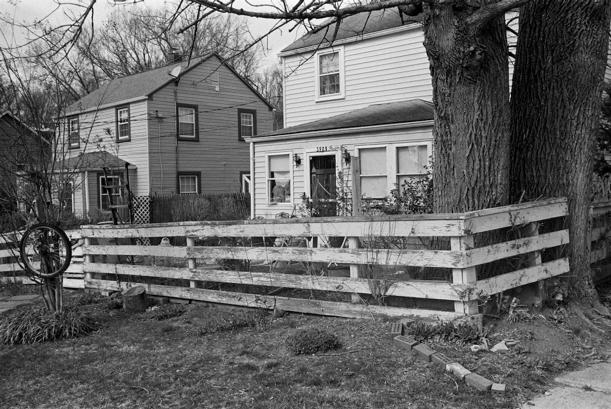

@pentaxuser here's from my last 35mm roll of HP5+
It is subtle, but that's why I love it. The same photo taken on TMax or Delta films would have looked quite different, more realistic and life-like.

As a resident of the UK, pentaxuser might think that that scene looks very realistic :smile:.
Similar to how our "wet coast" area looks in November light!
LOL. I see what you mean. Well, here's that same effect in a photo taken in the US (Virginia):
Well that about sums it up, Matt and not just on a November night. It just looks like a normal picture reflecting the light conditions as they were
