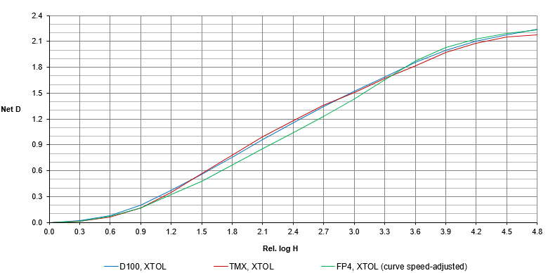

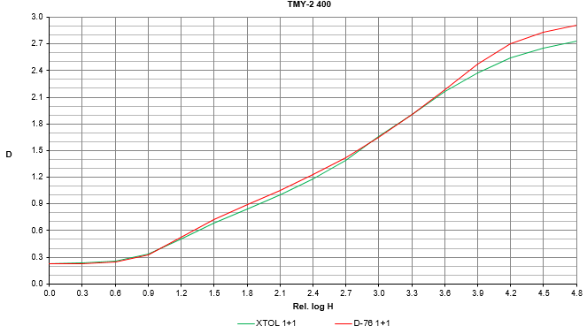

Thanks to Jonathan and Henning for bringing some data back into the discussion.
I am impressed with the measured FP4+ curve in D-76 : it hardly shoulders at all - much better than the curve on Ilford's own datasheet .. though this is labelled as being from Ilfotec HC.

As Lachlan Young pointed out far upthread, in many cases the tone reproduction only differs at the upper end of the exposure scale - useful to know for extreme contrast subjects, but quite a ways outside the luminance range of the average scene.
It can sometimes be informative to superimpose curves in order to evaluate the differences between films processed in a certain way. Here is one example for TMX, Delta 100 and FP4+:

A slight digression- look at the curves in Post 131, which are normalized to one stop per division on both axes. The nearly straight part of the curve is eleven stops long! We are truly spoiled by these modern films!
Lots of questionable generalizations. I don't know who came up with the finer the grain, the better the tonality, or whatever. How is that notion justified? Some of the finest grain films out there have miserable tonality; some of the grainiest films of former days had the best.
Second, good black and white transmission densitometers are not necessarily expensive. If you want a fancy programmable one, fine.
Now - curve structure. One has to factor in how much comprises the toe before the straight line portion launches off, no matter how long it is above that point. Otherwise, you're kidding yourself about real-world film speed. FP4 does indeed have a very long straight line with some developers. But it also have enough toe that I routinely shoot it at 50, not 100. Same with D100. And even then, it's hard to match the deep shadow gradation of TMax films at full box speed.
And if one has ever worked with old school "straight line" films like Super-XX or Bergger/Lotus 200, they understand the difference. FP4 is nowhere near in the same league when it comes to deep shadow rendition, even though it is an excellent general purpose film in my opinion. Yes, you can lower your effective film speed and get more of the scene up onto the straight line; but then if you do full development for optimal midtone expansion, the bolder DMax at the upper end might become unprintable on conventional silver projection papers. That's even more the case with HP5. I had to handle that kind of problem with supplemental masking.
Characteristic curves get altered not only via specific development method, but sometimes even by strong contrast filters. Deep blue filters are particularly notorious for skewing gamma in most pan films. Sometimes deep green can be a culprit. Just applying the correct filter factor does not remedy that. One more reason to own and use a densitometer.
I also take exception to anecdotal personal "evidence", like not having Newton ring problems with a particular film. Not everyone lives in the same kind of climate, or has the same kind of winter heating system in the darkroom. Here, I've tried at least 13 kinds of AN glass over the years; the right type is related to the angle of incidence of light in relation to the format size. What works best for large sheet film might not be ideal for small negative work. Unfortunately, there are only limited choices of glass today.
That's true, and some developers will produce even lengthier straight lines (in particular some PQ formulas such as Ilford DD-X or Kodak TMax).
Some films also tend to have higher highlight contrast which can further extend the exposure range. Below is TMY-2, for example. I would say the longest linear density range I've seen is Fuji Acros.
