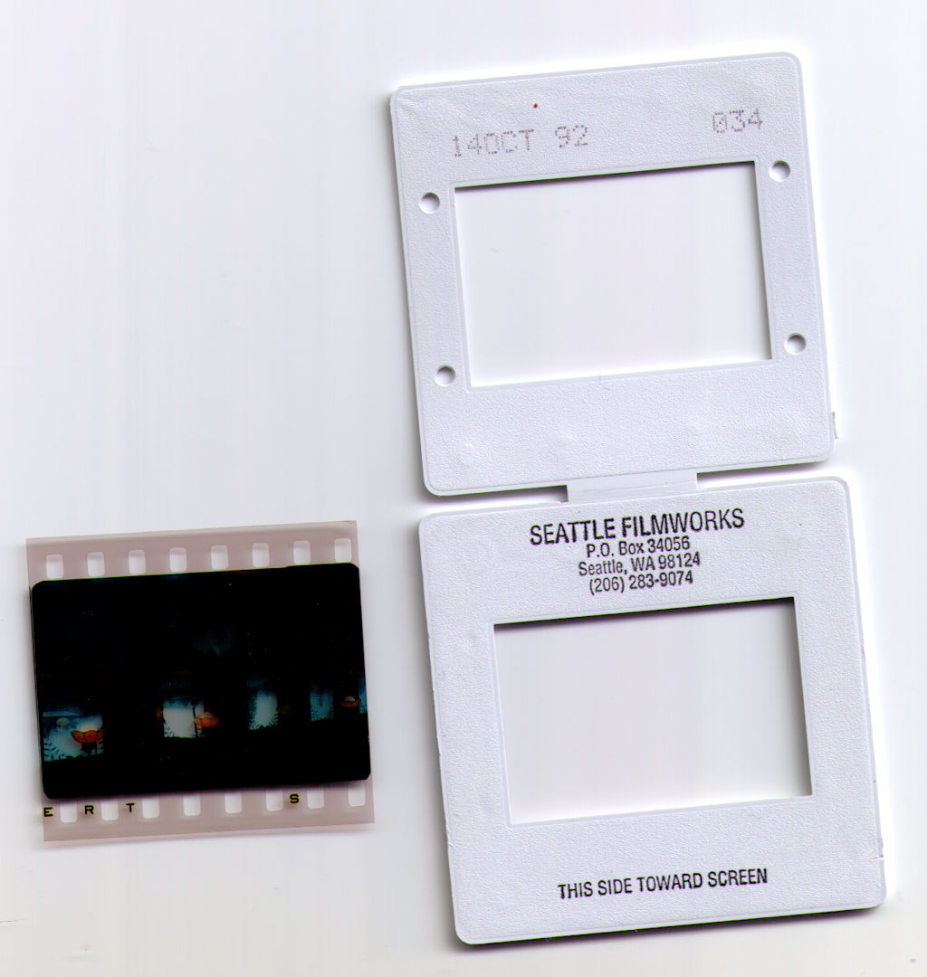

Here's what it looks like outside of the carrier:

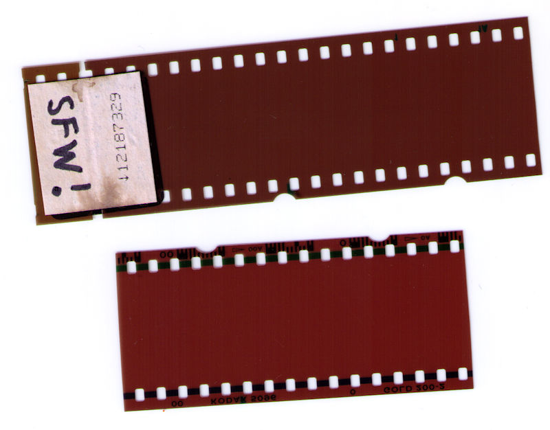

You can see the subtle difference in orange masking (comparing to Kodak Gold 200 of the same year):
It's impossible to tell from a flatbed scanner but the SFW negative lets more light through, with less orange overall.

In the photo of the slide film removed from its mount, the "ERT" printed along the film's edge indicates that these slides were printed on Agfa-Gevaert. They manufactured motion picture film up until around 1995.
