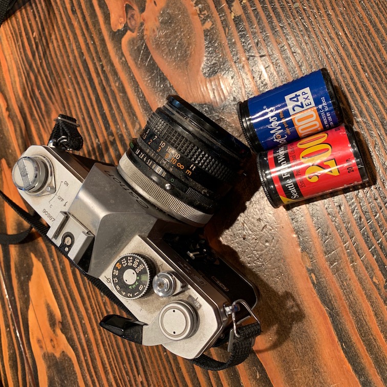

Hello. I just picked up a Canaon FTb QL, plus a few lenses and other bits at an estate sale. Included in the collection is a brand new roll of Seattle Film Works film. There is also film in the camera, which appears to be jammed - I can't get the the camera to rewind the film and there is an audible film crunching sound when I try to wind it.

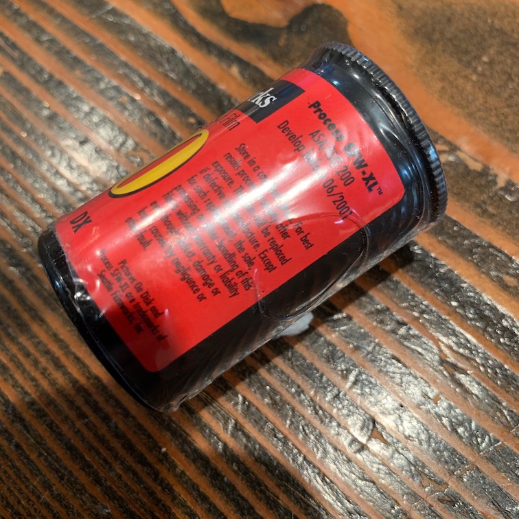

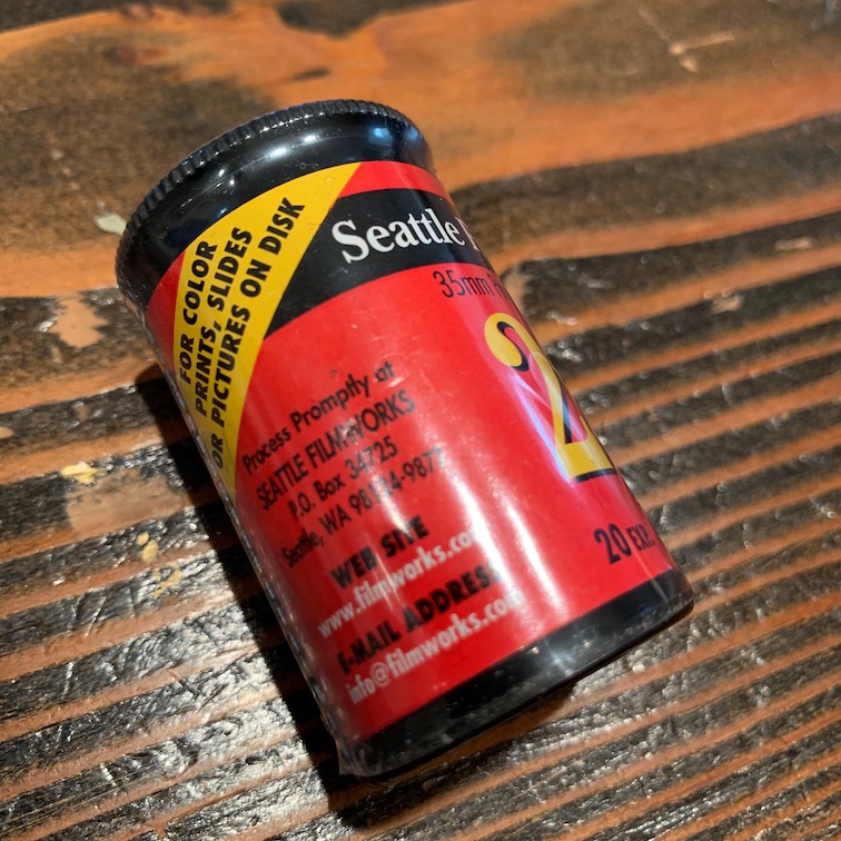

Can the Seattle Film Works film be used and devoloped? Use by 06/2001 dated.

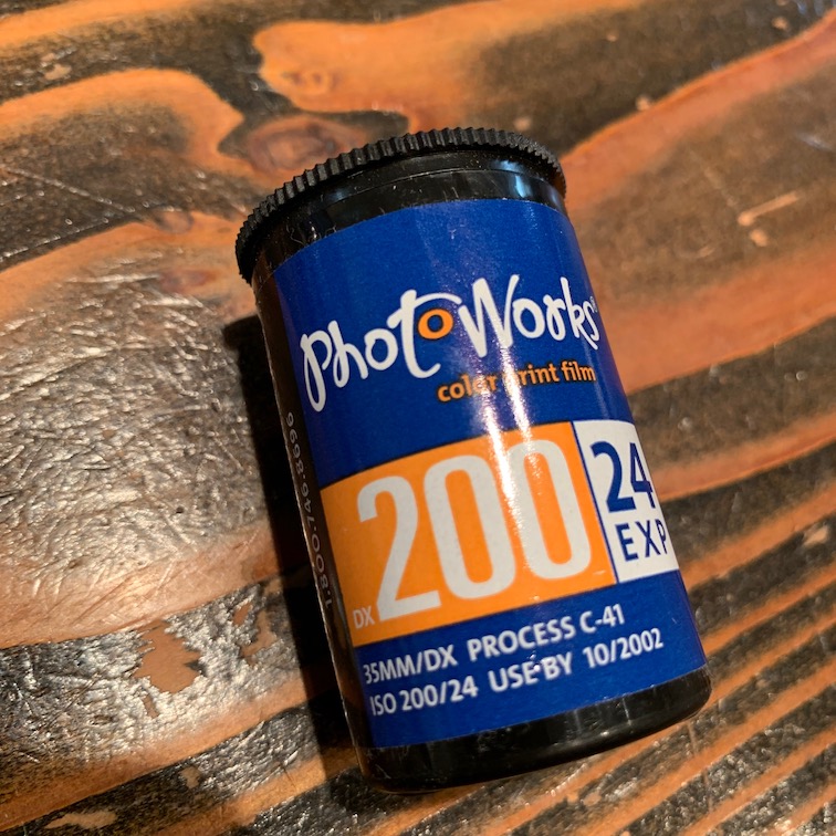

Can I get the film develpoed, in the camera. believe the film in the camera is a Photoworks color print film - based on the empty canister included in the sale. Use by 10/2002 date.
Thanks!

Welcome to Photrio.
With respect to the film, I wouldn't bother trying to get the Seattle Film works film developed. The "proper" process for that film isn't easily accessible for single rolls, and if you try to process it in more easily accessed services, it can end up messing up their machine.
The Photoworks film is a current process C41 film, but it won't be appreciated by any labs if the sprockets in the film are damaged.
With respect to rewinding the film, did you first push the rewind release button on the bottom of the camera?
You can obtain a copy of the instruction manual from Mike Butkus' site here: https://www.butkus.org/chinon/canon/canon_ftb/canon_ftb.htm - I'd suggest sending Mr. Butkus his requested donation, because the service he supplies is very valuable.
