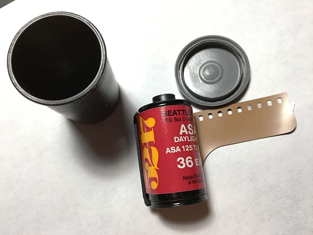

This very afternoon I was going through a supermarket sized bag of old plastic 35mm film canisters that took too much space. I had been saving them for a long time and decided, as part of some de-junkification to pare down the quantity by about 95%. As I got near the bottom of the bag, one canister felt as though it was not empty -- behold -- it contained a roll of SFW 5247 ISO 200!
Who knew? Apparently it missed its trashing a decade or so ago by hiding among the empties.

The interesting thing is that it gives the original Kodak designation of the film contained.
The only german version of such offer did the same.
