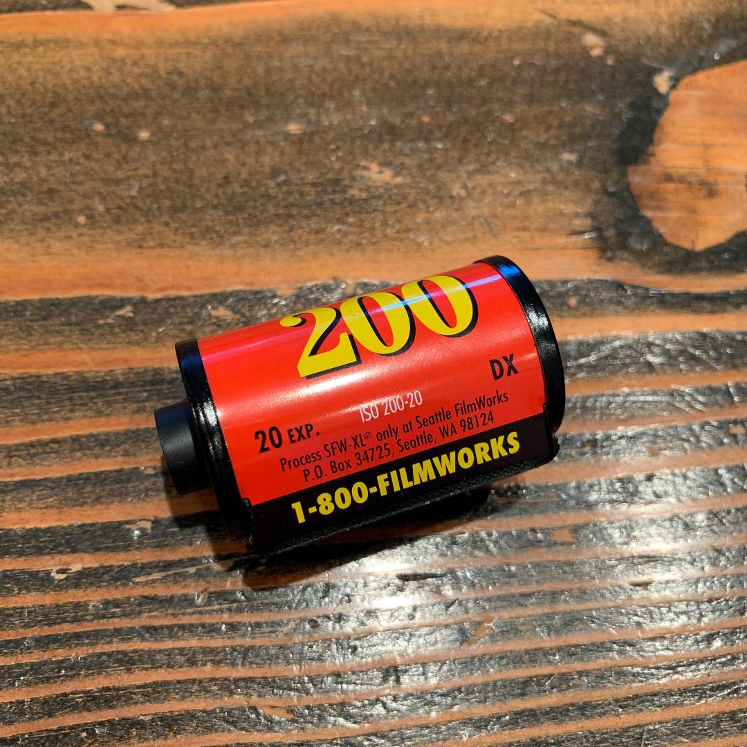

Thanks for the reply, MattKing.
A bit embarassing - I pushed the release button and rewound the film. It's been a really long time.... Thanks for the tip.
I just popped the film out and it is Seattle Film Works. I am very curious about what is on the film. Any chance of developing it somewhere?
Here is the canister -
The slides were actually printed on the projection stock used to distribute motion pictures and show them in theatres. The potential quality was good, but the longevity was poor. Most of the movie prints in those days were expected to last not much longer than a single theatre run.

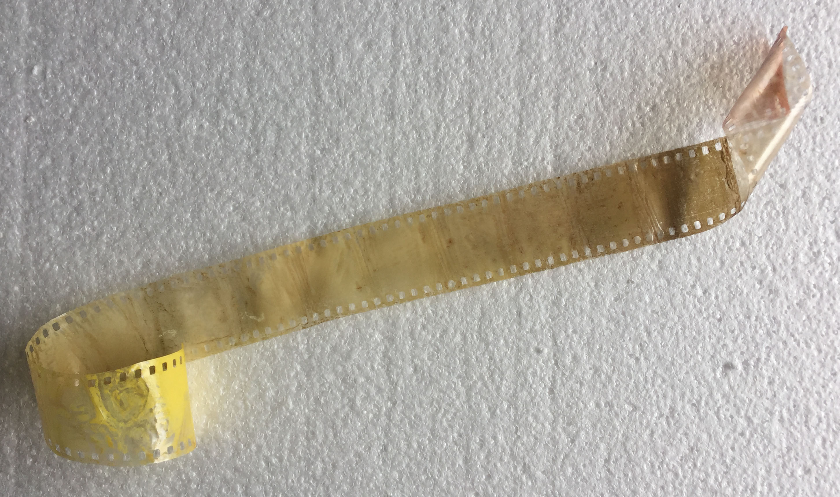

I am in the process of archiving my father's photos. He passed away a few years ago. We used to use this film (5247) all the time. I always felt it wasn't quite there though. So, if you are into lomography—this film should be a hit if you can find someone to process it. If you want better results, stick to name brands.
I came across about 10 rolls of it buried in a bag along with my dad's 1950's Kodak Retina. The reason I'm writing today is that as I was cutting up the negatives that he got back along with slides to put them in archival pages. On one roll, about the last 2 feet of it is decomposing. I thought that's weird. Turns out, it's still wet with fixer. This film was processed in 1985 and it's still wet and stinky!
This is so stinky with fixer, I bet you can smell it!
The acetate is completely limp and the emulsion has come off, it doesn't even have the orange negative masking, it's just clear. Feels like skin almost. Ewww. Into the trash and outside!
Are you sure it’s wet with fix or does it have Vinegar Syndrome? If it smells like vinegar then it’s VS and you should keep it away from other film, it’s contagious. This is a common degradation with movie film which is what Seattle Filmworks was rebranding. Improper storage like exposure to heat usually does this. Once it starts it can’t be stopped.
Sounds like Vinegar Syndrome to me.
The vinegar syndrom is not restricted to movie films, moreover most movie films cannot even develop it.
It can develop at all kinds of film with a base of acetic-acid ester.
It is dependant on storage conditions.
I do hear about it much more often with movie film and that’s my experience as well. Maybe it has to do with the film being wound tightly together like this roll was. Many people say that the film needs to be well ventilated to prevent it so they recommend not storing it in well sealed containers. Also don’t store it wound tightly together. For movie film loosely wound film in cardboard boxes is recommended.
Movie film is not movie film. Most movie film today is on PET base.
As I said it can only occur on films on acetic-acid ester base. Part of the mentioned storing conditions is the winding into a spool.
However films on such base can be affected by more trouble. Acetate-base is just not good chemically, still people cling to it.
