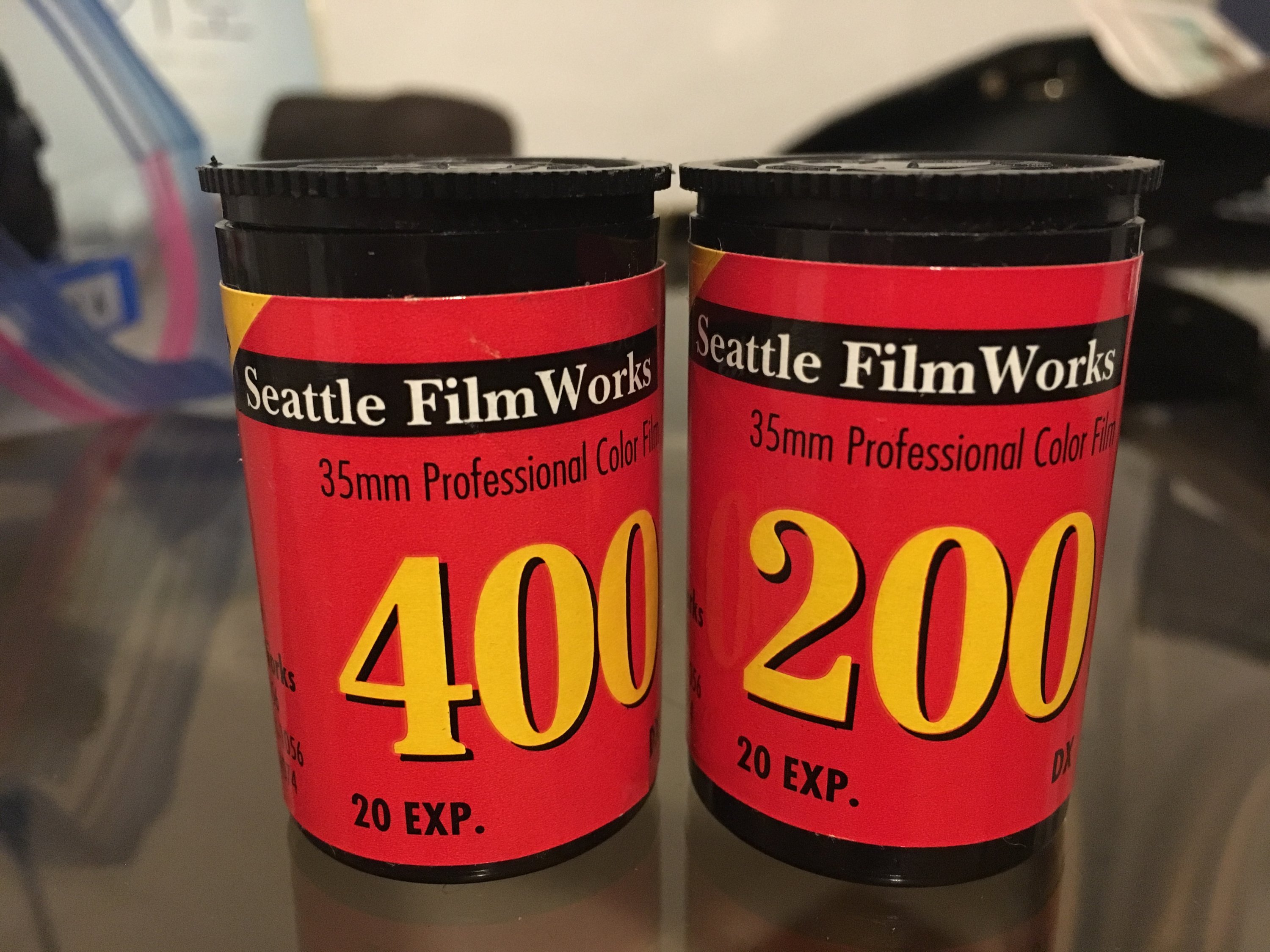

Within a box of used cameras that I had bought, there were two rolls of unused Seattle FilmWorks 200 & 400 film. I had never heard of this film brand, and apparently they went defunct in the early 2000s. In short, after being sued, they were forced to give something like 900,000 rolls of free film to customers over a one-year period.
It makes me wonder if these rolls of film that I have here are a few of those rolls that were given away. If they were, it may mean they are within 15-20 years of age and may be usable (if had been kept at a reasonable temperature).
Any of y’all heard of this film? Any chance any of you might know if this looks like the film they had given away during the early 2000s?
Thanks!
-Paul

It was always my understanding that they spooled 35mm color negative movie film into 20 exp cartridges for still cameras. After shooting, you returned the film to Seattle Film Works where they processed the film, made color prints and slides and returned these with an unexposed roll of film, all for a price. From what I saw, it proved to me that, once again, "you get what you pay for". Don't waste your money!. I never heard of them or anyone else "giving anything away".......Regards!

What you have there is most likely actually motion picture film spooled into 35mm cameras. The sort of film that commercial motion pictures were shot on, in large 35mm movie cameras.
It is/was designed for a different process than the standard (C-41 and before then C-22) still 35mm negative colour film of the day. The current version of that process is ECN - I can't remember whether the designation was the same back then.
It was lower contrast than the standard C-41/C-22 film.
Seattle Film Works' business model was that they would provide you with a free film. You would expose it and send it for developing by them. They would send you back your negatives, slides that were printed from those negatives, colour prints from those negatives, and another Seattle Film works film.
The slides were actually printed on the projection stock used to distribute motion pictures and show them in theatres. The potential quality was good, but the longevity was poor. Most of the movie prints in those days were expected to last not much longer than a single theatre run.
As the negatives were inherently low in contrast, the colour prints weren't wonderful, but they were often okay.

I never heard about the lawsuit, but there were a few companies that spooled Kodak motion picture negative, 5247 in particular, into 135 cassettes and did, as Arklatexian states— return slides, negs and prints with a replacement roll. I used a company in Hollywood and got good results. The slides were printed to Kodak mopic print film so they had the contrast and color of movies of the day. The film is probably quite unusable now.

I had a brief try of the Seattle stuff somewhere back in the last century. I was drawn by the promise of getting slides and prints in one pass. I vaguely remember having trouble coming up with a way to get good prints AND good slides. I couldn't seem to optimize both. Combine that with the PITA of shipping to the opposite coast for processing, and quality that seemed so-so, I gave up on it after a few tries. I think at one point they were sending multiple rolls out to lists of people saying "here, try it." I remember having a bunch of rolls sitting around for several years which I finally trashed.
In addition to a different process, I'm thinking it had the Remjet backing to so it would not lend itself to handy use even as B&W. (But I may be miss-remembering.)
Yep - and for that reason it was hated by the operators of "regular" labs.
All it would take is for one roll to get into their machines by mistake, and they would have to discard chemistry and do a meticulous cleaning of everything.

You can process it C-41 at 85 degrees F, higher temperatures reduce the contrast. There were at least 2 different brands of film being used. The process is/was SFW-XL. I think the film brand is on the cassette, one brand was an Italian motion picture film if I remember correctly. It dries with a heavy orange-magenta cast that may be removable while wet after processing.
I inherited some and have 6 rolls unopened with expiration of 2001 and 2002. Play with it if you like tinkering otherwise its Hi Ho, Hi Ho, its off to the trash it goes.
