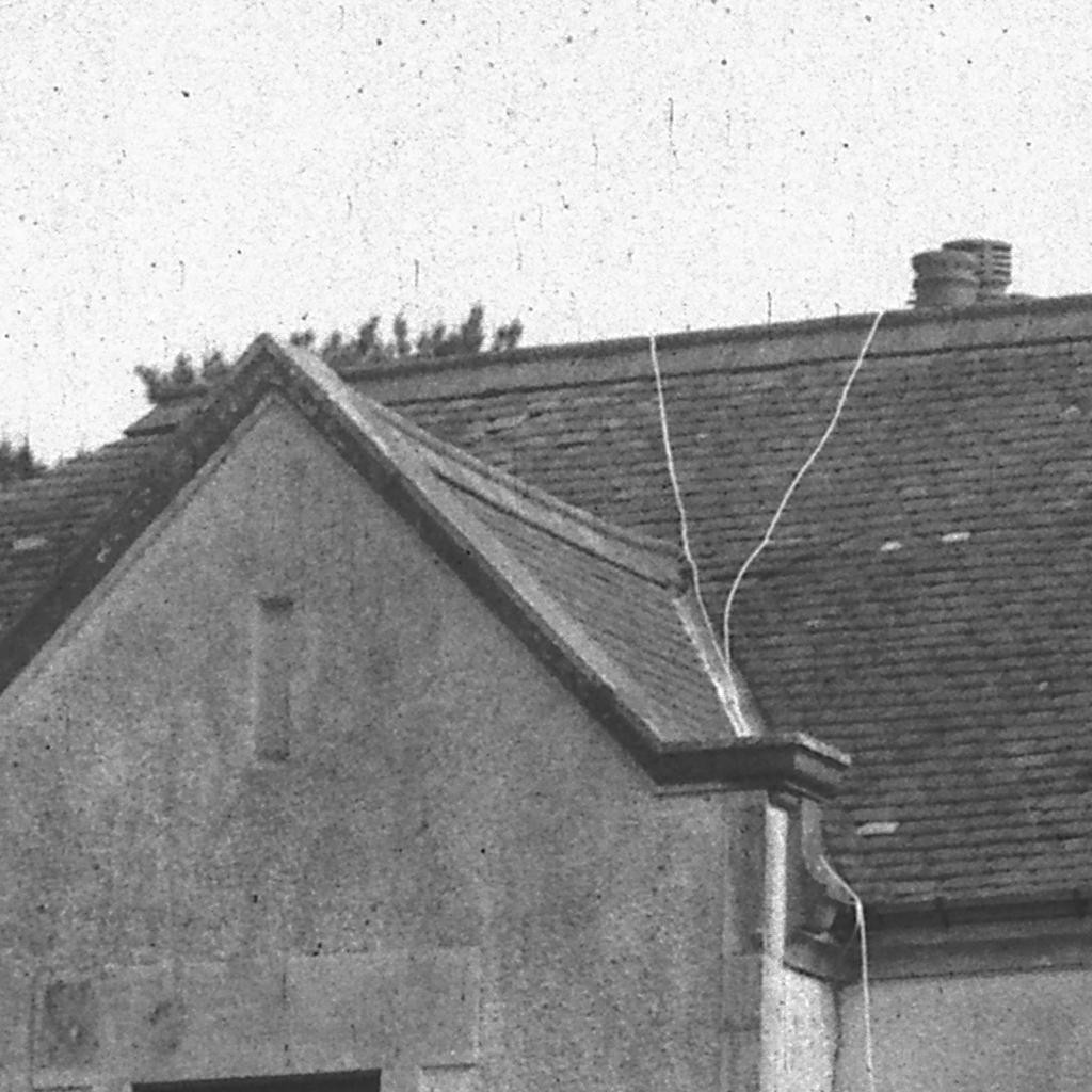

Apologies, I've only just seen this. My Fuji GA645, Pentax 645n and Fuji GW690III all give these results in my workflow on recent batches.

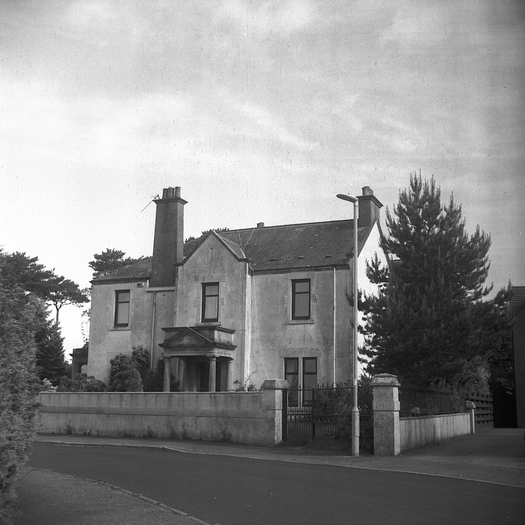

Another sample, same batch, different roll
Fomapan 200 in 120
Recent batch (013456-3 / 11.2024)
Self developed in D76 1+1
Water Bath
Fomafix 5' light inversions
AP tank, AP plastic reels with flaps
Foma Fotonal in distilled water, no squegee
Three attachments:
Scan from a 6x4.5 negative, resized
Detail 1 4000dpi
Detail 2 4000dpi
Linear inversion of the 16bit/channel raw positive produced by Vuescan, followed by standard monitor gamma correction. No edits, no software corrections apart from (own) choice of RGB channel to make gray, resizing of the full image and compression of the 16bit raw positive to 8bit jpeg.

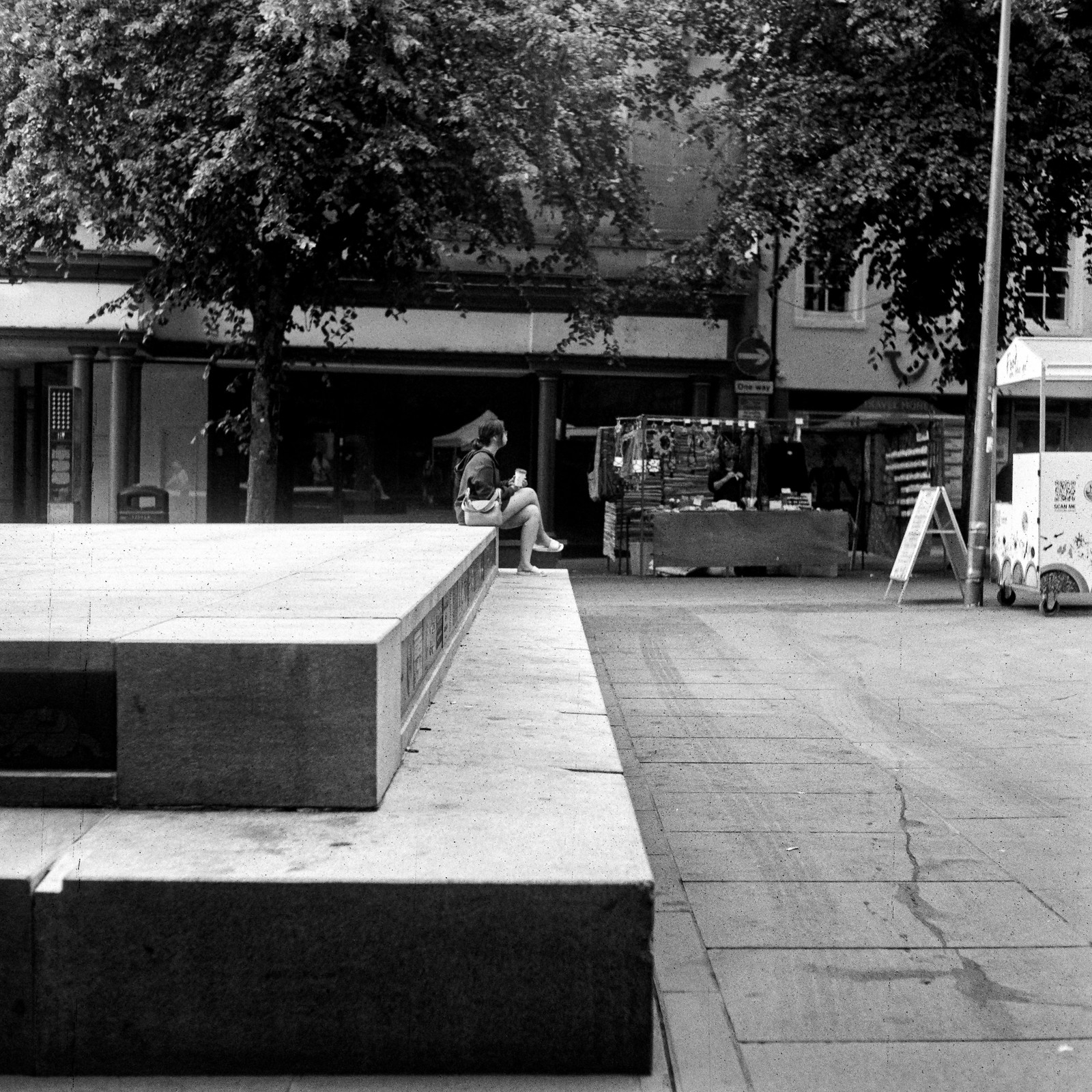

I've had the black spots on all the Foma 200 120 roll film I've used.
The film was from batches 013456 2 exp 09 2024 and 013456 3 exp 12 2024 and 2 TLRs and a folder were used. Developers used have been Caffenol and Microphen, fixers Tetenal Super Fix Plus and Zone EcoFix, prewash and water stop.
and a 100% crop

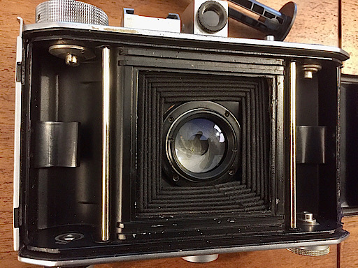

Whilst the TLR film path has a 90° bend (Rolleiflex Automat K4B2 and OlympusFlex B-II) the film path of my folder (Olympus Chrome Six) is about as straight as you can get and there's no difference.
