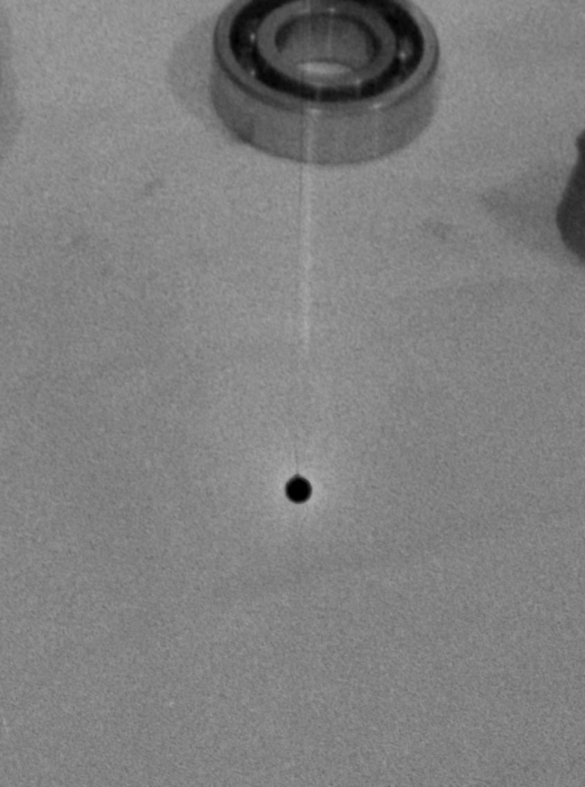

Pretty much the whole roll looks like this.
RO9 one shot 1:50 68c 8 minutes continuos rotation (Lab Box) (Fresh Bottle)
Eco-Pro clear Stop bath 1:32 2 minutes
Cinestill F96 Fixer 2 minutes
Bessa 46. Never seen anything like it with either Ilford or Kodak films in same camera.
Clarification: Never seen anything like it with D76. Could it be the acidic stop bath? Pinholes?
Any thoughts?
I've seen something similar every now and then on 200 & 400 (35mm & 120) but never quite as bad as that. That's awful. It's usually one spot (larger than in your example) with that telltale streak behind it in my experience.
It's as if something falls/drips onto the base before the emulsion is applied and repels it.
Reminds me a lot like when silicon spray accidentally gets onto surfaces that then get paint applied (DAMHIK).
I found an example of what I usually see. Not quite the same as yours.
This was on Foma 200, 35mm (100ft). There's a something like a serial no on the tin it came in "EM. 012515-04"

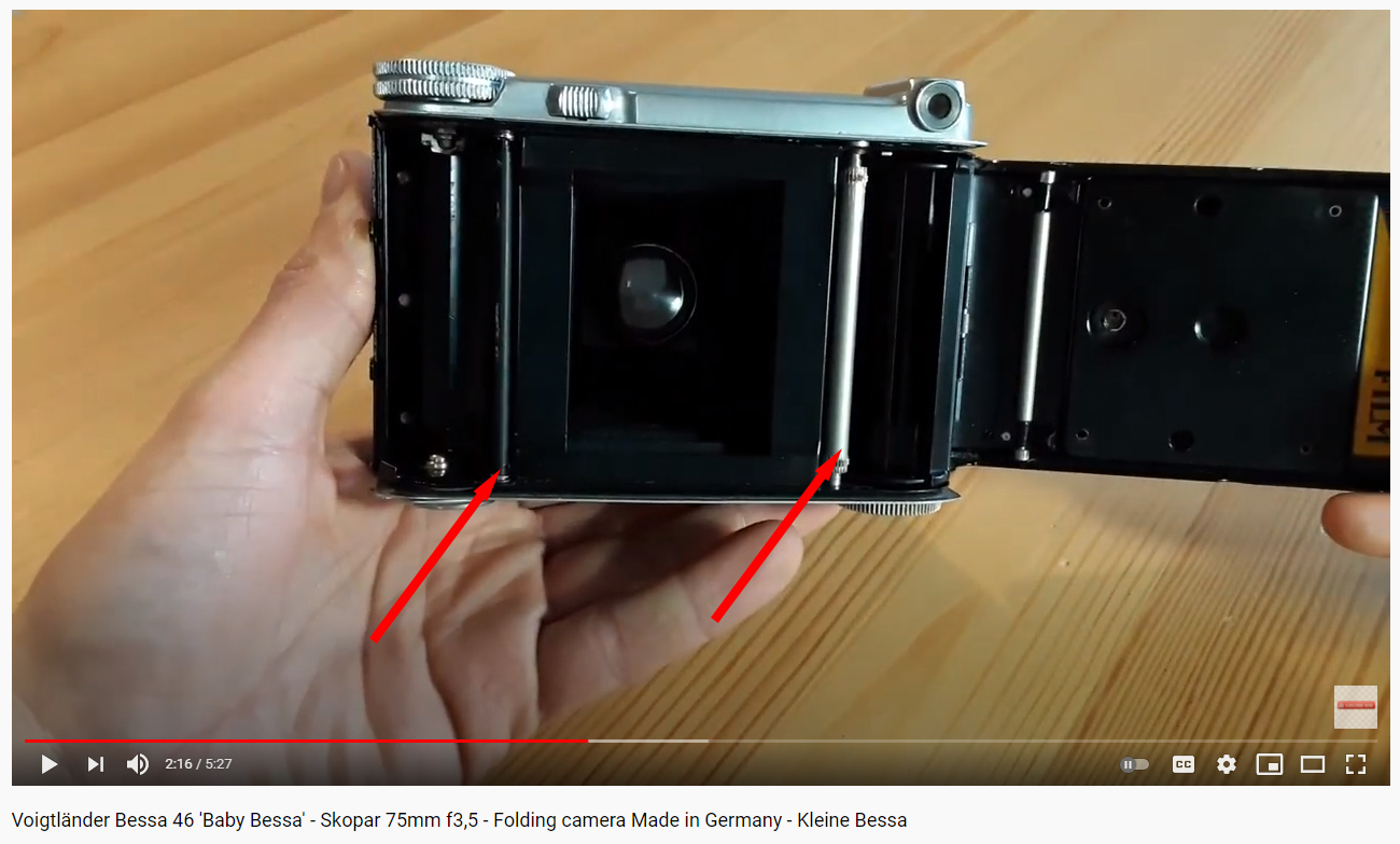

I've attached a marked up image of a Bessa 46 (from a video I found) showing the bearing surfaces that might be suspect - heavily hardened films tend not to care, but softer films like Fomapan can be surprisingly vulnerable to marking like this - I've seen similar marks quite often on vintage films from the 1950s, along with others which seem to relate to the film being over-tensioned in the camera. The other possible slight headache with Fomapan 200 specifically is that its flat-grain emulsion may make it more vulnerable to other defects caused by sharper break angles on the small transport rollers in 120 cameras - this was a big problem with the early T-grain technology. If the film & backing paper package is a little thicker than the Voigtländer was designed for, I could see the little roller inside the back door pushing the film into tighter contact with the larger right hand roller than intended, possibly causing marking etc. Now that I think about it, I recall having seen something similar with a Mamiya C330 and a not terribly well hardened film (possibly Shanghai) about 15 years ago, though I can't immediately put my hands on the material in question. I'd email Foma and ask their opinion too.
The "roller" on the back door is a ridge tube that holds a pin/axle that has tiny rollers at each end that engages the edges on the film so as to provide
enough pressure to make the larger roller underneath it turn over and engage the frame counter The large roller has knurled raised ends where the edge of the film rides.
Everything else is smooth and polished.(on my 46).
