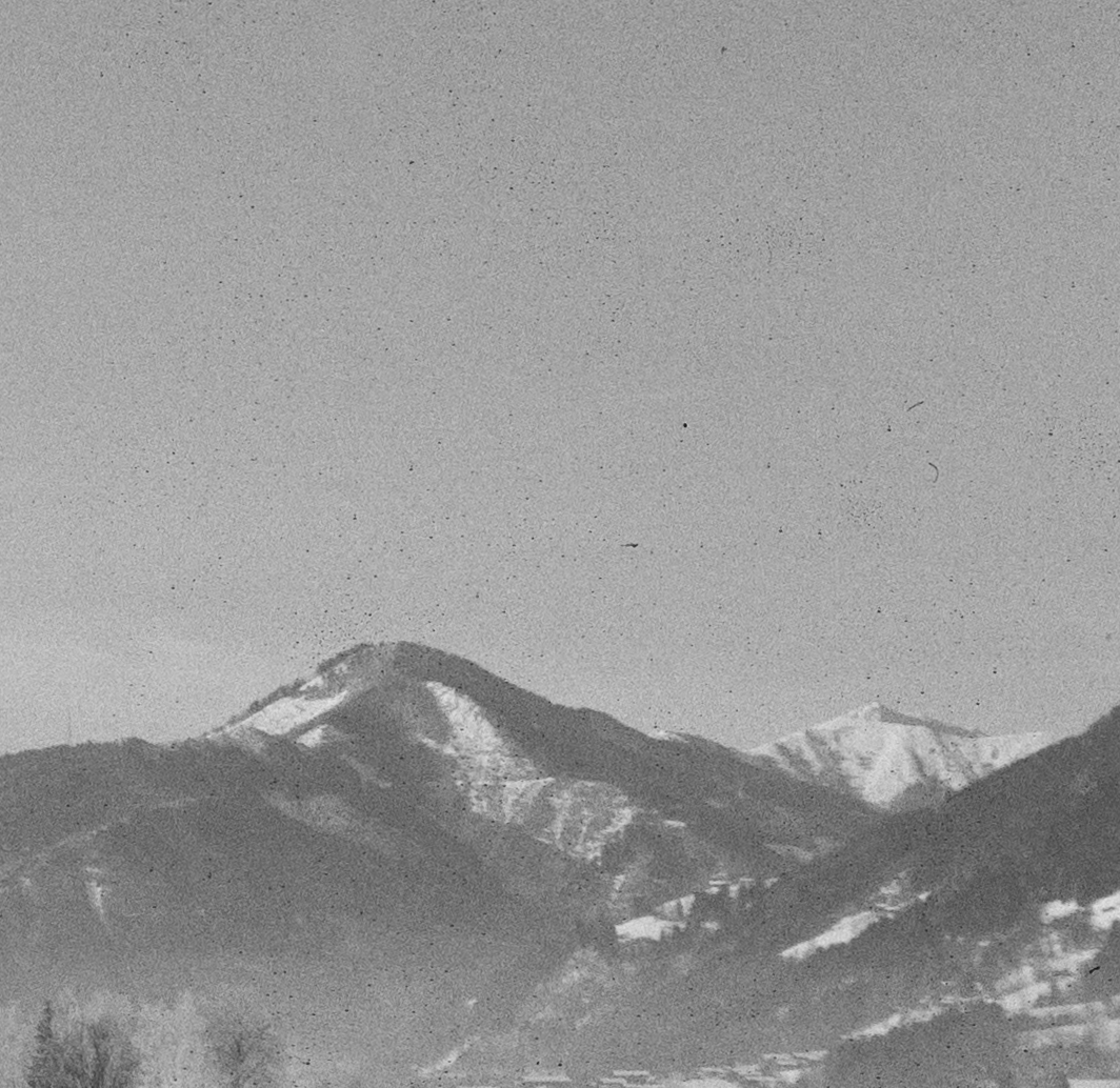

I have developed 2 rolls of Fomapan 200 in 120 with Xtol 1+1, one treated with indicator stop bath and one stopped with just water. The former shows defects like the black holes* in the sky in the right third your image. The latter has some black holes, but less. I did not see comet shaped defects like @Jonno85uk.
* I.e. very transparent in the negative.

If some scratches and zits are suitable for certain kinds of subject matter, why not just stomp on the film with a muddy boot instead? Steel wool? Actual shotgun holes? I wouldn't use any film like that if it was free. But maybe if one awakes from the gutter on Skid Row and sees something at the same eye level as a rat, no telling what kind of creative instincts might arrive.
Hahaha I get it :wink:
After using foma films since years I can only say that fomapan200 in 120 is unreliable for mentioned reasons.
In 135 it's great, sheetfilm too.
EI 100 is more like it though.. which is ok for me.

at the risk of getting that one who is now on the ignore list to drone on, @distributed that was a crop on 35mm.
I've shot dozens of rolls of 200+400 and for the handful of frames with these singular spots i'm not too concerned. I like the results I get with the film in xtol (above was HC). If I could get neopan400pr again, i'd only shoot that.

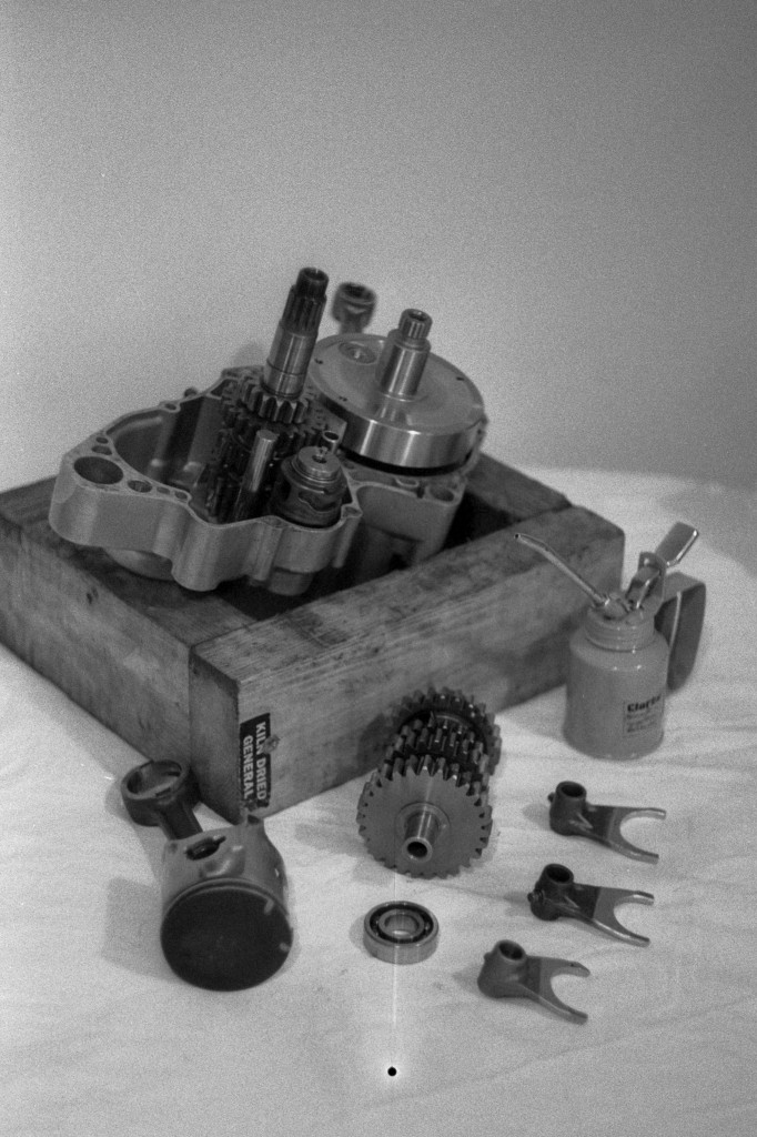

Pretty much the whole roll looks like this.
RO9 one shot 1:50 68c 8 minutes continuos rotation (Lab Box) (Fresh Bottle)
Eco-Pro clear Stop bath 1:32 2 minutes
Cinestill F96 Fixer 2 minutes
Bessa 46. Never seen anything like it with either Ilford or Kodak films in same camera.
Clarification: Never seen anything like it with D76. Could it be the acidic stop bath? Pinholes?
Any thoughts?
