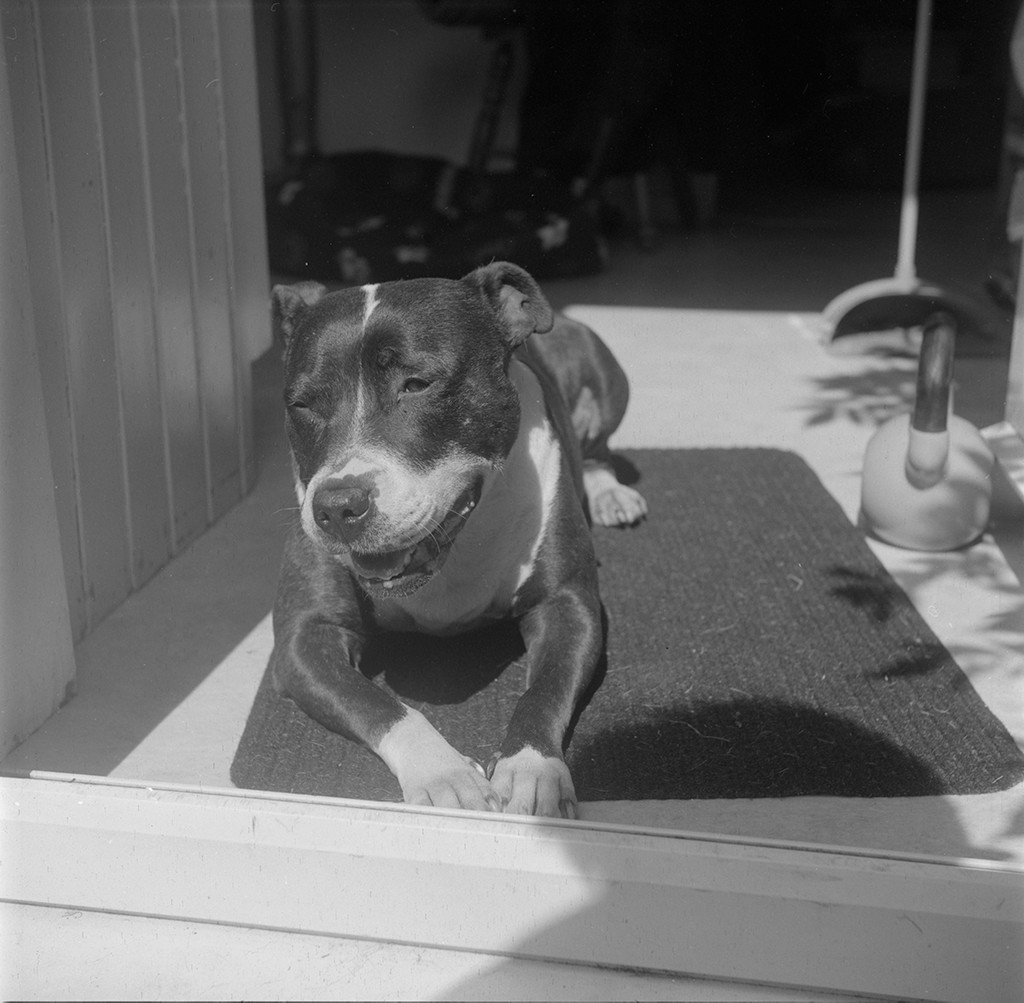

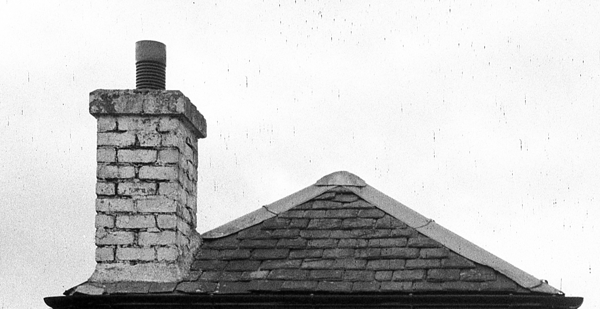

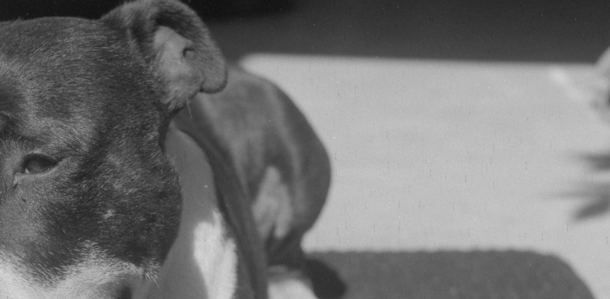

Ok. So after the recent "i'm done with Fompan" thread I decided to finally get round to trying Fomapan 200 in 120 one last time. This time in my Walzflex TLR instead of my ETRS.
Yeah...Not much better this time.
No presoak. 8.5mins in XTOL-R. 1min water stop. 3mins rapid fix. 4 changes of water + deionised water wash. Emulsion not touched at any point. Just left to hang-dry.
Film batch #: 012856 1
I have seen something like that before on a Fomapan film. It's too bad. That's a really cool photograph!
