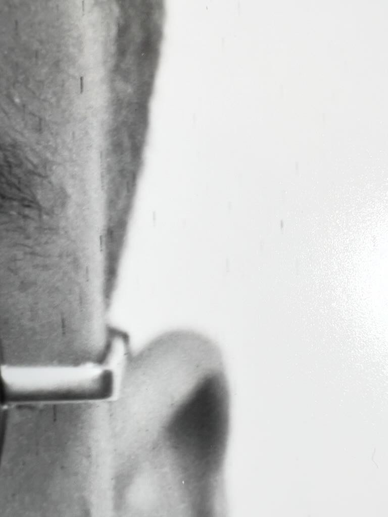

Did they look like these:
No. I had long linear lines nearly the full width of the film, and always a distinct direction parallel to the long edge. So there is no way I could have done it. But one would expect different symptoms on thick sheet film versus roll film, even if the underlying cause was similar. Plus I had distinct "zits" of missing sensitized emulsion - not craters like one might expect using too strong a stop bath - just nothing photosensitive there, up to a mm or so across in random places. That was less common than the crack or scratch marks. Pretty disappointing. I figured that, even with headache print retouching, only about one out of every three exposures was usable - it sure didn't turn out to be an "affordable" film in that respect !
