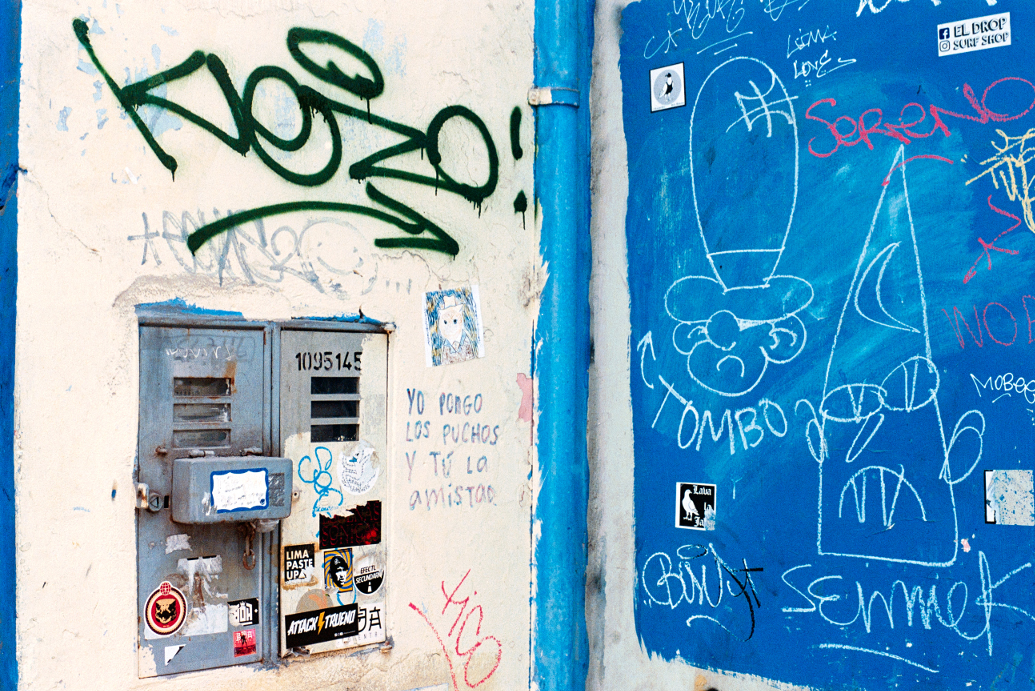

Now i will show an example of a DSLR scan with no oversharpening.
Full image (downscaled).
No scanning artifacts visible.

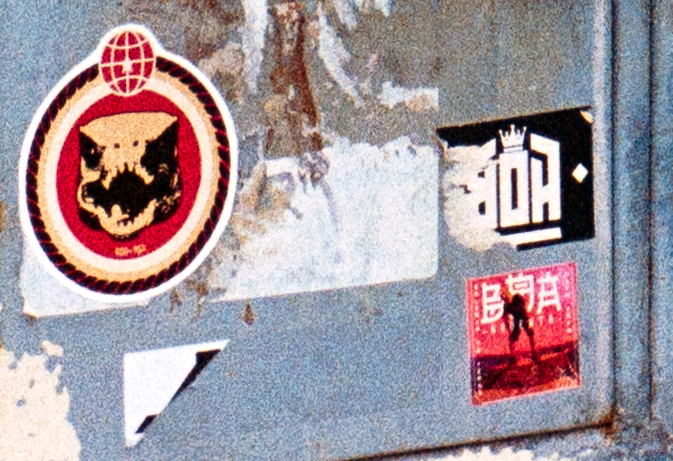

100% crop of the full-res image. You can check out how the grain (dye clouds) resolved -without being artificially pronounced on the downsampled image- and, again, there's no oversharpening on the image. Every fine detail is resolved.

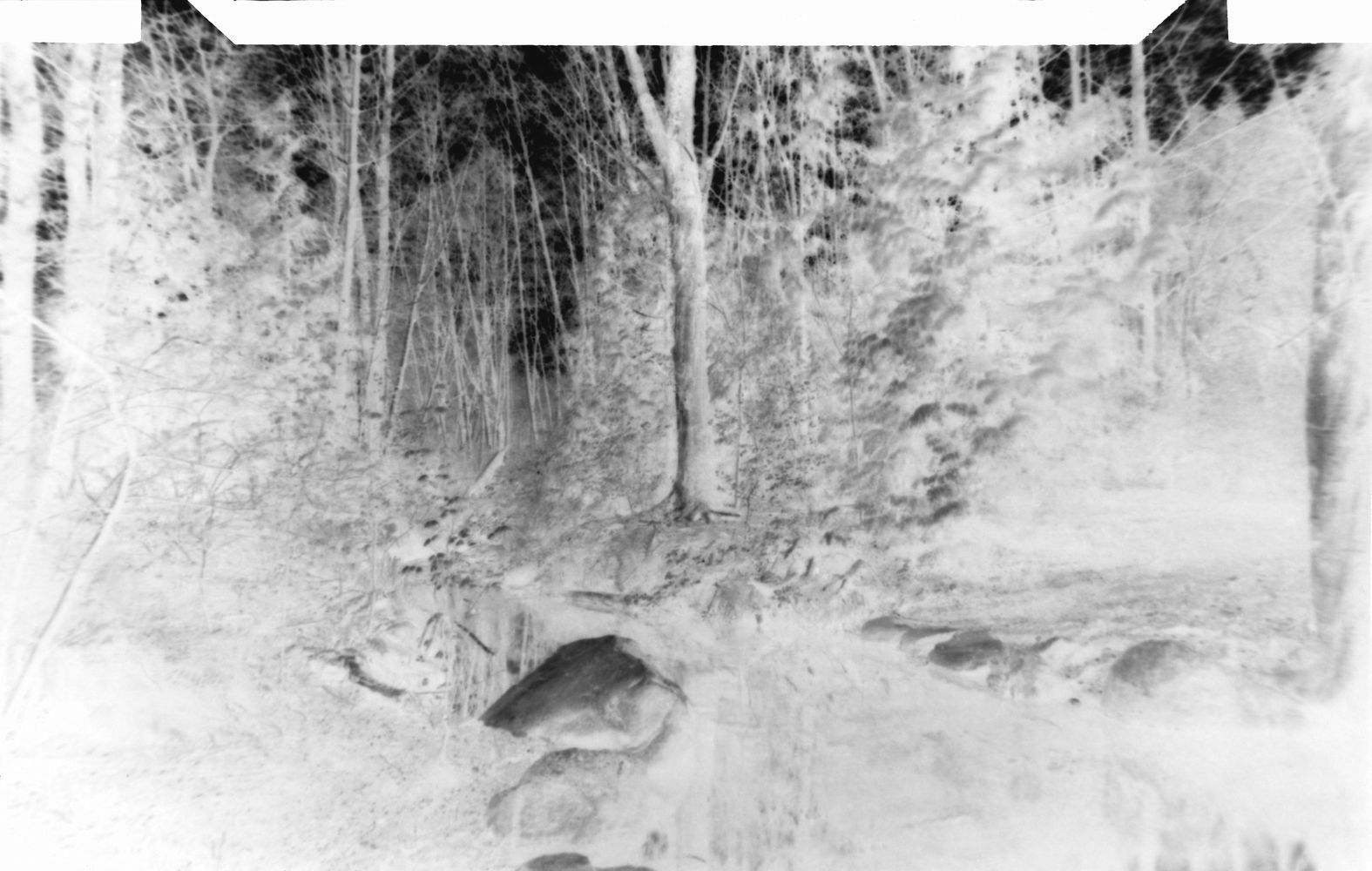

Digital sharpening changes the image, based on statistical data and relatively reliable algorithms.
It doesn't reveal detail that is hard to see but otherwise there. It interprets what is there, and adds more based on statistical assumptions.
It certainly makes a lot of scans look better. But it can make the file a less accurate copy of the original.
Here is a scan of a pinhole negative, with relatively little sharpening - it looks reasonably similar to the negative.

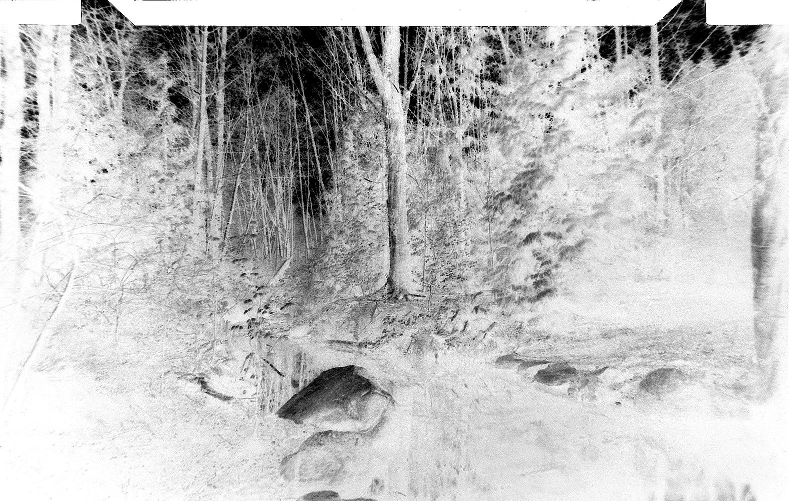

And here is a sharpened image of the same digital file, with a little bit of contrast tweaking.

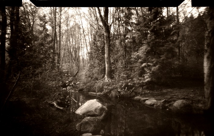

And finally, here is a nice and pretty positive of the scan, sharpened and adjusted to taste.
A carefully made darkroom print will usually appear less "sharp" than the last version, although unsharp masking techniques can be used to add apparent sharpness.
But in all cases, sharpening adds something that isn't already there.
