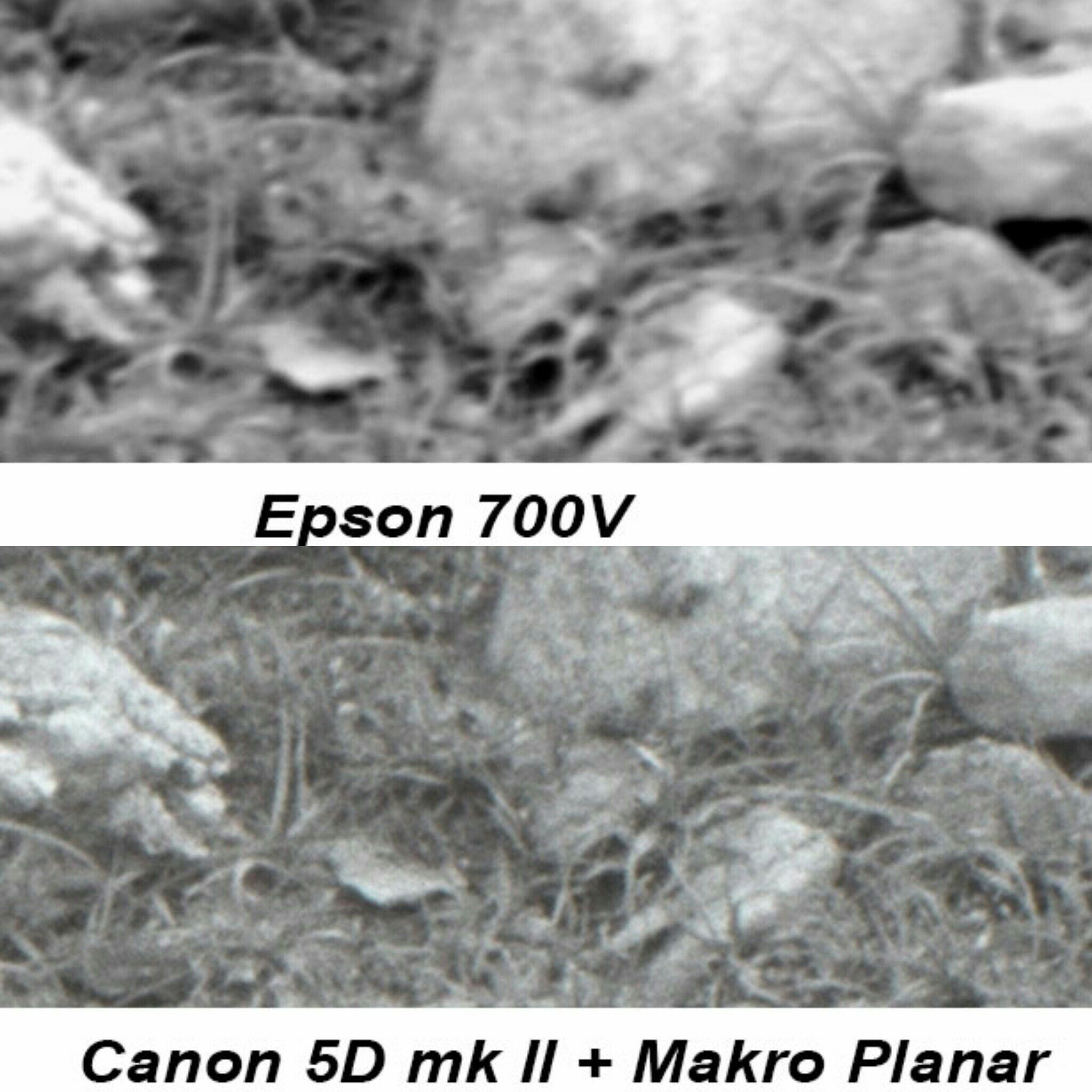

A 36mpx digital camera like the Sony A7R with a good macro lens can extract a good 7360 x 4912 image. This represents over 5100dpi.
No. 4912px over the 56mm of a 120 frame width is barely 2200 dpi if doing single capture scan. You can do multi capture if you want more resolution, but that introduces a lot of other variables and introduces way more time to get to a usable image. 2200 dpi is very easily within what a v850 can do.

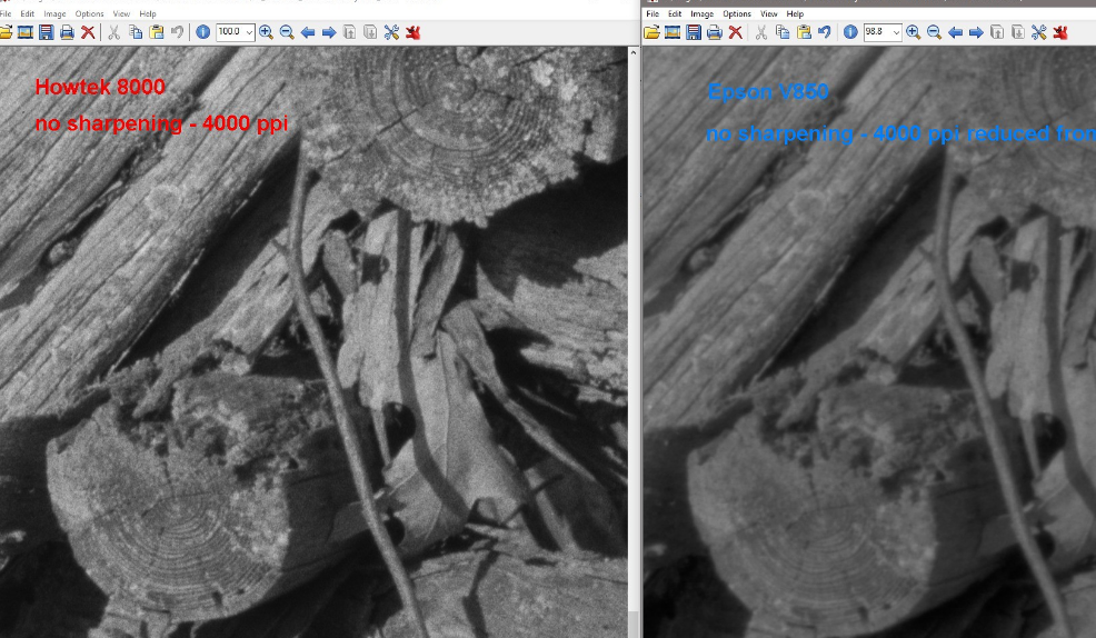

Because, as I've said above and as you can find out in the internet if you do the research, your scanner doesn't have more than about 2700 real, true DPI. That's why your "6400dpi" scan won't look much better than "the 3200ppi" version.
Now, run the very same frame (assuming it's a sharp frame) through a really high quality dedicated scanner like a top Nikon scanner, and you'll see all the detail you've been missing.
Just a simple illustrative example -- although you'll find plenty on the web.
Epson V700 -- tested to reach about 2400dpi maximum. The V850 doesn't improve too much over this figure, even if using glass carriers and adjusting height.
No research on the internet is required. I have an Epson v850 Pro (which is not a v700) and a glass etched 1951 USAF test chart and have tested it extensively. If my memory serves correctly, I even have some threads here on Photrio with some of the gathered performance data.
I also have a dedicated 45 MP digital camera with a very high resolution macro lens and process and scan many hundreds of rolls of film every month, so I’m speaking from experience and not speculating about the performance of the two platforms.
Yes. Do you see anyone disputing that V850 can do 2200dpi?
Question is, can you show it resolving 6400dpi?
Some people here obviously think Epson V850 can resolve 6400dpi. Others know it can't.
My issue isn’t that, but that many poo poo the v850 and play down it’s performance, when based on my own experience of actually owning and regularly using one, if used optimally, it tends to perform quite a bit better than what many on the internet give it credit for. 6400dpi? No, but for black and white material, quite a bit better than it’s usually given credit for, again, if used optimally to get the best out of it. Combine that with some intelligent application of sharpening to boost the contrast of the lower contrast finer details and it gives quite good results.
Epson V850 is given credit of up to 2800-3000dpi. Can you, please, show us how much better it is than that? I understand you have a good resolution target and a V850, many here don't have both or either so I'm sure we would all appreciate it.
You can try to counteract this MTF loss by applying sharpening but this will also increase noise and add more artifacts, which give a peculiar, grungy look to the image. As any information engineer knows, "garbage in -> garbage out", you can't fully compensate for bad quality data.
So, what does this mean? Yes, for a small 8x10" you only need 2400dpi on your scan (with a 35mm frame). Yet the very same print, done with a better scanner, like a dedicated scanner, would give a print with much better "clarity" or "fidelity".
This is my point. It's true that the Epson flatbeds are good enough for many purposes. But a better scanner will give better results EVEN in downsized images, and EVEN when the print is not up to the big scale where the maximum resolution is used.
There are other members on this same thread that are claiming less than that. I suppose I can go generate performance data and post it if I haven’t already done so in another thread.
