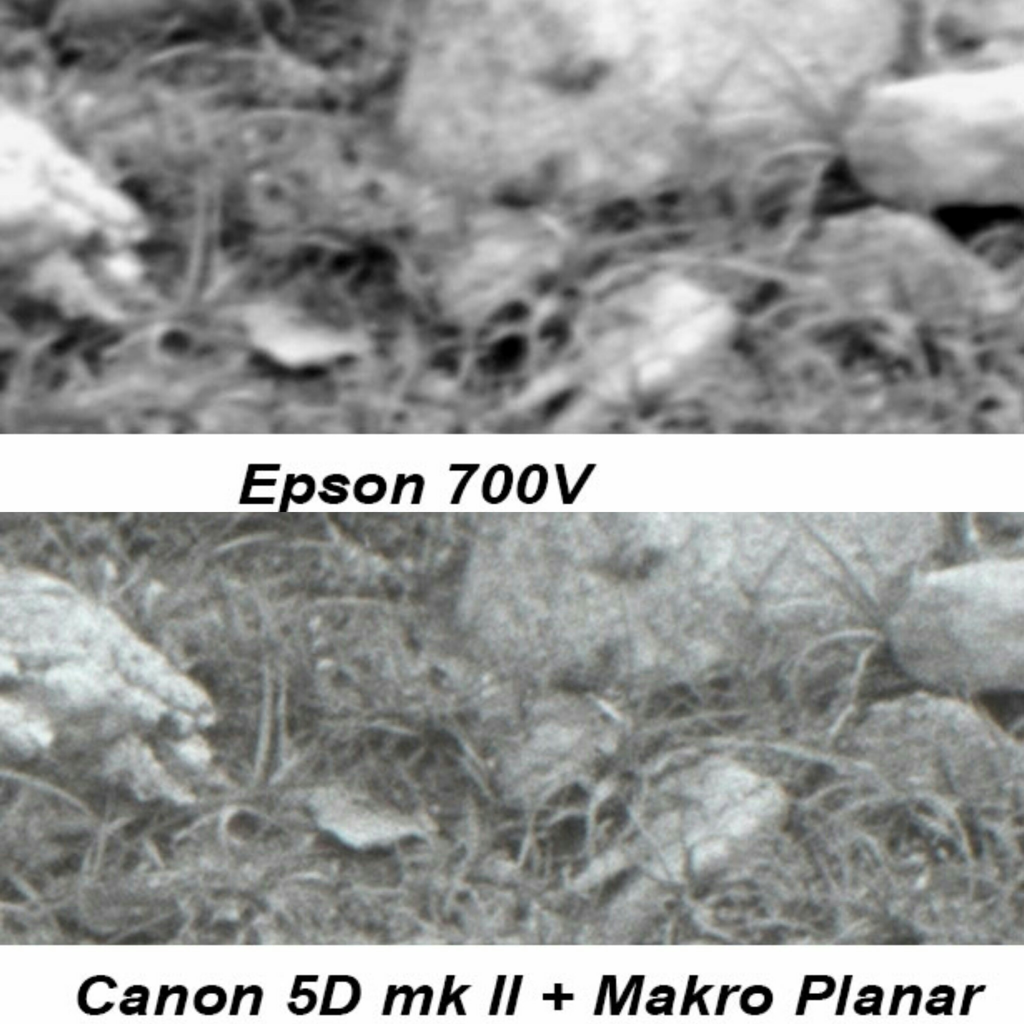

even high resolution full frame DSLRs are just starting to touch 2400-3200 DPI resolution, which is still well within what something like an Epson V850 can deliver in terms of raw resolution,
You'll need to be very very careful (i.e. play a lot of time with height adjustment and/or glass holders) to get real 2700dpi out of the Epson V850, and even then, it would be "smeary" resolution, with little clarity.
A 36mpx digital camera like the Sony A7R with a good macro lens can extract a good 7360 x 4912 image. This represents over 5100dpi.
Not really. The real problem is that 135 film doesn't really support more than about 3600 PPI anyway. I've got at least one 6400 PPI scan, which while it looks perfectly "OK", it doesn't look that much better than the 3200 PPI version.
While they vary wildly in resolution and pixel density, I'm don't think these qualify as "smeary" with "little clarity".

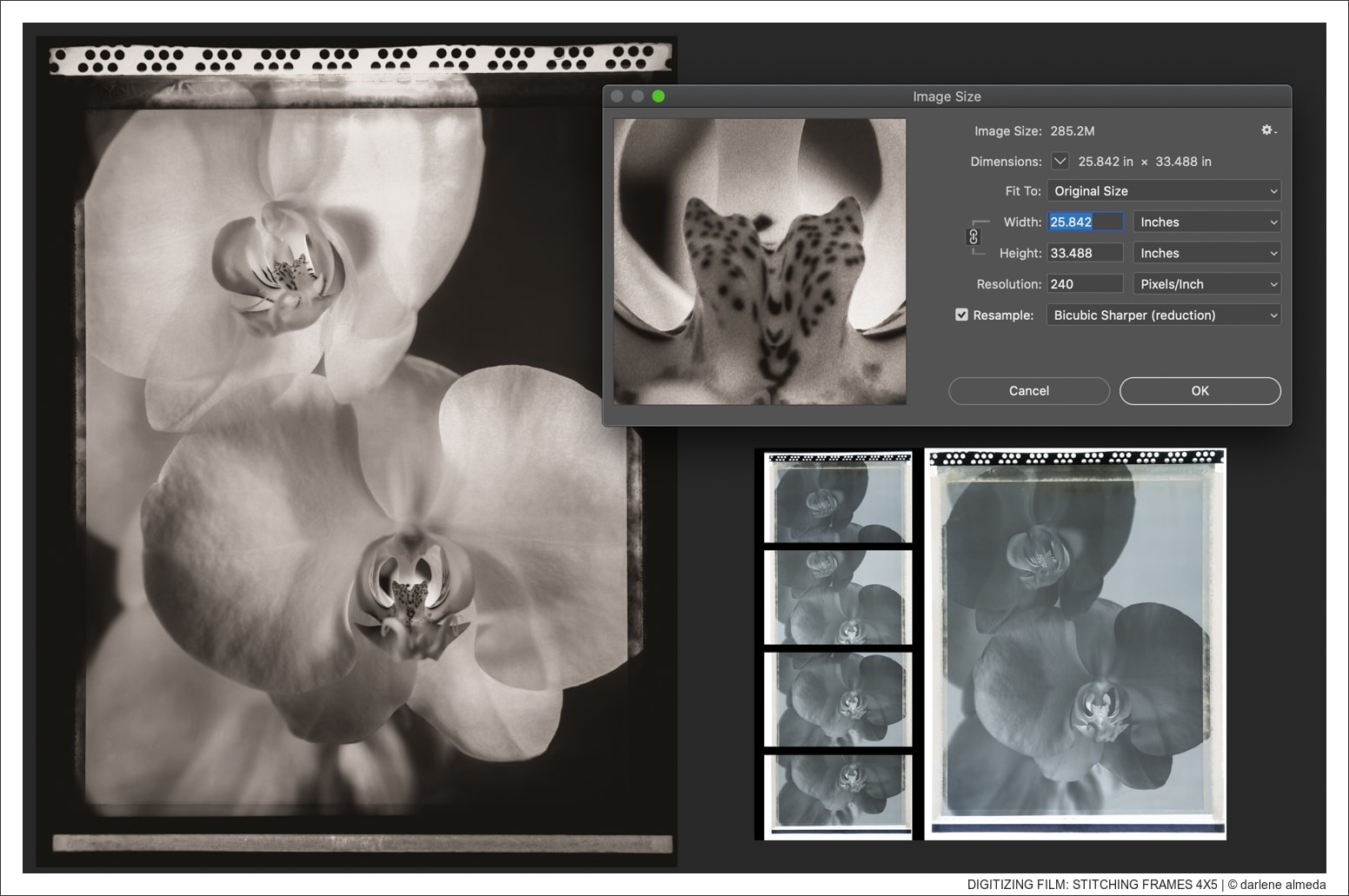

For 35mm, yes. For 4x5, in one shot, it's about 6140x4912, or about 1228 PPI. For a 6x6 image, you'll get about 2183 PPI, for a 4912x4912 image.
For a 4x5 image, at a "mere" 3200 PPI (easily done with an Epson v800), the final image is 14,966x11,776 (176.2MP).
You can do that with a DSLR, but you're probably looking at 6 frames stitched together, possibly more (It's late, and I don't feel like doing the math).

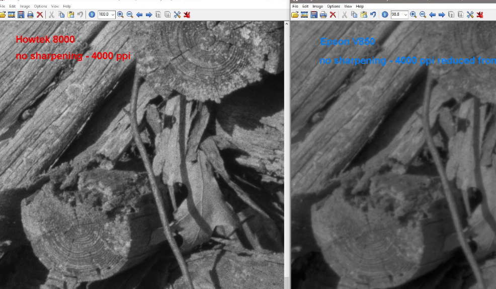

Here's a comparison between an Epson V850 and Howtek 8000 drum. scans The results compare favorably after sharpening the Epson scan.
Thanks, you're supporting and demostrating my previous claim about the smearing of details by the Epson scanner -- it's completely evident on the link you're supplying. It demonstrates the clarity and the fidelity of the drum scan, which represents the real detail on the negative.
So, thanks, here's the comparison from the link you've provided. It's evident how the Epson output is smeared. Yes you can add sharpening, here it works because the image, being large format, is devoid of grain problems. Try the same scan, on a 35mm frame, add sharpening to the Epson output and the difference would be dramatic.

You;re comparing to the V850 without sharpening. Here's after sharpening. (Epson on the right) Who can tell the difference to the Howtek drum?
Screen shot compares scanners at 100 percent after sharpening by Alan Klein, on Flickr

When I got my V850, I tested the sharpness at each of the five different heights you can select on the film holder. I was surprised that there is a noticeable difference in sharpness between the best position and the ones immediately adjacent to it. Everyone should check this out on their machine to verify the best position and mark it for future use.
Regarding 35mm, I suppose the v850 cannot provide sharpening as good as a drum scanner. But it does a pretty good job certainly acceptable for the web. Here's 35mm with Tmax 400.
@Alan Edward Klein Effectiveness of sharpening depends on subject matter. The wood texture apparently is a better subject than skin imperfections in Flavio's sample. For this reasons scanning devices must be compared with sharpening turned completely off.
There's another variable not being discussed: appearance of grain. It is a much higher bar to reach. Because even at smallish sizes the grain quality impacts the appearance of an image. Scanning is tough on grain. It either gets smeared or exaggerated, and there's an inverse correlation between grain quality and sharpening. For this reason I am in a "minimal sharpening while scanning" camp.
Yes, I can see the difference, moreover if you click on the link and see the above mage at full size.
And, as I hinted above, here due to the film being large format, the impact of grain will be minimal. But apply sharpening to a 35mm frame or 6x6 frame scanned with drum scan vs V850 and the difference will be dramatic.
