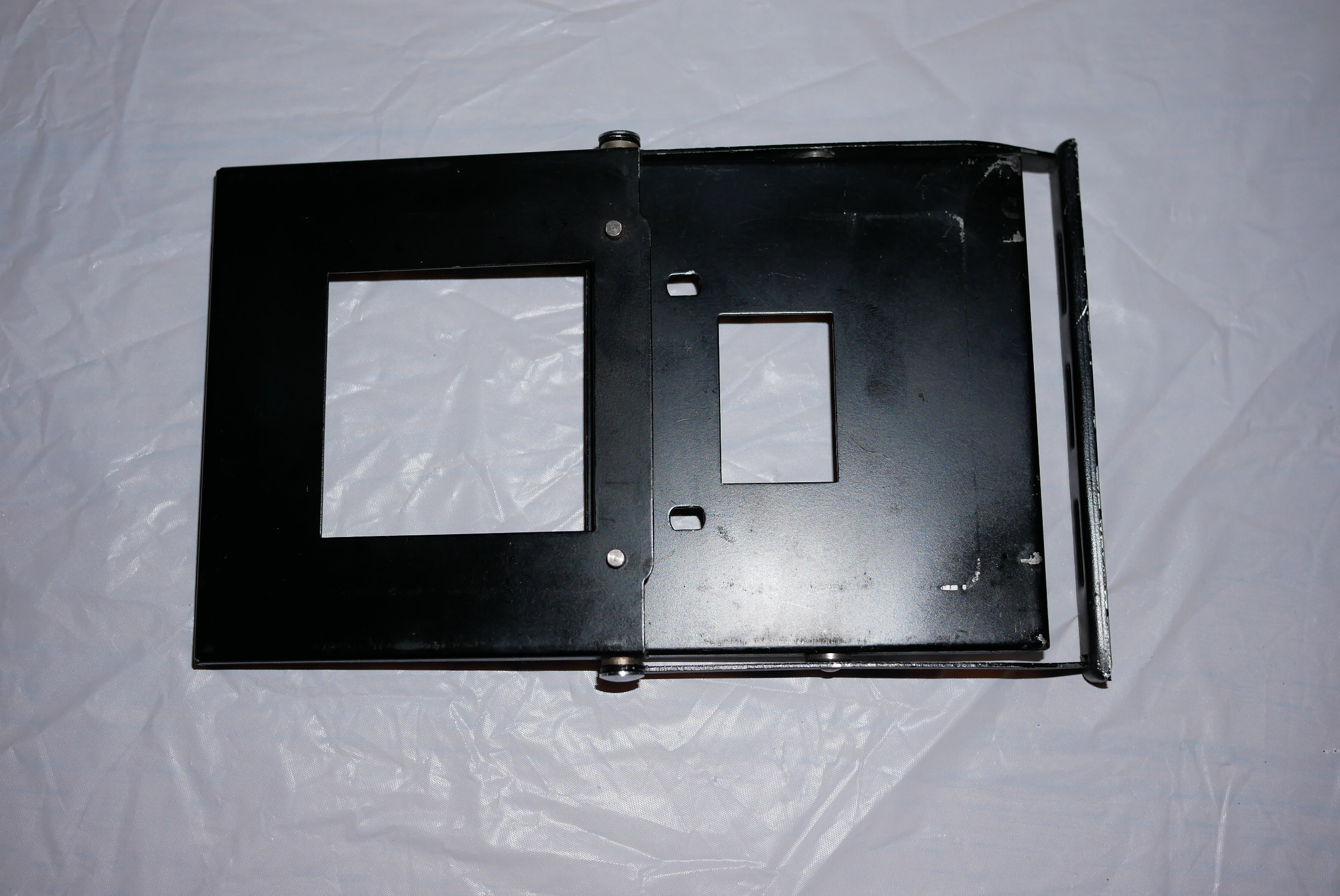

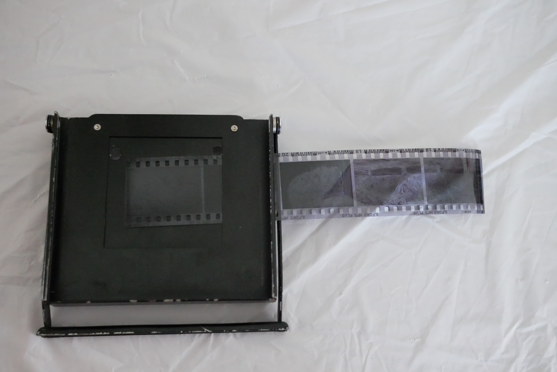

Bonus question: My Beseller's film holder doesn't seem to be able to hold flat the end exposure of a short length of film. From everything I've seen online it seems people cut a film roll into 5-exposure strips for easy light table viewing and storage in a binder. The film holder has one side which seems appropriate for 35mm but the other is more like the size of a 120! As such the end of a film strip just hangs down through the larger hole (see pictures below). Is my film holder defective or missing something or is it supposed to look like this? Am I only supposed to use full-length film rolls with the Beseller Cadet?

As for that carrier, it looks to me to be incomplete.
Here is a link to the exploded part diagram for your enlarger, which shows trhe various configurations of the negative and slide carrier: https://www.beselerphoto.com/wp-content/uploads/2018/08/Cadet-II-Exploded-View.pdf
It looks like your carrier has been modified somehow. The cutout in both halves should be the same size, approximately the size of one 35mm frame.

Thank you for your responses everyone! I will look into my film carrier. It is a small square thing and not the usual large round carriers you see on eBay that are for far bigger enlargers so I will have to contact Beseler and see what they say. The lens on my enlarger only steps down to f/16. At that level the image is very dim, but I will try it with 1/2/3 second exposures and the full 90 (or 120) seconds development and see what happens. Unfortunately I have already exposed all my paper to the safelight so I will have to buy more to do the safelight test. The light itself is right next to the enlarger, which I'm guessing is a bad idea. My set-up is very cramped in my small bathroom so I just put the enlarger, timer and light on the top level of a lightweight shelving unit, the chemical trays on the level below and the wash tray on the bottom, all in my bathtub. I could place the timer/light on the other side of the bathroom, but then it would still only be maybe 5-6 feet from the enlarger. The dev tray is red.

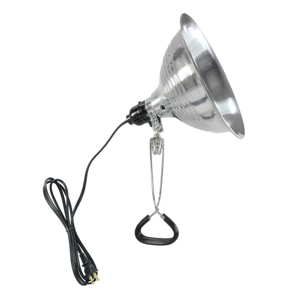

Put that safelight bulb in one of these clampable holders and point it at a wall or ceiling:
https://www.homedepot.com/p/HDX-8-1...-with-Clamp-277894/202847393#product-overview
The ones I used (before I switched to a red LED rope light) were smaller and had white reflectors rather than shiny metal reflectors, so are probably better, but that one should work - as long as the LED bulb you are using has the right type of red light.
