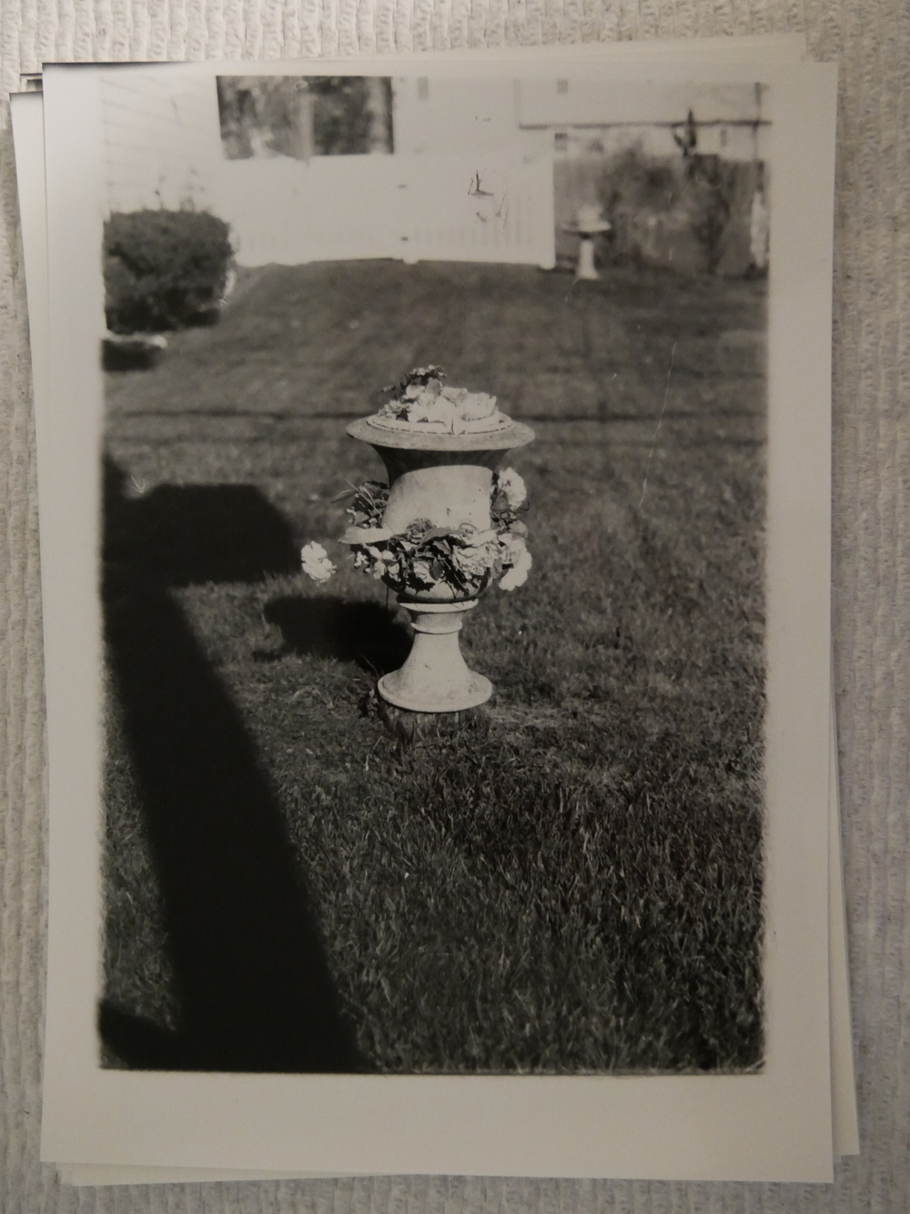

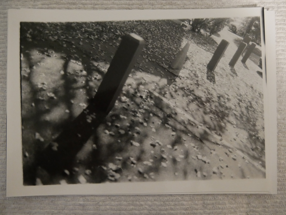

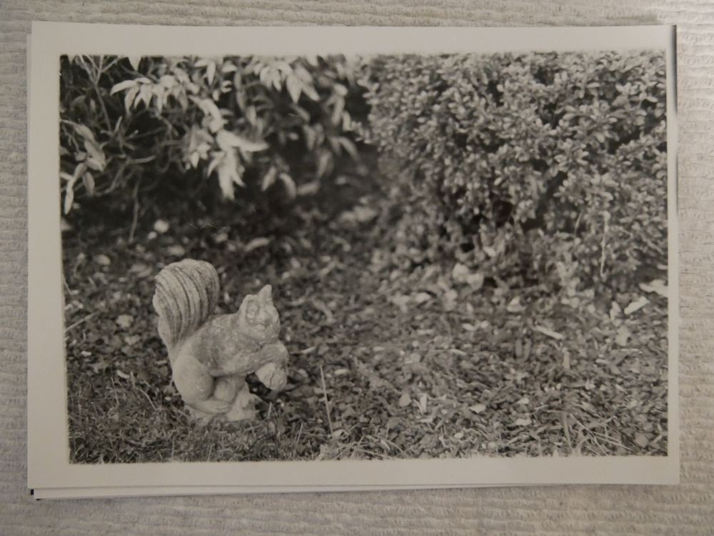

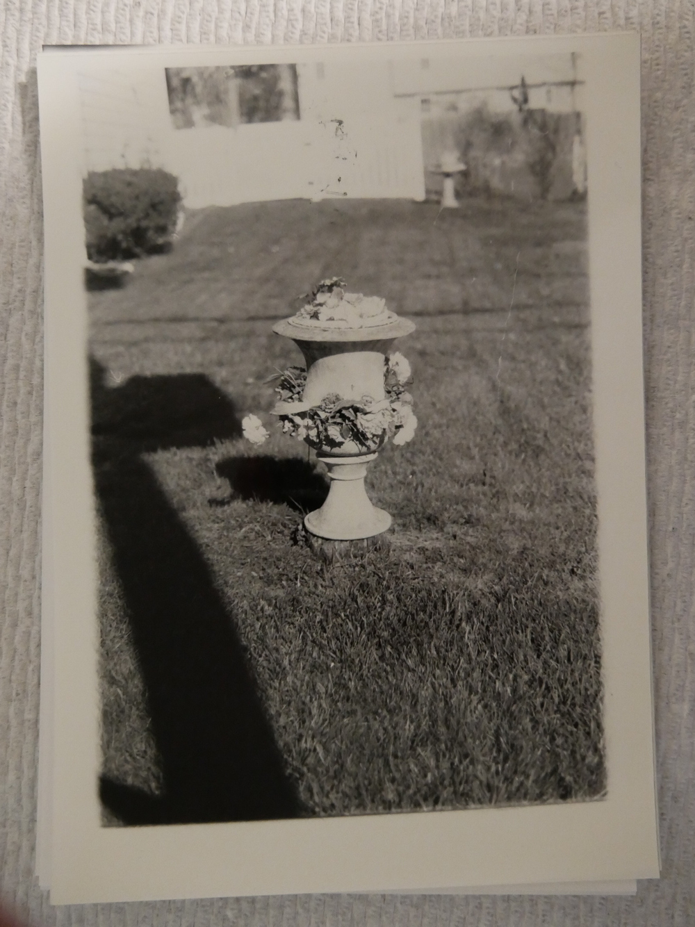

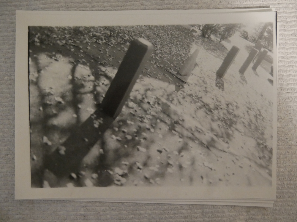

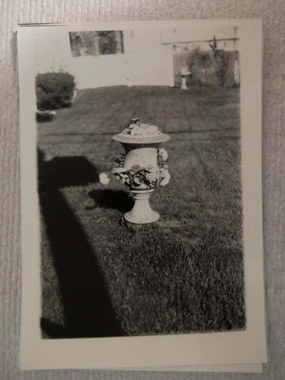

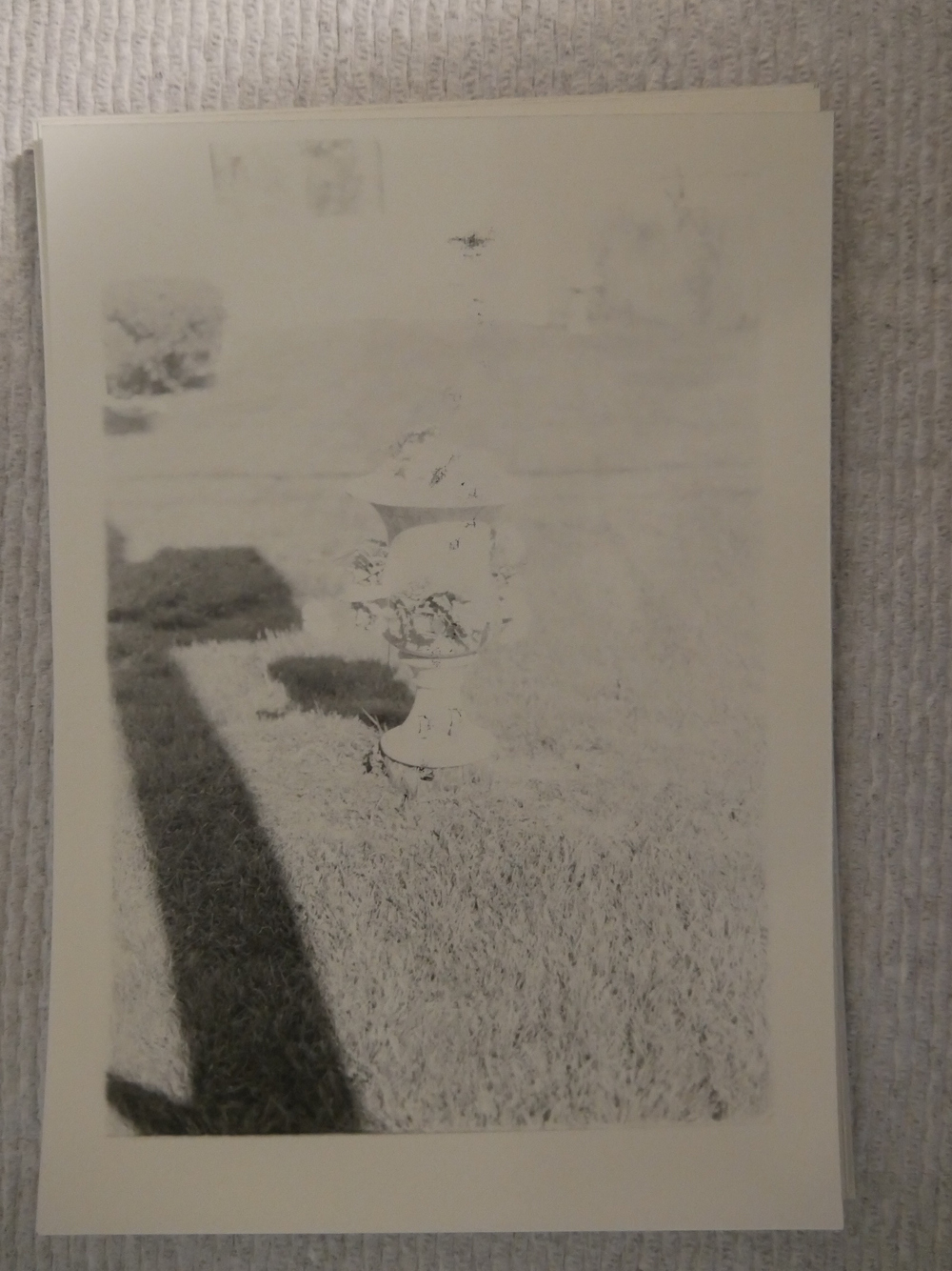

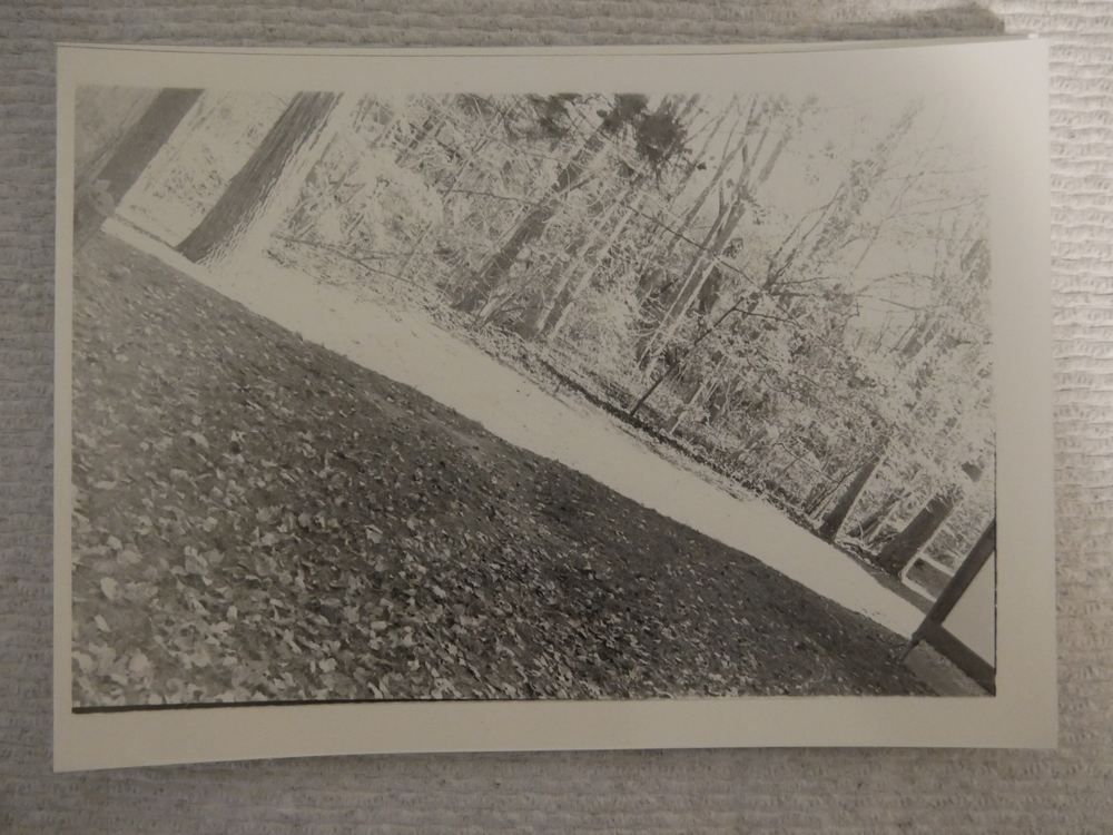

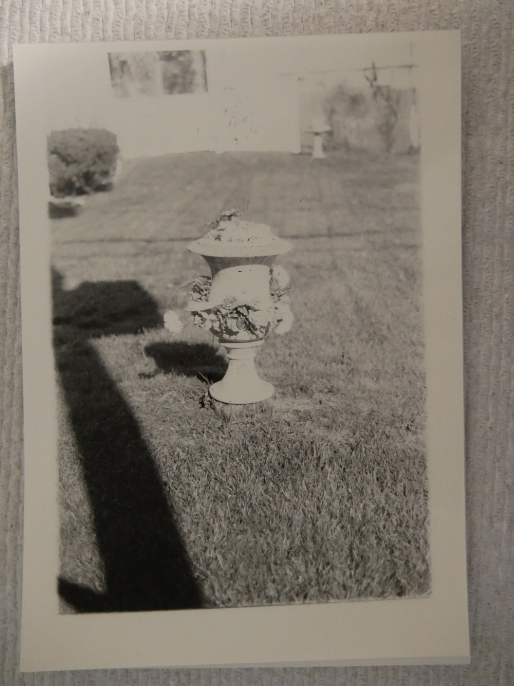

Below I have attached some of the prints I developed today. Since I lack a scanner I had to use my digital camera to do the best I could. Forgive the terrible lighting. These pictures are:
778: The first test image, right after the blank white sheet, 1 second exposure.
779: 2 second exposure, Ilford Multi-Grade
780: 4 seconds
781: 6 seconds
782: 8 seconds
783: 8 seconds exposure, Multi-Tone
784: 2 seconds exposure, likely could have been improved at 3.
785: 2 seconds
786: 3 seconds

It sounds like you are making process.
Could this difference be due to the exposure levels of the film while in the camera? The 3 second exposure was from a frame that was noticeably dark and probably originally underexposed.
Yes.
When you say a frame of film was dark, do you mean dense, or clear?
A dense negative will require more exposure at the printing stage.
A dense negative results from more exposure (not under-exposure) at the taking stage.
Speaking more generally, I prefer my printing times to be longer - at least 10 seconds. That gives time for dodging and burning. Some of the options that make a difference are lower power bulbs, neutral density in the light path, and always using a multigrade filter.
One final technical point: you will discover that a ten second exposure without interruption provides more exposure than ten one second exposures. That will become more important with experience, as repeatability becomes more important to you.
Dark = dense. Frame is mostly grey with few if any clear areas. So must have been overexposed. The whole logic of negatives takes some getting used to.
I will look into both the bulb and NDF ideas. This will be even more necessary for making even smaller prints (an idea which interests me) given that a closer enlarger = more intense light. I can already see opportunities for D&Bing in some of my prints.
I will be sticking to multiples of one- or two-second exposures for now for consistency.

Exposure is still too bright. Best starting exposure is around 8 seconds. It's fast enough for printing and gives enough options for dodging and burning.
From 8s it's easy to go one stop up or down and increase/shorten time if you need more speed or more control.
First thing is to establish workable exposure. Better strategy for exposure strip is to go with F stop scale.
