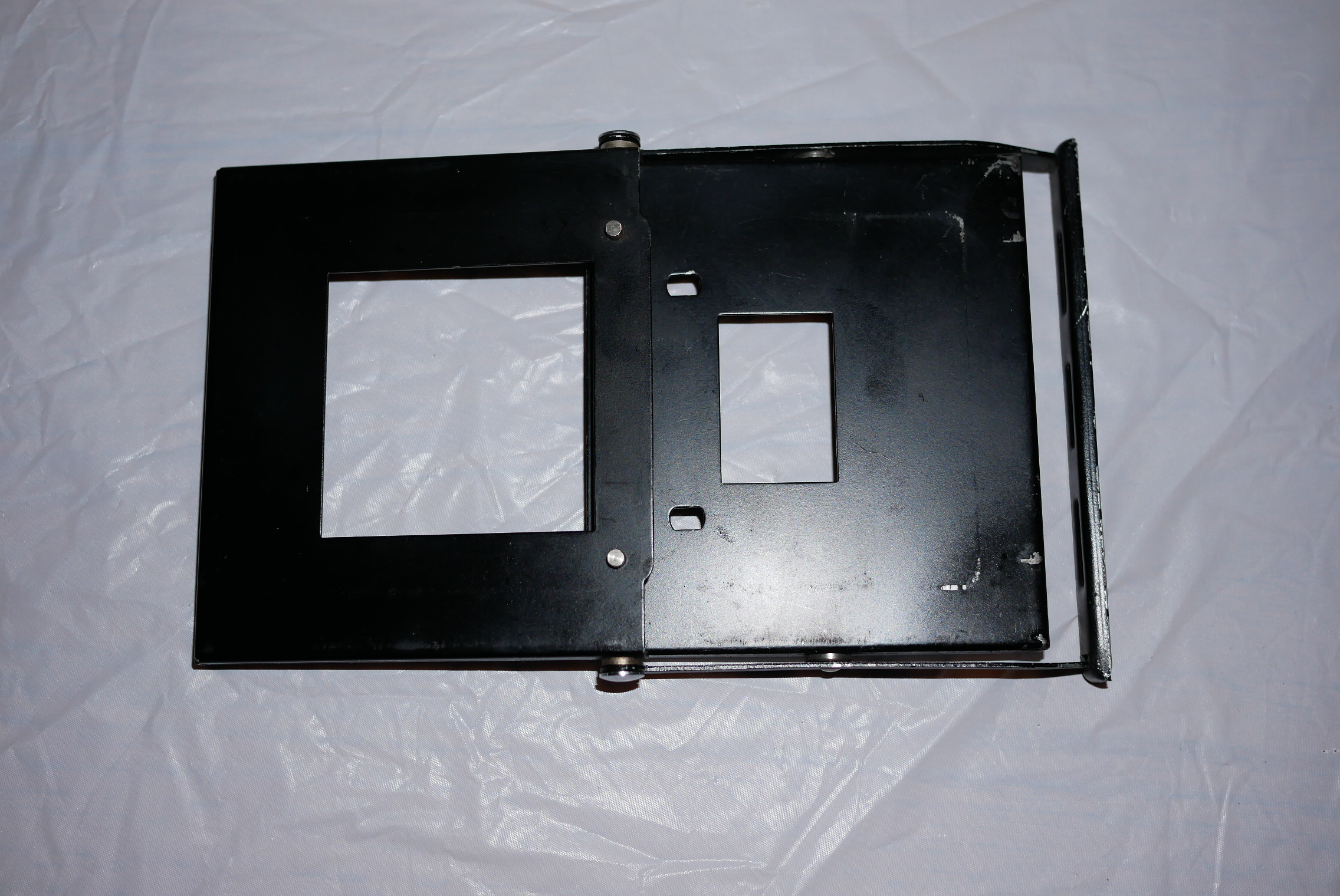

Hello all. I am having trouble with development of paper in my first attempt to set up a darkroom. I will not get into my camera setup or the film development aspect to this adventure unless someone asks.
I set up my film shiny side up in a Beseler Cadet 35 and adjusted the enlarger to get as sharp looking an image onto the frame created by my easel to fit a 5x7 paper sheet as I could. Then taking out a sheet of Ilford Multigrade 5x7 in red light I expose it to make my very first print with 5, 10, 15 and 20 second strips using a Priority Mail envelope for a mask and dip into a 14:1 solution of Ilford Multigrade paper developer for one minute (I later learn it should have been 90 seconds). My image appears (!!!) and then goes completely black (!!!) over the course of 60 seconds before making successive trips to Ilfostop and Kodafix before finishing up with a wash and hang dry. For the next few minutes I wait in the dark for it to dry hopeful that my first image might somehow reappear...but no. My firsy print is just solid black, not the slightest hint of what it was supposed to have been.

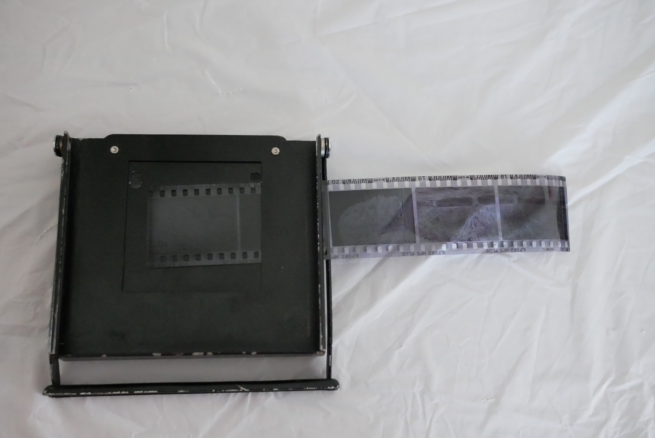

Bonus question: My Beseller's film holder doesn't seem to be able to hold flat the end exposure of a short length of film. From everything I've seen online it seems people cut a film roll into 5-exposure strips for easy light table viewing and storage in a binder. The film holder has one side which seems appropriate for 35mm but the other is more like the size of a 120! As such the end of a film strip just hangs down through the larger hole (see pictures below). Is my film holder defective or missing something or is it supposed to look like this? Am I only supposed to use full-length film rolls with the Beseller Cadet?
View attachment 260537 View attachment 260538

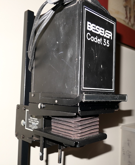

1. If you want to have the advantage of printing on MG paper, you will need to use MG filters. The Cadet should have a filter drawer for 3x3 filters above the negative carrier.
Ok, where is the filter drawer in this picture?
The curved thing with the silver handle in front is shown in the OP.

Why would they put such a powerful bulb in such a small enlarger? When I opened it up upon first receiving it the only thing between the bulb and the lens except the film carrier shown in the OP was a large lens, flat on one side and hemispherical on the other. Nothing I'd describe as able to diffuse or control the output of the bulb. Do I need another bulb now? What should the wattage be?
