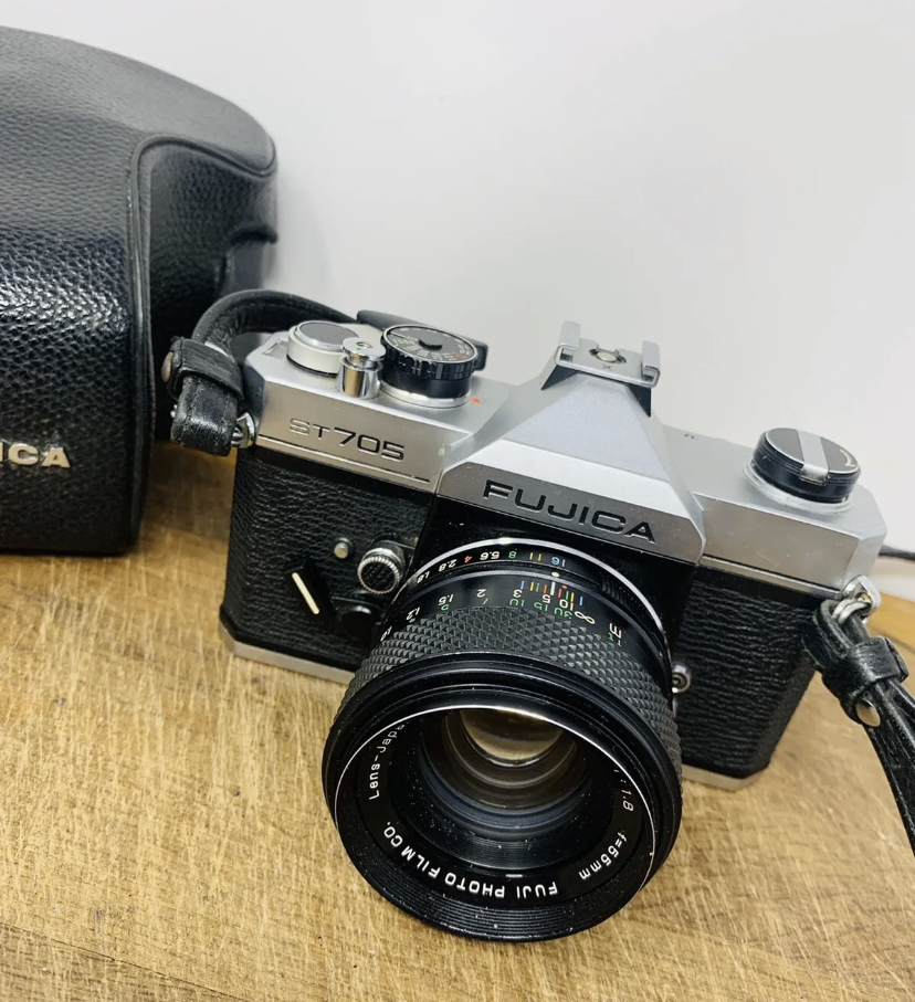

Hi guys! Update. This morning, I was able to find a cheap Fujica ST 705 on eBay. About 40€ with lense and shipping included. And it seems to be in mint condition. 🤞🏻
Can't wait to test it when it arrives! Any recommendation on what to check?
I finally decided to get a Fujica because M42 lenses are cheaper here. I don't think I'll buy one anytime soon but it's nice to have the chance. I was hoping to get the Minolta SRT 101, but lenses are more expensive. So maybe in the future!
Congratulations, this should be an excellent camera!
The first thing to check is the shutter. Open the back cover and try the shutter at different speeds pointing at a light source or, better, a brightly lit wall. First, you need to check if the times seem about right -- you can tell pretty accurately about the slower ones, while for the rest you can just check if, say, 1/1000 is faster than 1/500. Second, you need to check if the second curtain doesn't overtake the first one at the fastest speeds, which prevents the edge of the frame from exposing properly. If you shoot against a bright subject, you will notice that the left edge remains dark. If it's just the top speed, you might be willing to live with that, but you could ask for a partial refund.
The second thing is the light meter. You will need two SR44 batteries (I think -- make sure to double check). Ideally there shouldn't be any corrosion in the battery compartment, though it doesn't always cause trouble. Put the batteries in and see if the needle moves in the viewfinder as you half-press the shutter release button, esp. as you point at differently lit subjects (try the highest ISO setting, the widest aperture and a slow speed, with a bright subject, first). If you are unable to make the needle move with any aperture/shutter settings, take out the batteries and try to wipe the contacts with a drop of vinegar on a cotton bud -- this often helps. If it doesn't, the light meter is probably busted. If the needle moves, you need to check whether the meter is accurate. The easiest way is by downloading a free lightmeter app and checking against it. For instance, I have a spot in my flat that, with the lighting on, requires ISO 200, f2.8 and 1/60 (according to the app) -- that's where I check all my new cameras. Sometimes the meter may be off by one or two stops: say, it will indicate good exposure at ISO 400 instead of 200 -- usually, it's not a problem, you just need to figure this out and remember that if you use a 200 film, to set 400 instead, or 200 for a 100 film, and so on. Again, this kind of compensation usually works, but it is always good to check the meter against the lightmeter app in different light conditions -- it may be inconsistent, though this is rare. If the meter doesn't work, you could just decide to use the lightmeter app, but be sure to get a partial refund, at least.
The third thing is the lens -- make sure it's mechanically and optically sound. Set the aperture at f16 and press the pin at the mount: the aperture should instantly close, and as instantly open when you let the pin go; it's bad if it's sticky. Shine a light through the lens: you will see a lot of tiny dust particles, which is normal, but if there's fungus or haze, or major scratches, that's trouble.
That's about it. It's also likely that the foam used as light seals and to dampen the mirror will have crumbled -- make sure to carefully clear out as many of the pieces as possible. Ideally you may want to replace the light seals, but I never do (but I also usually keep the camera in its case when shooting, which may add protection against light leaks).
There are of course other things to go wrong, but these are the major concerns. It would be a good idea to try it out with a film -- perhaps a short one with 24 or 12 exposures -- as soon as possible, as this could reveal problems otherwise undetectable. Make sure also to look at the user manual -- there must be a pdf on the internet.
