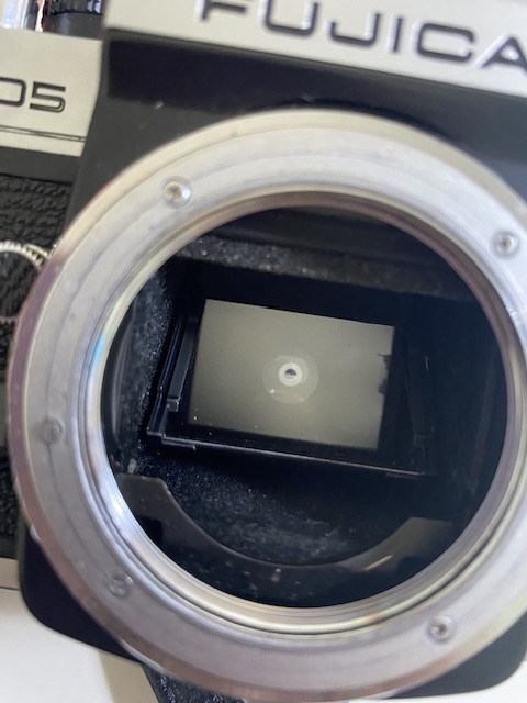

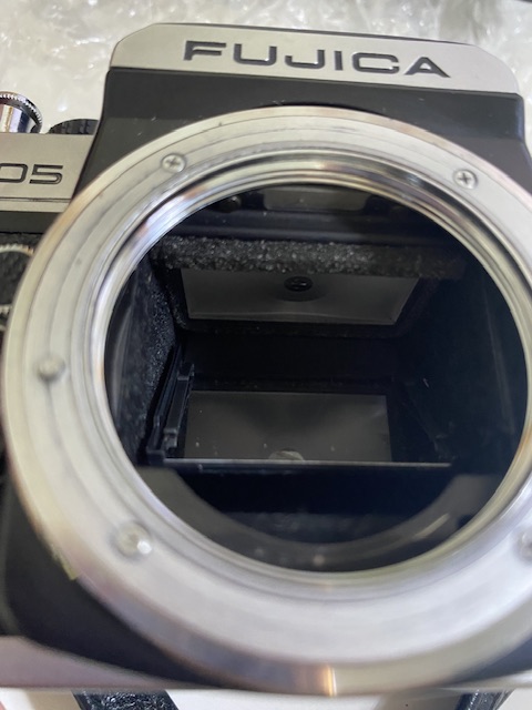

Great find if it works! I would say it needs new light seals at least. Do you have a battery to test the meter? Not that you have to use the camera's meter, but it's nice. I don't put zooms on my SRT's so I'd go with the Vivitar 50, but that's just me.
I used alcohol or lens cleaner to clean the mirror. There may be other options.
I ordered some batteries to test it! I think I’ll receive them tomorrow. Also, need to buy some foam to replace the light seals. I watch some videos about how to do it. Hope I’m able to do it 😂 it doesn’t seem too difficult but I’ll let you know how it goes!
About the lens, I thought that the 20-70mm has more versatility? But as I haven’t used any lenses before I’m a bit lost. I watched some videos about it to understand better how they work, but I won’t know what I’ll prefer until I try some. I thought about going with the Tamron because the other camera I bought come with a 50mm lens. So this way I’ll be able to try both kinds of lenses. But we still don’t know if the Fujica works and the lense is not compatible with the Minolta without an adapter!
Before you clean it you need to remove the remnants of the old foam bumpers and replace with new ones. That junk on the mirror is from the disintegrating foams in the camera.
Once you have replaced the foams, and blown out the camera to remove any remaining crud, then clean the mirror.
I use isopropyl alcohol and cotton swabs.

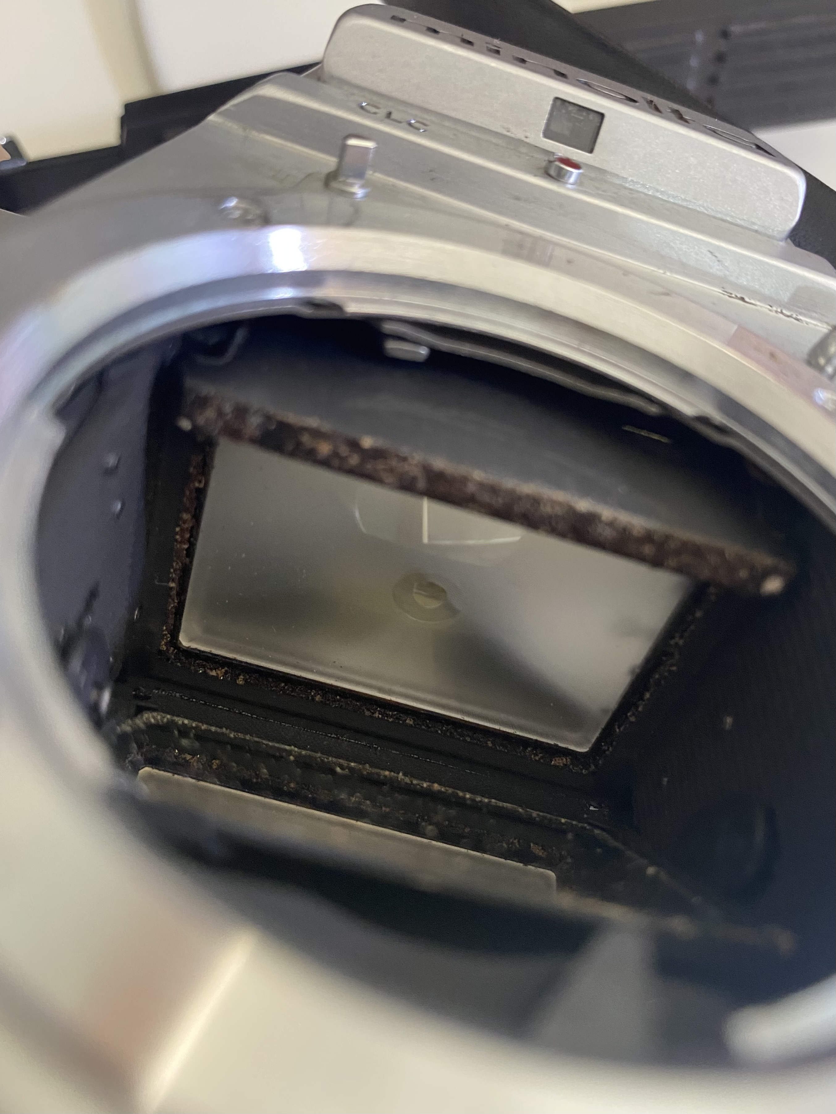

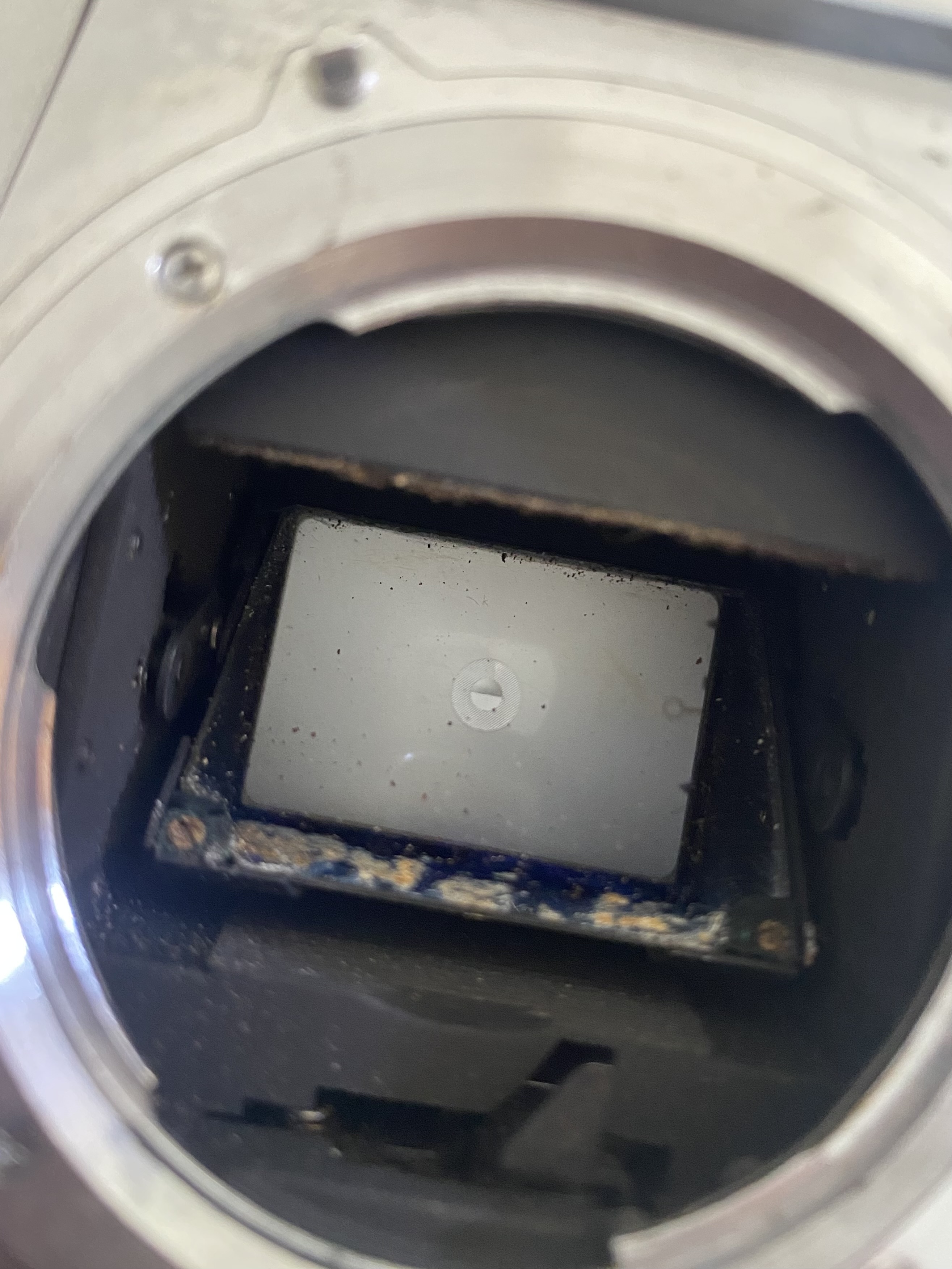

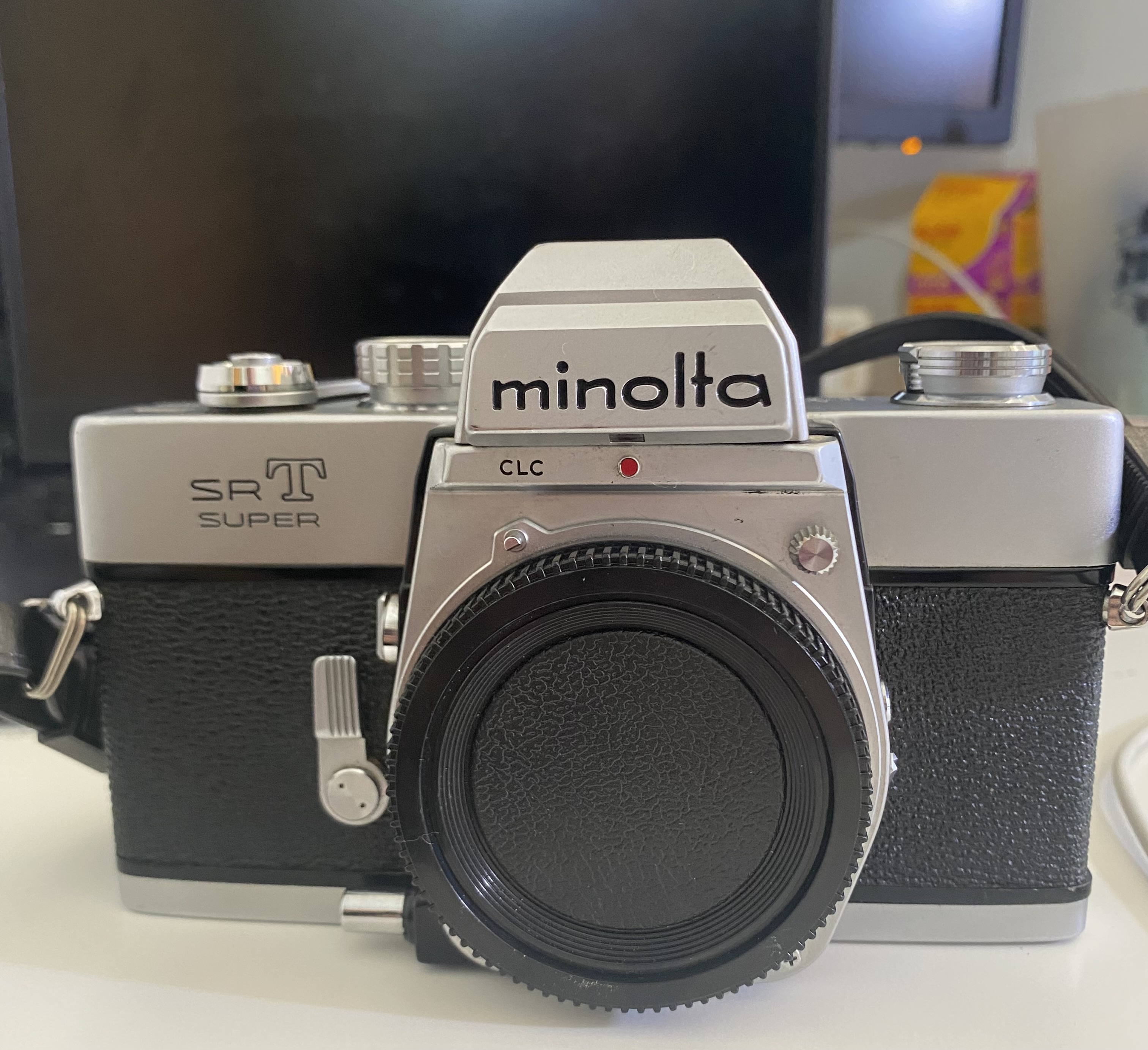

But, while I wait, I managed to get another camera. I found this Minolta SRT Super on ebay for just 5€. And of course, I had to buy it.
It’s untested and ir arrived today. Everything seems to work. However, it needs a cleanup. I attached some pictures.
Any recommendations about what to use to clean it? Specially, the mirror.
View attachment 336906View attachment 336907View attachment 336908

The prep is important in replacing light seals. Like the prep in painting. I'm very anal about prep so I get every bit of the old seals and adhesive out. I also cut my own seals out of a foam sheet I get at the local craft store. But, I'm not saying that's the best route for you for the first time. I got seals from US Camera for the first ones and just found out I could do a better job cutting them myself.
Batteries....do some research on that. I don't know what you bought, but 675 hearing aid batteries with a #9 rubber o-ring adapter or a metal adapter can save money over Weincells. (I got my SRT's modified by John Titterington to use modern batteries so I don't have to fuss with adapters.)
Yes, the 20-70mm lens will give you more versatility and since you have a 50mm coming on the other camera, it makes sense.
If you're artistic, you can get some Apoxie Sculpt, JB Weld, Metal Mend, etc. and mold a piece for your winder. Glue it in place with some strong adhesive. The upside to this is you can make it the shape you want so it doesn't stick out like the one that comes with the camera.

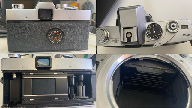

The SRT SUPER is just another name for the SRT102 & SRT303 -- they were just sold in different locations. And like the SRT102 & SRT303, the SRT SUPER came in two versions. They were the top-of-the-line manual camera at that time from Minolta. Assuming it works, you got a great deal. You can read about them here:
http://www.subclub.org/minman/srt102.htm
Yes! I know. That’s why I bid up in this one. When searching for Minoltas I never found this model and I did some research.
The seller had other models like the SRT101 that I wanted. But this one was such a deal because I was the only bidder and 5€ was the initial price. The other ones had more people interested so they sold for a bit more. Still cheap though because all of them were untested.

I finally received the Fujica! But bad news, it doesn’t work :sad: the shutter is stuck and the timer don’t go all the way.
The light meter works though. And the camera and the lens seem in good condition. I was hoping the camera will work too…

If it was mine, I'd remove the bottom of the camera and carefully poke around with a toothpick or something to find whatever little part is keeping the shutter from firing. I wouldn't force anything. Could be it just needs lube. Is there a film rewind button on the bottom of the camera that is depressed and not sticking out? Those have gotten stuck in the depressed position on mine. I've done the above to release them. Sometimes, juts some firm taps on the film takeup reel inside the body releases that button. That could be related to the shutter not firing. Of course, this is a WAG (wild-ass guess).
In addition to Mr. Kid's suggestions, above -
If the self timer doesn't unwind all the way then on most cameras this will keep the shutter from firing.
It is normal for self-timers to gum-up over the years and either run slowly, run erratically or not run at all. Sometimes nudging the self timer lever will help the mechanism along. Sometimes not, it all depends on the design of the camera.
If, as suggested, you can find the link between the self timer and the firing mechanism then it may unjam the camera. However, there is the chance the camera will lock again after an exposure and will have to have another 'toothpick' reset. Here's hoping this isn't the case.
On some cameras the self timer is a standalone mechanism that can be accessed by removing the self-timer lever and peeling back the leatherette. There will be a few screws around the self timer, and after these are removed the self timer will lift out. A good flush with cigarette lighter fluid or the solvent of your choice will usually get the timer working again. In my case, after I clean them off and get them running again, I do not oil them and instead let them run dry; I use a self timer so infrequently that it isn't going to wear out if it isn't oiled.
Don't waste your time screwing around with the guts of the camera. If you accomplish anything, it will probably make matters worse.
Either return the dud camera, get a refund, or sell it for what it's worth -- next to nothing. You can probably get some $$ for the lens -- or since it's a screw-mount, you could buy an adapter for your Minolta, but I would not advise that since the aperture will not connect with the camera.
