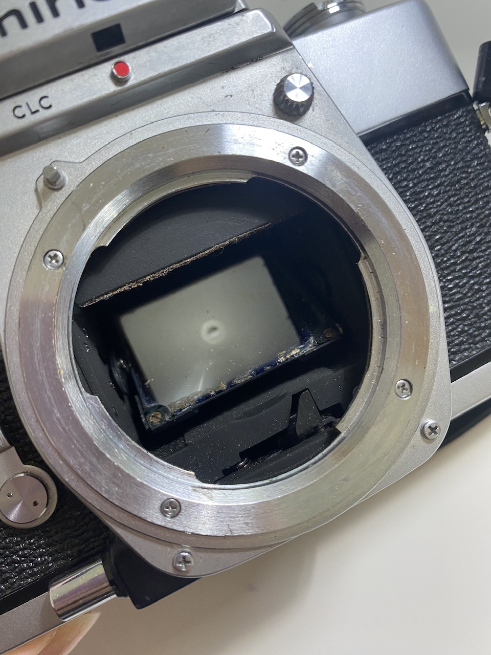

I just wanted to change the seals because they look disintrigated. And the mirror is missing the foam and I’m scared it might broke because of that?? What do you think?

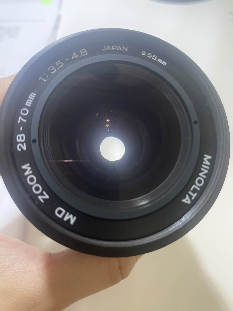

I got a Minolta 28-70mm for 19€. It was the cheapest I could find in good condition. Many suggested to get a prime lens but couldn’t find any THAT cheap. I wanted to expend the minimum to test the camera first.

That's a great deal on a 28-70mm -- assuming it is in good shape.
Those seals don't look that bad to me, but it's easy to check with a film test. As to the foam around the mirror. That's more difficult to replace, but might not be a big deal. Can you provide a better picture of the mirror foam?

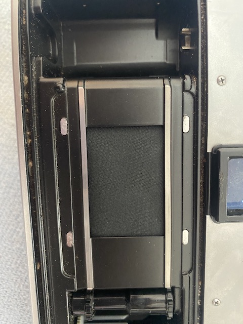

Here you go!

Here you go!
From what I can see, that foam does not look that bad to me. Sure, if you have the time and the money and the skills, replace them. My advise? Leave them as is, and have a good night's sleep.

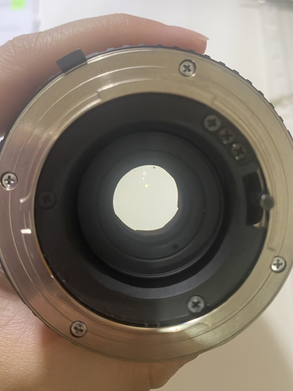

I just received the lens! It seems to be in good condition. Any recommendations about how to test if it works?
I put it on the camera and try to focus at different mm. It’s not as clear as the one that came with the fujica. I tried to clean the mirror yesterday, but maybe it still has dust?

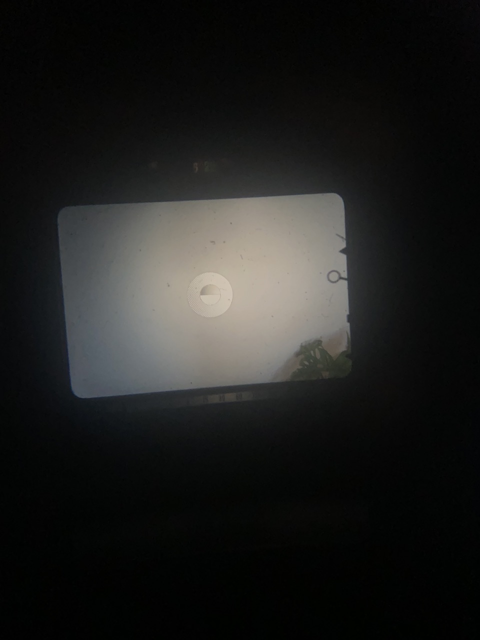

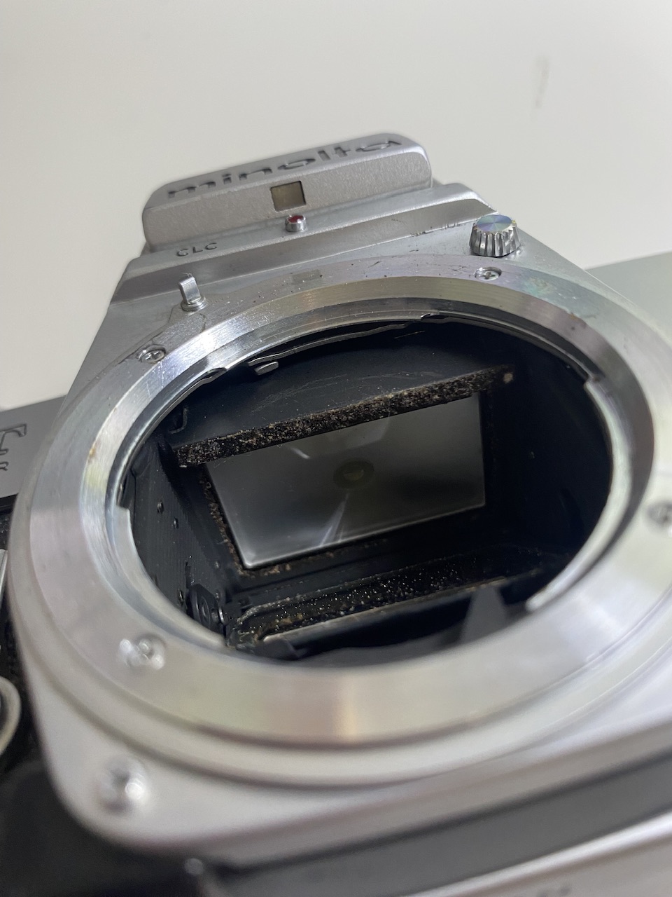

Also, I put new light seals! I found adhesive foam for 1€ at a store near me. However the one on the mirror doesn’t stick really well. I don’t know if I can use some kind of glue to make it stick better.
Could be that the lens has haze. Hard to tell from the pictures. Could be a hazy viewfinder, too.
I use E6000 adhesive to install my foam light seals. That should work on the mirror foam even if it already has adhesive on it. Use a toothpick to apply it to the foam. The E6000 is stringy, if you know what I mean. When you put a dab on the end of the toothpick and pull it away from the tube it will leave a spider web thingy trailing it. I usually spin the toothpick like you would a fork for spaghetti to wrap that string up. You don't want adhesive on the mirror.
To test the lens, put it on the camera and see if it focuses -- not too tight, not too loose.
Then take if off of the camera and set the lens to f22. Look through the back of the lens and move the small metal lever left and right. The aperture blades should open and close very quickly.
Your camera's focusing screen looks clear enough, but I have no idea what that crud is in the corner. My advise? DON'T mess with the mirror. It is a soft, front surface mirror -- and very easily scratched.
I hope the lens is not cloudy. I can't tell from the pictures. Find something with good details, in the sun, like a bunch of flowers and focus on them. They should be nice and clear.
The zoom lens is less bright, that's expected. Hard to tell from the pictures if it's hazy.
I second the recommendation not to mess with the mirror. You won't see a little dust on it, it's not in focus. Other places in the viewfinder assembly are more likely culprits and less fragile (not the focusing screen, that's also fragile but you do see the dust on that!).
