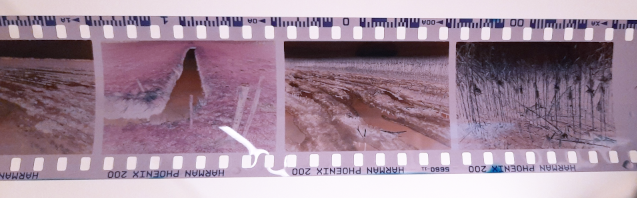

Snipped a roll in half and shot & processed it today.
Smartphone snap of a few negatives that are currently drying:
Inverted & crude curves adjustment:
Can't say anything particularly useful yet, apart from that it evidently records color alright, the contrast is absolutely THROUGH THE ROOF and nothing like a regular C41 film. Most of the negatives basically won't print at all without applying some trickery; the density range looks more like grade 1.5 B&W negatives. Not to worry though; I'm sure something reasonable on RA4 paper can be coaxed from the negatives alright. It's just not going to be straight prints for the most part. And this means there's going to be additional challenges w.r.t. color balance and crossover apart from the inherent curve of the film itself.

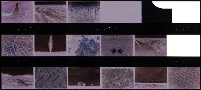

This is a first glance at the negatives I did yesterday on this film:
Above is the negative as scanned. Note that my Epson scanner (like virtually all scanners) does a lot of auto-exposure magic that cannot be disabled in the Epson scan software. So there's no absolute benchmark here; we'll have to interpret everything relative to how the engineers at Epson some 20 years ago decided we should be scanning film.
Shown above is the raw scan of the strips (Epson 4990 film holder). Scanned flat as positive and then used the Curves dialog to approximate a neutral color balance. Starting points in this curve adjustment are:
1: No lopping off of data on the left side of the histogram; these are the dense areas on the negative, so the highlights of the positive.
2: Truncate the shadows just after the bump of the violet hue of the film base itself, which is visible as a little bump/peak in the tail-end of the histogram (see illustration above, shown for the red channel).
This gives at first glance a very decent starting point and no glaring/major issues, apart from a very muted color palette. This is to be expected given the exceedingly drab conditions under which these were shot.

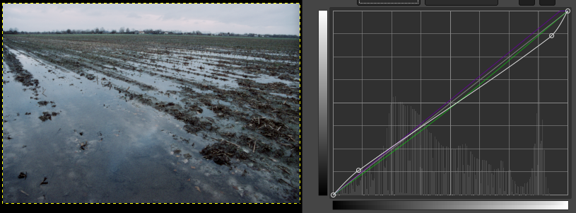

Taking one frame from the set and applying some entirely subjective adjustments to approximate the scene as I experienced it when I photographed it:
* Steepened the blue curve a tiny bit. The datasheet of this film suggests especially a significant blue/yellow crossover, but the adjustment I did here was really less than what I'd expect on that basis, so I guess most of it has already been 'dealt with' by the scanner and its software. It's a black box and there's nothing I can do about it.
* Took out a tiny bit of green from the midtones only. Just a matter of taste/subjectivity. Or maybe it does match with the stronger green response that the characteristic curves show - but this seems pretty much constant, so I would have expected it to be filtered out at this stage already.
* Applied an inverse S-curve on all channels. This does match up very well with the datasheet of the film, which shows a very distinct toe and shoulder. Countering this with an inverse S-curve does indeed bring the image much closer to natural in my view.
If I apply the adjustment curve above on all images, they seem to work out as pretty neutral.

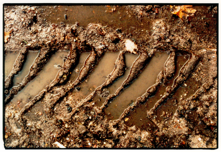

I did scan a few frames with the Minolta. I'll include two examples to illustrate two different points.

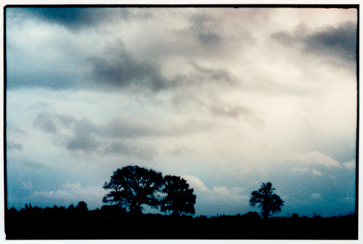

First, there's this scene:
I deliberately exposed this for the sky. I set my camera to ISO 200; let's just start by doing what the manufacturer suggests, which in my experience is usually a safe starting point. I was aware of the strong contrast, so I treated the exposures more like slide film, and since the sky was the subject here, I put it at something like +1 overexposure. The strip of foreground I expected to render as pretty much black, and it sure did. Having shot the same scene with other types of film, I know that those tend to better preserve some tone and differentiation in that part of the scene, especially under these low-contrast conditions.
So what I take from this is that there's really very little margin for underexposure. I've seen some mention of pushing this film, which based on the curves as well as this initial real-life shooting experience I find a totally ludicrous idea. This film is much closer to a 100 speed film than 200, and I understand this meshes well with Harman people saying that it's actually 125. I feel that's probably close to the truth.
Btw, I'm quite pleased with how the subtle differentiation in those clouds render in this scan. And as long as the image is kept small, it looks somewhat decent. The graininess of the film doesn't really work with this kind of scene if it needs to be viewed bigger; things start to literally crumble. So on to the next one, which actually is about the grain:

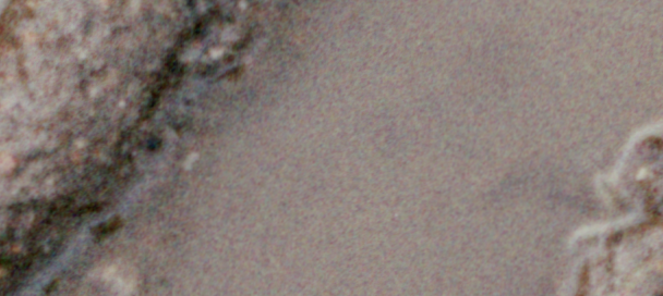

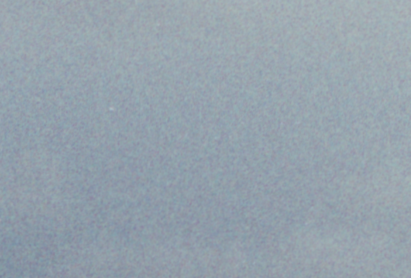

This is just to give context for the 100% pixl-peepers-'r'-us crop to get an impression of scanned grain:
This is unsharpened, and actually not all that bad. The appearance of graininess does depend a lot on density (it looks different in shadows, midtones and highlights), possible contrast adjustments and even the color of the image. Here's for instance a similar crop from the sky image above:
While I find this grain totally unproblematic in the mud image, it becomes a problem for me in the sky image, which I feel asks for a smooth rendition.
None of the examples above have any sharpening applied to them. This would of course emphasize grain. E.g.:
To the left of the vertical magenta/white line is the sharpened area, to the right of it is as original. Note the 'tighter' appearance of grain.

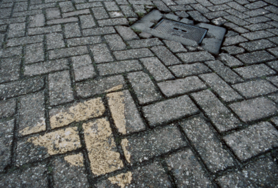

Consider this scanned and color-balanced image:
1702373411417-png.356425

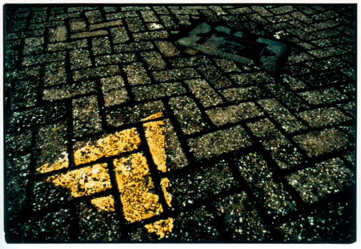

This is a straight print of the same negative:
I kid you not. Same negative. Straight print.
Here's what I get if I get creative with some burning in and a post flash:
In the above prints, I was puzzled by what seems like a gross fogging problem since the color balance on the left 1/3 of the image is so different from the upper right corner. I suspected some massive problem in the optical path or light source of my enlarger. But the 'anomaly' is there in the negative alright. It's just the film that does this. It might have something to do with the slightly brighter part of the sky resulting in a little crossover (probably it's just cyan dye formation in the bottom layer due to the absent anti-halation measures), that combined with the high gamma of the film ends up as pretty massive on the paper.
The filter range on my DIY enlarger was insufficient esp. on the yellow/blue channel to get close to a decent color balance, so I ended up switching over to raw mode where I get full control over the R, G and B intensity scale. However, that's about the point I ran out of time. I might revisit that later, and I might also insert a piece of blank color film somewhere to get the filter settings in a more usual zone, although that's evidently not going to really help much, apart from mentally maybe.
The contrast is formidable. So is the crossover. The grain seems formidable but this is mostly because the gamma is so ridiculously high for a color negative film. This film isn't intended to be optically printed as color negative film, at least not with straight photography in mind. Of course, this can be exploited creatively, and very well at that. This is more lomo than Lomo.

Coming back to the example images. I had a little time yesterday (but less than I had anticipated) to make one or two prints. Literally one or two, because it took me a massive number of test strips and prints to get...well, not even close to something natural.
Unleash it on very (extremely) low contrast scenes with an SBR of maybe 2 stops, and you get some pretty gritty stuff. Here's that frame with the yellow triangle I posted before. Turns out it prints even more extreme than I envisioned based on the scan...
Or some mud:
Love these results! I see nothing wacky in any of the above! Keep them coming!
And.. As I anticipated.. As the really creative people come out and mould this stuff to their vision, we're really going to see some creatively interesting results.
Trying to print this film to get realistic/true to life results feels a bit like going downhill at 100mph on a landslide on a bicycle powered by a rocket engine. The margin of error is kind of small. It also seems to defy the purpose to try and print this for a natural look.
I really like what you did with it. I don't know anyone in my 'bubble' who would use C41 film to achieve photorealism. Again, in my bubble. If I wanted a 'realistic' photo I'd whip out my iphone, take that boring realistic photo, and print it on my Canon sublimation printer. A boring, realistic, true to life image that I will forget about within 10 minutes.
Please post more prints, this is exciting. I placed an order for a few rolls.
