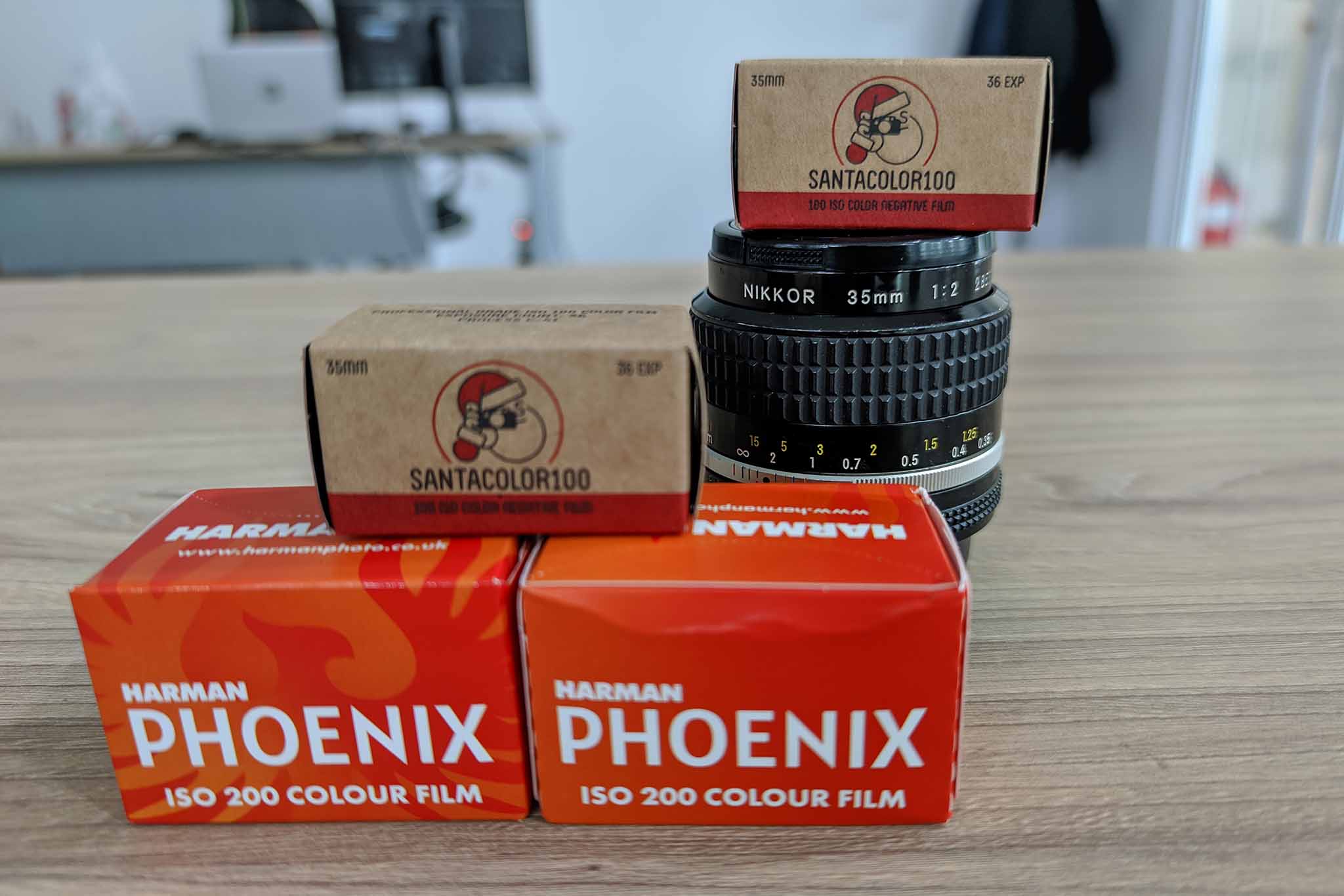

Santa brought me two pieces from Phoenix today :smile:
Unfortunately, the weather forecast is for a sharp deterioration in the next few days, and I'll probably put off loading the camera a bit...

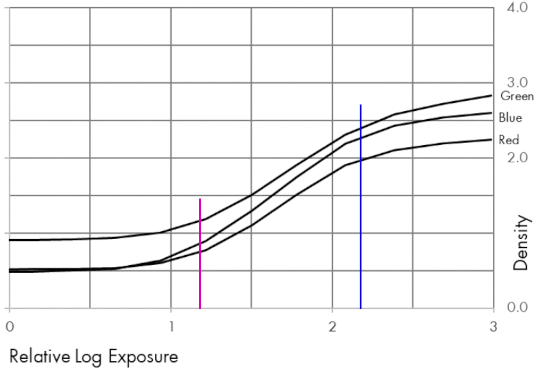

That Phoenix has crossover is not a secret; it's pretty clear from the datasheet. Look at the characteristic curves:
I've drawn in a magenta and a blue line as reference points. Suppose you expose a grey patch of a single density so that it falls at the magenta line in the curve ('low exposure'), and then another exposure of the exact same grey patch, but this time so that it lands on the blue line ('high exposure'). You'll see that the densities will shift around, and more specifically, the ratio between the color channels will vary. The densities of the low exposure will be [R,G,B] = [0.75, 0.85, 1.15]. For the high exposure they will be [1.95, 2.3, 2.4]. The base (where the curve crosses the vertical axis) is at around [0.5,0.5,0.9]. If you subtract the base (let's assume this is constant) from the example exposures, you get net densities for the low exposure patch of [0.25, 0.35, 0.25] and for the high exposure [1.45, 1.8, 1.5]. If you then take the ratio of blue to red (B:R) and green to red (G:R), you'll see the difference, as this would work out for the low exposure as [B:R, G:R] = [1.40, 1.00] and for the high exposure as [1.24, 1.03]. As you can tell, it's especially the blue channel that is shifting around, which of course shows up in the plot as well.
From here, it's a small step to imagining what happens if you photograph a greyscale that occupies not a single spot, but a range of exposures in the H/D curve. You'll see that the dark patches of the greyscale will render a different color than the lighter ones. Put differently: if you were to color balance the exposure (in a scan or print) for a neutral gray in the low values, you'd end up with a color cast in the high values, and vice versa. This also shows up if you scan several frames with different exposures at once or with the same settings and then apply the same inversion and color balancing curves to them. The colors will shift around depending on exposure. This is what you see happening in the video, although the explanation seems more intuitive/subjective while the one I give above is a bit more technical/(quasi-)quantitative. It boils down to the same thing, though.
Coincidentally I'm currently working on a blog that illustrates this for color RA4 paper which crosses over since it has become optimized for digital. However, the crossover is far, far more subtle than in this film and it's only noticeable if you look for it. In Phoenix film, it's actually challenging to color balance even a scanned image to avoid this crossover and in printing, it's virtually impossible even if you were to mask it, since the crossover is also non-linear.

Great explanation, thanks - are there particular technological limitations explaining why the slope difference is particularly noticeable in the blue channel here? Is this crossover usually a mismatch in gradient in one of the three curves or could it look like a non-linear transformation of one those curve segments in the linear portion?
Only a couple of dozen, probably. Color emulsions are complex animals. Lots of aspects influence linearity and tracking between curves. Maybe @Lachlan Young could comment on particular blue/yellow-related issues.
That's the definition of 'crossover'.
Edit: to expand a little on my brief answer: I think the main reason why the channels don't track very nicely yet is that this looks like a single, high-contrast emulsion for each color. Seems like Harman went with the most crude form of color film they could muster, probably to get the basics (sort of) right. In general, a color negative film has between 2 and 4 emulsions per color layer; 2 for blue/yellow-forming, 3 for red/cyan-forming and 3 or 4 for green/magenta-forming. As far as I know this combination of emulsions is mostly done to get good linearity over a wide exposure range. According to PE, the emulsions would generally be spaced at one stop intervals, with the fastest emulsion being the ISO speed plus one stop plus a bit, medium emulsion ISO rating plus a bit, and the slowest the ISO rating minus one stop and plus a bit. The 'plus a bit' would be used for trimming purposes. There's a post by PE on this here on Photrio where he briefly mentions this.
One of the reasons why the crossover is so noticeable is probably also due to the inherently high gamma; if you turn your steering wheel a tiny bit when going 10mph, nothing much happens; if you do the same thing when going 100mph, you'll veer off the road.
Apart from combining emulsions, there's a whole slew of measures taken to influence toe & shoulder behavior as well as average slope, inter-layer effects etc. Most of it I don't know about or have only heard about superficially. There are some good books about it, but they're kind of expensive for the most part, even today.
Trying to print this film to get realistic/true to life results feels a bit like going downhill at 100mph on a landslide on a bicycle powered by a rocket engine. The margin of error is kind of small.
