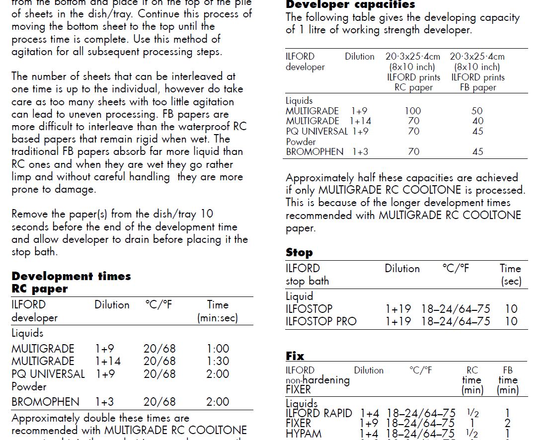

If you look up the data sheet for your developer, it will indicate what the expected capacity of your developer is, expressed in terms of numbers of 8"x10" prints can be expected per litre of working solution. So look that up, keep track of how many prints you are developing, and expect to replace the developer when you approach the expected capacity.
Remember that one 8"x10" print is equivalent to four 4"x5" prints, when it comes to capacity calculations.
You can monitor capacity in another way as well. Pay attention to how long it takes for the dark parts of the image to emerge at the beginning of the development time. If it takes 8 seconds with fresh developer, as your developing session progresses, and the energy of the developer becomes partially spent, you may want to consider discarding nearly spent developer when the emergence of the image slows down to twice that - 16 seconds.
I too use partial sheets for my test strips.
So apparently I am able to do 100 prints with 1+9 dilution. This according to Ilford...

No. You fix to completion.
Follow the manufacturer's recommendation with respect to dilution, fixing time and capacity with respect to fixer.

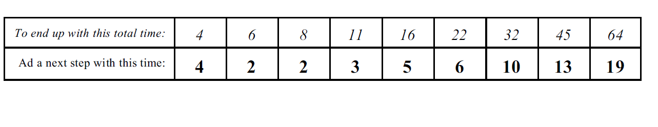

Work and THINK in stop (and half stop) values, I second. Maybe a bit harder in the beginning, makes life so much easier thereafter.
Test strips in fixed 5 seconds intervals will help you find the right base exposure. Test strips timed in full or half stops will help you find the base exposure AND at the same time teach you a lot about how your paper "works".
Thank you. I found this guides Matt posted some time ago in this forum. Seems a good starting point. Any other suggestions are very welcome.
I have that chart on the wall behind my enlarger, although I've basically memorized it now.
For clarity, you use those numbers when you start with the paper totally uncovered, and then sequentially cover over more and more of it as time goes on.
That gives you tests that have different exposure on different segments of the image. There are some neat solutions that move the paper instead, giving you different exposures on the same segment of the image.
I should start with a 19 sec exposure from the right and then adding 13, 10, 6...so in the end I have 9 strips with exposures corresponding to the stops. Is this correct?
Wherever you start, you have to go left to right for this to work.
So if you start at 16 seconds (the time on the top row), then the next steps (from the bottom row) are:
TOTAL TIME2232456490128180
