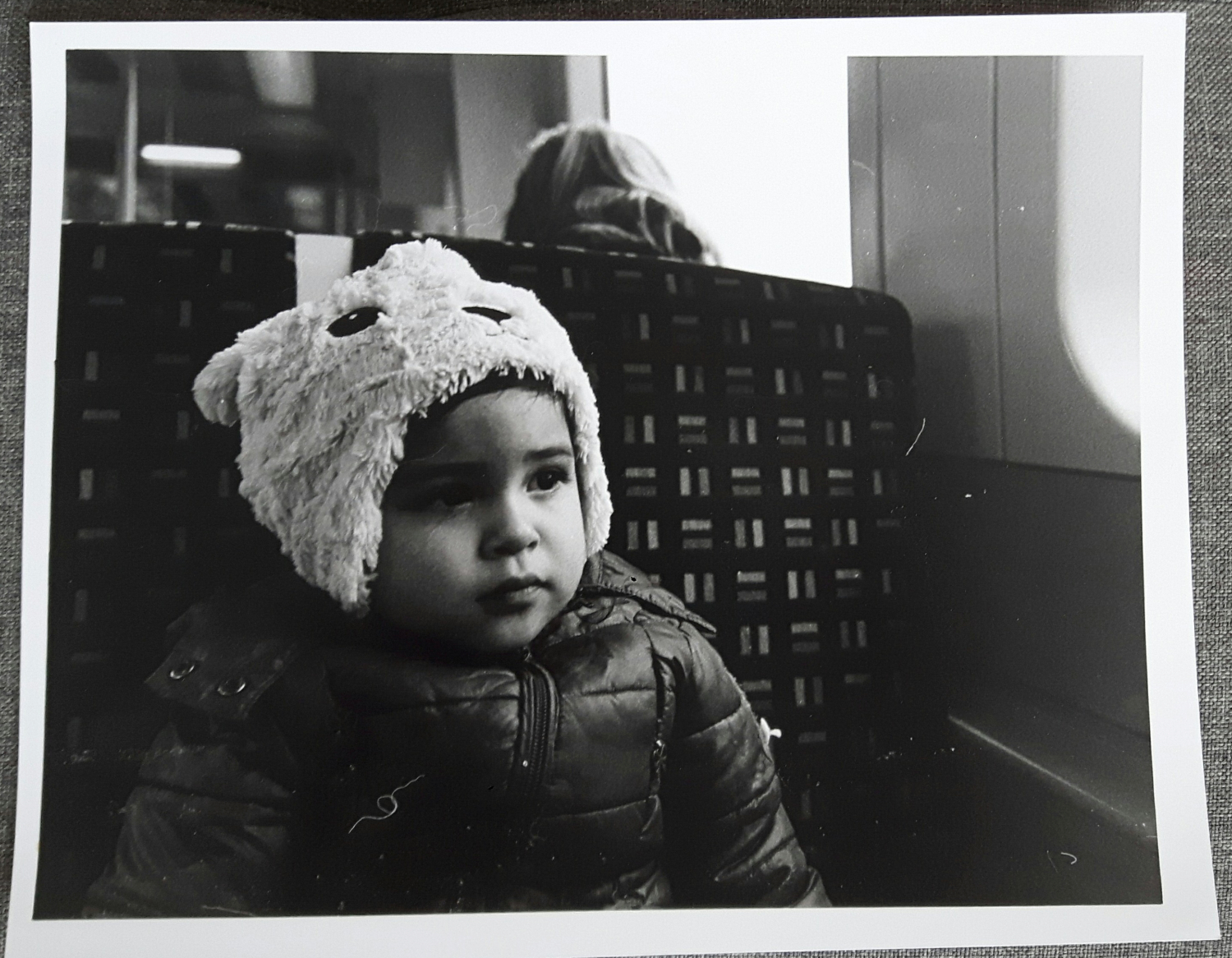

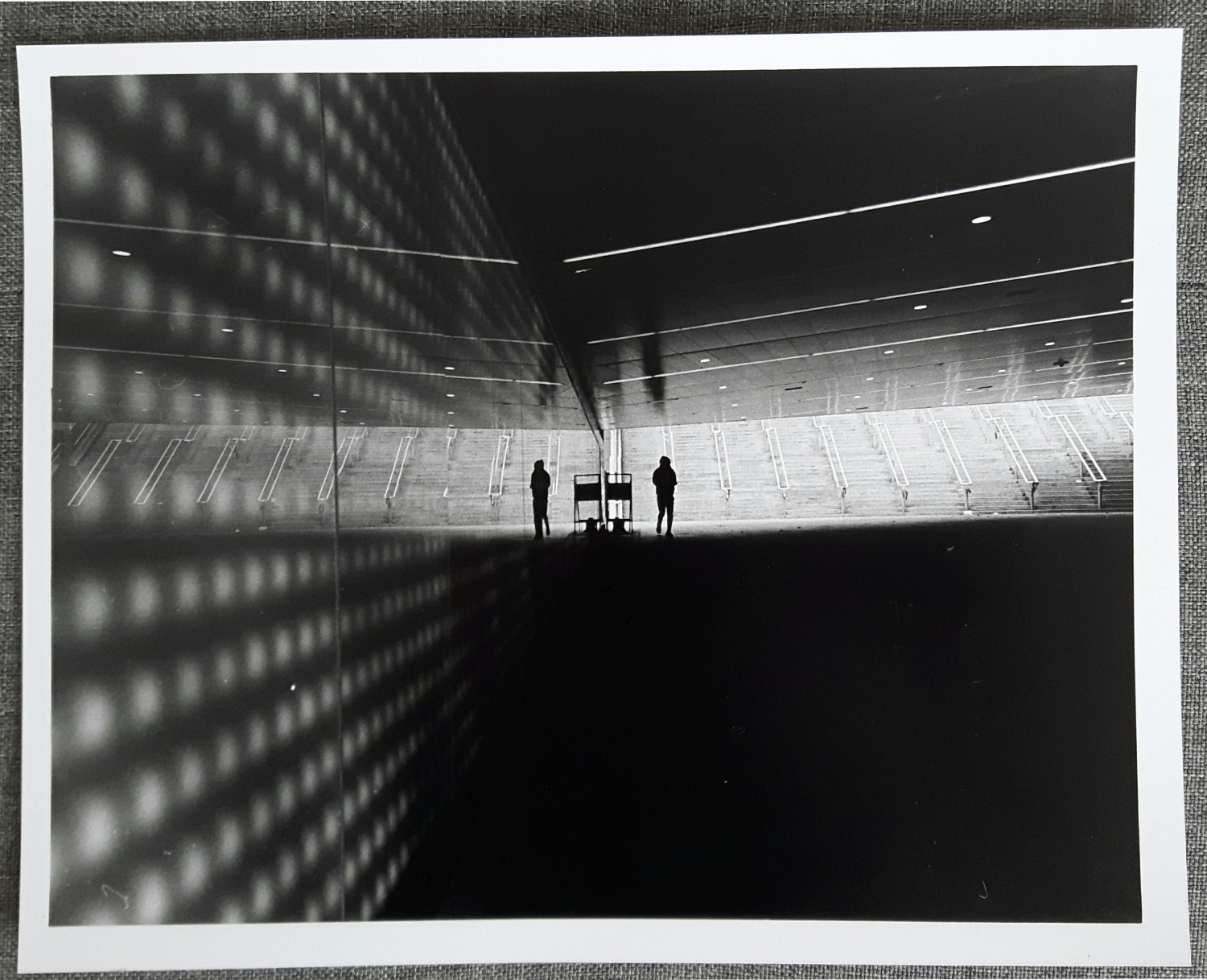

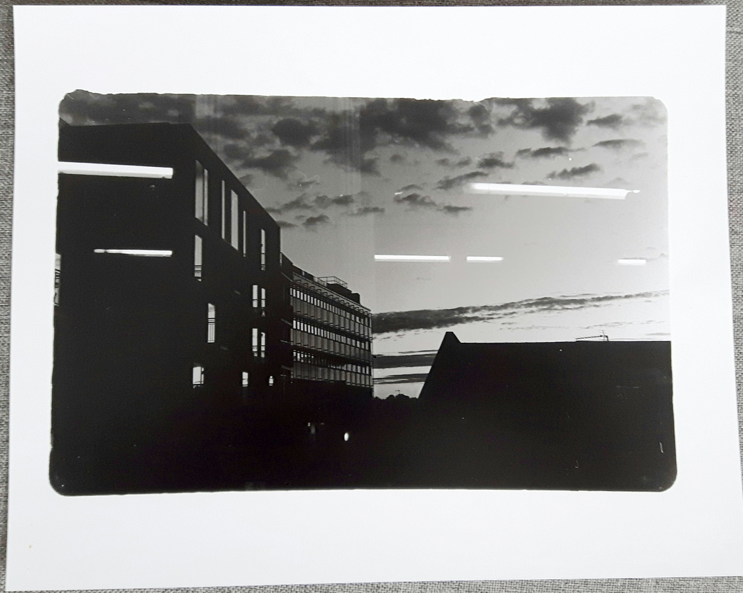

Well, here we go. Have done 3 prints/tests, very basic, no dodge and burn, only test strips in full stops and filters changing...for now. I just basically wanted to recognize the process, see it happening.
These are cellphone shots (not very good for photos actually) and images look with a bit more contrast than in paper. But its enough to have an idea.
This was in a train with the window light. Highlights are blown on top And
This was shot in the starting evening trough a window in a station. I wanted the silhouette in the foreground building but maybe would prefer the windows on it and the background building with a bit more light. The light on right hand side is due to the reflex of the station interior.
In here I think I just should have dodge the shadows in the right half of the image or maybe expose them less and then burn the highlights?

Great pictures, all you need to figure out is how to make things look the way YOU want them.

How are you working out correct contrast filter? You need to find the happy medium of highlight detail and shadow blacks. If your highlights on your test strip are coming in early you need more contrast, if late less contrast....sort of.
The first picture is a great one for dodge and burn. Your highlights on the left side of the little persons face are just right, good starting point. Their left eye just needs a little dodge maybe 1/4 of a stop, Right side needs a bit more work. That will require two lots of dodging, a little extra on the eye. The rest is up to you, dont think it would mater terribly. I usually cut my dodging cards for each job, some have a set they use, lazy people like Matt use their hands :roll eyes:.....actually hands are good sometimes, especially skies and big areas. Watch out for shadows of dodging wire or arms and hands.
The other two lack shadow detail, If you can see it on the neg you might pick it up with a higher contrast filter, then less contrast on the highlights....tricky.
You'll get further along with a good negative with highlight detail and shadow detail of only a few stops difference. Tricky negatives require a lot more work. Once you get the hang of it you can control the final out come much better.

The actual prints show a bit more detail than in here, but yes I guess the 2nd and 3rd negatives are a bit thin. As I said in my post I always had the tendency to slightly under expose, probably from many years in digital and being more careful with the highlights. I will pay some attention in my next roll.
When you say "happy medium of highlight detail and shadow blacks" you mean that I should have both as close as possible in terms of stops, right? So If I find my ideal highlights details at 11 seconds and my shadows at 32, that means I need more contrast, correct? So then I would run another test strip with a higher contrast filter, or more, fine tuning until I get it...any sense in this?

This is just fine tuning. So for the first picture you would do a full picture test strip. I would be p
