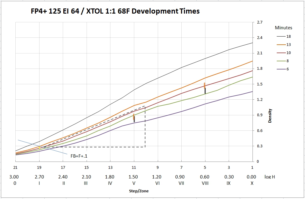

I wonder if anyone in the know could weigh in on a question about modifying film speed based on tested development times.
Background: A while back I determined an EI of 64 for FP4+ 4x5 film, developed in stock XTOL. A few days ago I exposed 5 sheets of film to a blank white target, in full sun, overlain by a 4x5 Stouffer step tablet, and developed them at times from 6 minutes to 18 minutes. The developer was XTOL diluted to 1:1, in contrast to the development of my speed test sheets with stock XTOL. I've attached a plot of density vs step (or Zone) for the development time test sheets.
I thought I would determine the optimum development time (for FP4+ EI 64 developed in XTOL diluted 1:1) by noting which curve intersected the vertical target bars at Zones V and VIII (the 4 small vertical bars. They cover Ansel Adams' suggested target densities for diffusion (orange bar) and condenser (black bar) enlargers). Obviously that didn't happen with the development times I selected, and I don't want to consider shorter development times than 6 minutes.
The data I used to determine speed indicate a linear progression in density vs exposure in the Zone V through Zone VIII interval, which is what makes me think that I can use these development test data to deduce a reasonably accurate film speed, without resorting to new speed and development time tests. It looks to me like an exposure decrease of 1 stop would bring the 10-minute development line into the range of AA's target densities. Is this a sensible idea?
Any thoughts or suggestions about this approach?

Increasing development time does not raise the film speed, it raises the contrast only.
I eyeballed the numbers which makes my graph “unreliable” but wanted to see what’s up. You used a standard developer so I called rated speed 125 where ASA/ISO parameters are met (about 11 minutes).
Your interpretation mistake: You need to look at numbers “above filmbase plus fog” (Ansel Adams - The Negative pg. 220) which gets you in the 8-10 minutes for N range and makes everything look right.
I would call 10 minutes N and recommend ISO 125 for averaging/incident meter but EI 80 for field use of Spotmeter with Zone System readings and placement of shadow subject luminance values. That’s general advice and I found your 10 minutes gets you there. 16 minutes for N+1 EI 200 / ZS-EI 125. N-1 7 minutes and N-2 6 minutes. (EI 100 / ZS-EI 64).

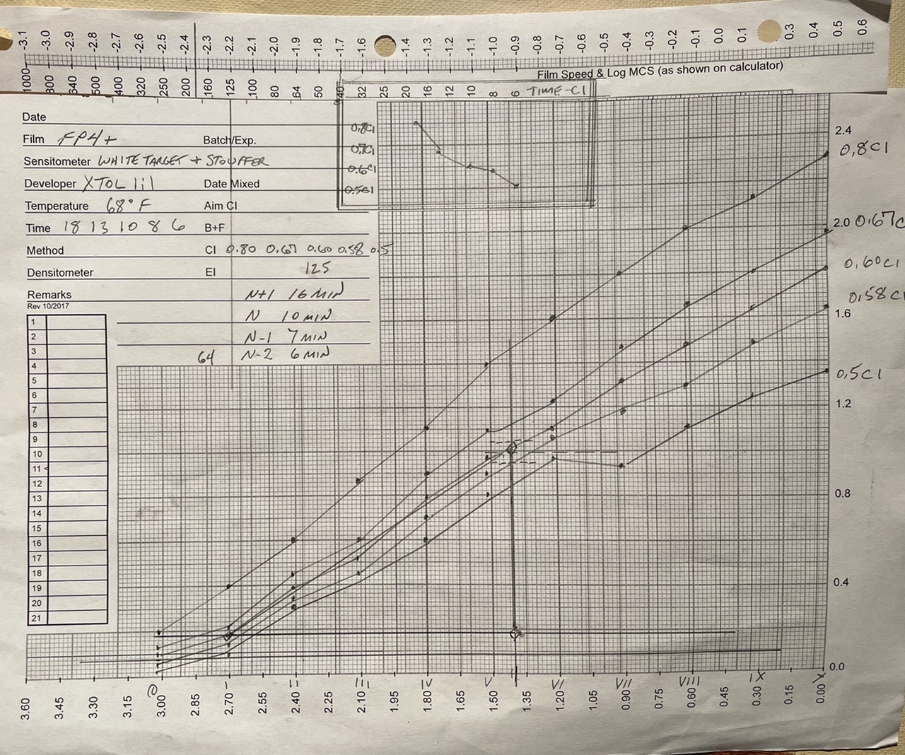

Now I had to shift the film speed on my graph 1/2 stop. You can see where I cut and taped the scale.
You gave the film a half stop greater exposure than you said you did.
I drew the graph based on what you called Zone V.
The characteristic curve lines on the graph illustrates the true characteristics of the film.
Then based on the characteristics of the 10 minute curve that met the ASA/ISO parameters, I shifted the scale to line it up with -2.2 log meter candle seconds, because that’s how much exposure would make a 125 rated film reach 0.1 density above filmbase plus fog. The film is just going to do that so that’s where the scale calibrates to be.
This half-stop shift is worth exploring.
It is as if the patch of the Stouffer scale you called “Zone V” is one step away from the one you should have callen “Zone V”. You should have picked one step lighter (less density). Also the first step of a Stouffer scale is not clear. It has about 0.05 (a third stop) filmbase plus fog.
If that wasn’t it, all these things could factor in to the difference between “what you said you did” versus “what you got”: Shutter speed accuracy, meter accuracy, the nearness of what the meter advised to the shutter speed and f/stop picked (I keep 0.1 and 0.2 ND filters for camera based film speed testing so that I can match the meter reading to the camera settings more precisely). You might not have T-Stops on your lens (but that would factor “the other way”).

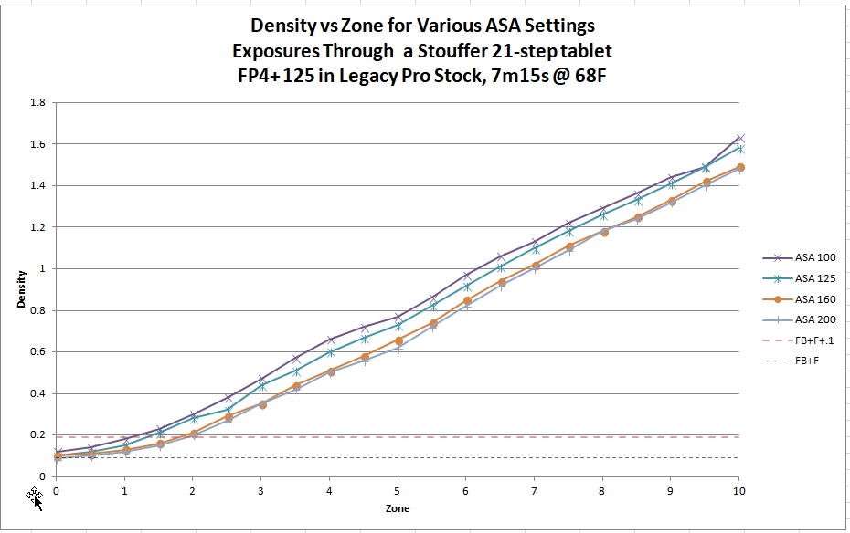

Bill, I have a certain result sticking in my craw, that's inhibiting my confidence in my dexterity with the H and D charts. And it's this: twice I've followed the same procedure to determine film speed for FP4+, with results that seem at odds with published data.
The procedure was to photograph a white field - in full sun - for a Zone X exposure, on four sheets of the same film, with ASA settings of 100, 125, 160 and 200. For each exposure, a Stouffer 4x5 Step Tablet overlay the negative. All the negatives were developed at the same time, identically. I used a Tobias densitometer to evaluate the step tablet image densities for each negative. The resulting H and D curves are attached.
The curves are ordered in a sense opposite from what I expected based on what I've read (Beyond The Zone System, 4th edition, Phil Davis, pg 53 for instance). But as I actually think about it, the left-to-right order of the curves drawn from my data makes sense to me : if I expose a sheet of film for a shorter period of time (higher ASA), all other things being equal, the step tablet densities should be smaller than those on a nominally identical sheet exposed for a longer time (lower ASA). Hence, curves representing increasing ASA for the same film should be arrayed with film speed increasing left to right. Davis' figure 4-16 on page 53 of the 4th edition shows speeds increasing in the opposite direction.
Likely, Davis' example is meant to illustrate determining speeds for 5 films of different speeds, but I didn't see that spelled out, and initially assumed that a single film stock was being tested at different speeds. Around the same time I saw a plot that ramified what I (mis-)understood about Davis' plots. Obviously, as a semi-muddled amateur, I'm not going to call out Mr Davis. So I'm looking for a bit of confirmation on my speed test results and my current interpretation of Mr Davis' plots. Can you comment?
I’ll dig the BTZS book out after the weekend.
You don’t need to make various exposures of the Stouffer scale except to find one nice exposure for that speed of film. Davis puts too much emphasis on getting the test exposure correct. Getting the test exposure consistent is the thing.
Shift the x-axis for each of the four curves here. The curve of the four sheets should superimpose exactly except at the ends where you have a little more or less showing.

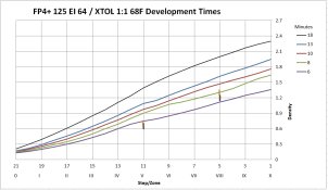

An improved chart is attached. The ISO triangle is aligned to the 10m development curve.

Once you hit the ASA parameters the light meter is irrelevant. Fresh film characteristics are the one thing you can trust.
-2.2 log meter candle seconds is how much exposure will make a 125 rated film reach 0.1 density above filmbase plus fog.
You can try to evaluate any difference between where you expected that point to fall and where it actually falls. The answer to “which light meter better evaluates exposure” can be seen by which one came closer to predicting that point. But other things may factor in, so even if you form an opinion, you may be wrong in reality.
