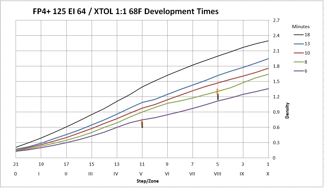

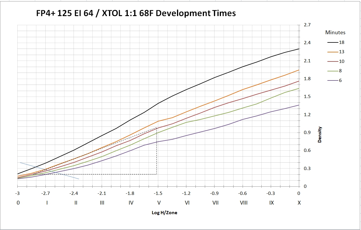

Greetings.
I wonder if anyone in the know could weigh in on a question about modifying film speed based on tested development times.
Background: A while back I determined an EI of 64 for FP4+ 4x5 film, developed in stock XTOL. A few days ago I exposed 5 sheets of film to a blank white target, in full sun, overlain by a 4x5 Stouffer step tablet, and developed them at times from 6 minutes to 18 minutes. The developer was XTOL diluted to 1:1, in contrast to the development of my speed test sheets with stock XTOL. I've attached a plot of density vs step (or Zone) for the development time test sheets.
I thought I would determine the optimum development time (for FP4+ EI 64 developed in XTOL diluted 1:1) by noting which curve intersected the vertical target bars at Zones V and VIII (the 4 small vertical bars. They cover Ansel Adams' suggested target densities for diffusion (orange bar) and condenser (black bar) enlargers). Obviously that didn't happen with the development times I selected, and I don't want to consider shorter development times than 6 minutes.
The data I used to determine speed indicate a linear progression in density vs exposure in the Zone V through Zone VIII interval, which is what makes me think that I can use these development test data to deduce a reasonably accurate film speed, without resorting to new speed and development time tests. It looks to me like an exposure decrease of 1 stop would bring the 10-minute development line into the range of AA's target densities. Is this a sensible idea?
Any thoughts or suggestions about this approach?
cheers
Tom

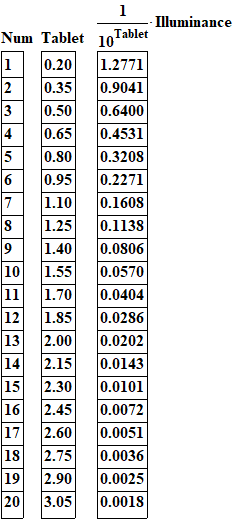

Here it is fleshed out for the entire step tablet. The metered exposure point of 0.064 lxs falls between the eleventh and twelfth step. If another step for the speed point is preferred, it's easy enough to pick which ever step you want to use for the aim speed point. Hopefully I didn't make an error in the calculations.

Stephen, thank you for this. I'll apply this data in my next test cycle - which will be in about 2 weeks, if entropy permits. In the meantime I'll see what I can think up to improve my test operation.
cheers
Tom

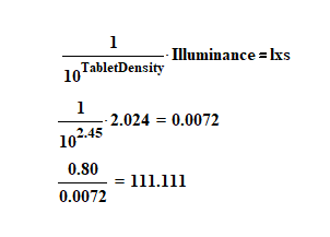

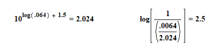

To start, a meter wants to make the metered exposure at the film plane 8 / ISO. For a 125 speed film, that will be 0.08 lxs. Black and white speed equation is 0.8 / Hm. For 125 speed film, Hm = 0.0064 lxs. It is 10x less exposure than at the metered exposure point or a difference of Δ1.0 log-H. I use a Kodak step tablet, and let's say I want 0.0064 to fall on the third step from the darkest step which is a density of 2.75.
Correction: 8/125 = 0.064
Also, for your method of opening up 5 stops.
The illuminance is 2.024 lxs and the step density where 0.0064 will fall is 2.50.
What if 0.10 over Fb+f falls at another point on the step tablet, like 2.45?
For an exposure of 2.024 lxs
I like to have the speed point fall between step 18 and 19, that way you expect to have to interpolate the graph position of the speed point (less chance of “confirmation bias” than if you aim for a step to be 0.1 above filmbase plus fog). Also it is useful to have one lower density result to see what the toe shape is like.

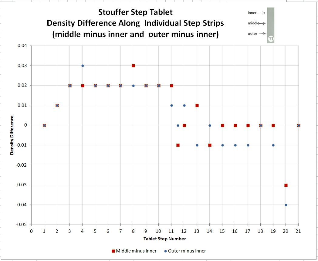

Bill, a question about your plot on your post #3: I see that the zero point of the upper scale (the film speed scale) is offset from the zero point of the lower scale (the Log H axis) by about 0.3 units. That's not including the offset created by your cut-and-tape adjustment. Otherwise, I believe both axes are graduated in 0.02 log exposure units per division. Could you mention the nature of the offset between the two axes?
You are correct the ruled lines are 0.02 log units. This allows graphing to 0.01 precision because the in-between marks are legible. The bottom axis is the density of the step wedge over the film. I have calibration lines for the actual densities of the step wedge, so thats why you see some in-between vertical lines. Zero on the lower scale means no density over the film.
The top scale slides back and forth to match my opinion of what the actual sensitometer exposure at the film plane might have been. Zero on the upper scale is one meter candle second.

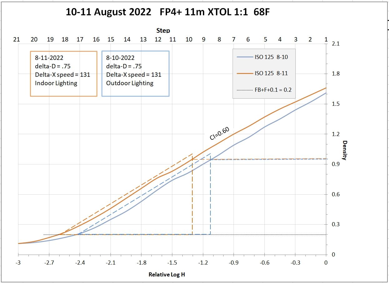

Greetings.
A couple of film speed tests are documented in the attached graph. I attempted to clean up my test procedure, following comments by Bill and Stephen in posts preceding this one. Errors are obviously mine. One thing that became obvious is that my control over most of the test process was modest, and in several ways it isn’t likely to improve substantially with my current hardware. The wetware contribution … hmmm….
I did test and put into service the most precise shutter and shutter speed at hand. Every exposure was taken at 1/8s in a copal 1 shutter, which in current and previous tests had less than 1% variability over 5 consecutive shots. I've never had reason to doubt the apertures in that shutter, but the accuracy and repeatability of the apertures are unknown. I did have to use apertures at and close to the f8 extreme.
Uniform target illumination? Indoors, I cobbled together 7 disparate 'daylight' lamps and droplights and arranged them so that the target (white matt board) was uniformly illuminated. After the test shots, about 10% of the photographed target was 0.2EV brighter than the rest of the target.
Outdoors, it was a sunny morning with very light cirrus. I made sure that I exposed within 10 seconds of metering to obviate source variability. I metered the target (the same target used indoors) before and after the series of test exposures and measured no variations in target uniformity.
I only now have realized the role ND filters could play in my outdoor shooting and in this test. I could have brought the outdoor illumination down to place the speed point about where I wanted, but instead just accepted what the good lord Sun gave me. Indoors, the target illumination was coincidentally about right to place the speed point close to step 18. A lesson learned there.
All the negatives got exactly the same treatment in an SP-445, including a fresh batch of xtol 1:1 for each of the two developing runs. After taking densitometer readings of the test negatives, I saw some mottling on the Stouffer TP 4x5 tablet and wondered about its effect. I took densitometer readings of the step tablet density strips, at the extremities and at the middle of each step strip. A plot of those results is attached. Each datum is the quantity “density reading at the middle(outer) part of the step strip minus the density reading at the inner edge of the step strip”. The strip inner, middle and outer locations are indicated in an image to the upper right of the plot. I haven’t evaluated the effect on the film curves yet. Time for a new tablet I guess – though I haven’t tested a fresh tablet in this way, to know what intra-strip variability is inherent in the product.
In the H&D graph, the large triangles are ISO triangles 1.3 in log H along the horizontal base, 0.8 in density units along the perpendicular leg. The horizontal lines intersecting the triangles and the right hand density axis are used to indicate the delta-D value for the Delta-X speed computation. Hope I got that right.
Cheers
Tom

Interesting that indoors curve is “to the left” of outdoors in Tom’s tests.
A slightly longer development time may have hit the ASA triangle better.

Bill, the plot I gave of the step tablet density differences is of the Stouffer Tablet itself, and not of the negatives I made with the tablet+negative 'sandwich'. The Stouffer Tablet strip density variations worried me, as I figured they would transfer their density inhomogeneity to the negatives.
I don't understand why the two curves are not on top of one another, given that the negatives were both exposed 5 stops over the metered value on the same target. It did cross my mind that there could be a convolution of different light source spectra, meter spectral sensitivity, film spectral sensitivity, and target reflectivity at work. But that's above my pay grade to evaluate.
