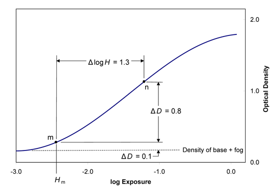

ic-racer
Feb 25, 2007
16,728
USA
Understood. And thanks. So, using a densitometer, one measures a density 'D' of the negative uniformly exposed at Zone I, computes the product 0.1*log D .... and does what exactly with that number? I think I'm missing some context or background here.
0.1 is the value and ‘log D’ is the nomenclature for the units: the logarithm of optical density.
On the diagram below the 0.1 log D point is ‘m’

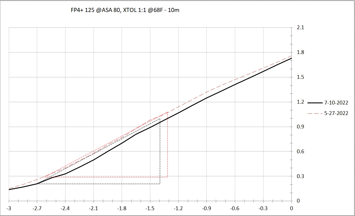

Quite a delay here, sorry to take so long to come back - I wanted to try an experiment to reduce flare. To that end, I shot a new test negative and developed it as before. For the test exposure I used a larger target and a longer lens (with a smaller acceptance angle) so that I could shoot from farther away from the target: about 5' away from the camera. I used an extended lens hood, and shot at sunrise, when the target was just about level with and perpendicular to the sun's direct rays. I reasoned that these adjustments would reduce the number of off-axis rays entering the lens. Also, instead of a white target I used a grey matt board.
Metering was with the same Sekonic as before, which I had adjusted to match my Minolta Spot M (post #45)FP4_Dev_Time_7-10-2022.jpg.
Attached, a plot showing the new curve - in black - and the curve from the last plot I showed a few weeks ago. The FB+F+0.1 value for the earlier test shot was 0.27, and for the current shot it's 0.21. The right-angle apex of the ISO triangle is still about 1/3 stop away from the nominal Zone V value. I'm thinking that if I shot this film at ISO 125, the alignment might improve.
Metering was with the same Sekonic as before, which I had adjusted to match my Minolta Spot M (post #45)View attachment 310308.
Attached, a plot showing the new curve - in black - and the curve from the last plot I showed a few weeks ago. The FB+F+0.1 value for the earlier test shot was 0.27, and for the current shot it's 0.21. A difference due to flare, perhaps? The right-angle apex of the ISO triangle is still about 1/3 stop away from the nominal Zone V value. I'm thinking that if I shot this film at ISO 125, the alignment might improve.
I realize that attributing the difference in FB+F to flare doesn't fit. I measured FB+F in the blank patch left on the negative by the taped patch on the stouffer step wedge, and the density was 0.1 both the July and the May test shots. The rebate measurements were different - from each other and from the tape blank - in the two test negative runs, and I used those in my plots, to maintain continuity with earlier tests. Now it seems to me that I should have used the tape blank.

Tom,
If the step tablet was sandwiched over the film, then flare wouldn't be a factor. It's flare free. If you are wondering about the difference in Fb+f between the two tests, that sounds like fog. You need to make sure a the Fb+f section measured receives zero exposure.
The two tests appear to have about the same gradient. The displacement is from exposure. The test from May had more exposure than the recent one. If there was any extraneous exposure striking the area of the film where you measured Fb+f, then that part would have received more exposure in the May test and would have a higher density than the recent test. Process a blank sheet to guarantee a baseline if you are wondering what is causing the difference.

Tom,
The two test appear to have about the same gradient. The displacement is from exposure. The test from May had more exposure than the recent one. If there was any extraneous exposure striking the area of the film where you measured Fb+f, then that part would have received more exposure in the May test and would have a higher density than the recent test. Process a blank sheet to guarantee a baseline if you are wondering what is causing the difference.
Stephen
Stephen, thanks for your comments. I applied a bit of opaque tape to the step wedge, which left a spot on my negative that was not exposed. That patch on my negatives has measured 0.1 or 0.11 consistently. I erred in taking measurements from the rebate when the blank patch was available. Using the blank patch to compute FB+F+0.1 (= 0.2), rather than using the rebate for the FB+F+0.1 (=0.27) measurement, causes the anomalous 1/2 stop shift in the ISO triangle to disappear (Bill Burke's post #6). The plot below shows the relocated ISO triangle with base at 0.2 density units.
My apologies to the respondents to this post for dumb errors. I have learned more than a bit though, so thanks. Lesson not the least: the initial topic - could I use an systematic analysis of developed negatives to derive a more appropriate film speed for future shooting - may be more relevant once I have greater mastery of basic ideas and practice.
