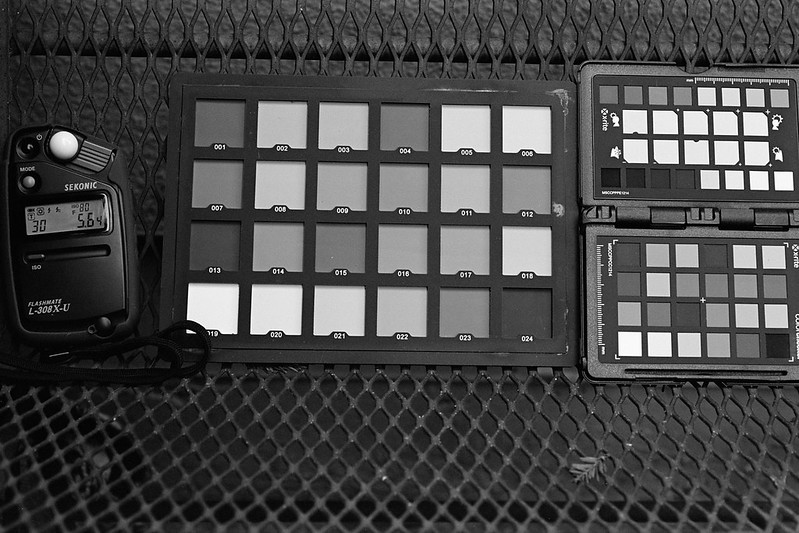

Here is my latest roll, captured in a Nikon F6 with a Zeiss 35mm distagon f/1.4 lens. Shot at 80 ASA and incident metered. Developed in Kodak TMAX Developer 1:6 24C for 7 minutes with an initial 4 minute 24C soaking. Pakon F135 scans and inverted using Imagemagick and Negfix8.
https://www.flickr.com/photos/thekurgan/albums/72157716869618168
https://www.flickr.com/photos/thekurgan/albums/72157716869618168View attachment 259353 View attachment 259354 View attachment 259355 View attachment 259356View attachment 259357
