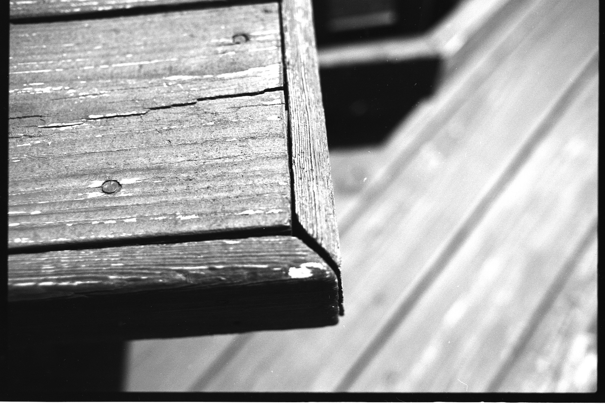

These two pics may help in this discussion. The B&W is P30 in D-76 straight. The color with a Leica M240.
And in that example, it's behaving more like a pan film should.
You may not be referring to the pic Andrew but certainly that is how I'd expect a panchromatic film to render the colours. I was puzzled about the behaviour of P30 in terms of what is the truth about how it renders colours and after recent posts I remain puzzled
Very interesting. To me that clearly points to the fact that it has strong ortho tendencies. The purple wing tips barely register against the blue background. And the darker blue feathers actually appear lighter than the gray/blue wall. The darkest color rendered in the wings is the red.
Am I missing something with my statements above? I was seeing the opposite but maybe I'm missing something.
Thanks for sharing! I was expecting the blue to be light but I'm surprised the red isn't darker. It's interesting to see the blue and yellow equalize the way that they have.
I would generally agree. In fact it seems even more blue sensitive than ortho, with some bumps (perhaps in yellow but really hard to tell).
A reasonable take. Yes, it does seem blue sensitive AND not very red sensitive. And the different scenes being filmed would then react in quite different ways.
