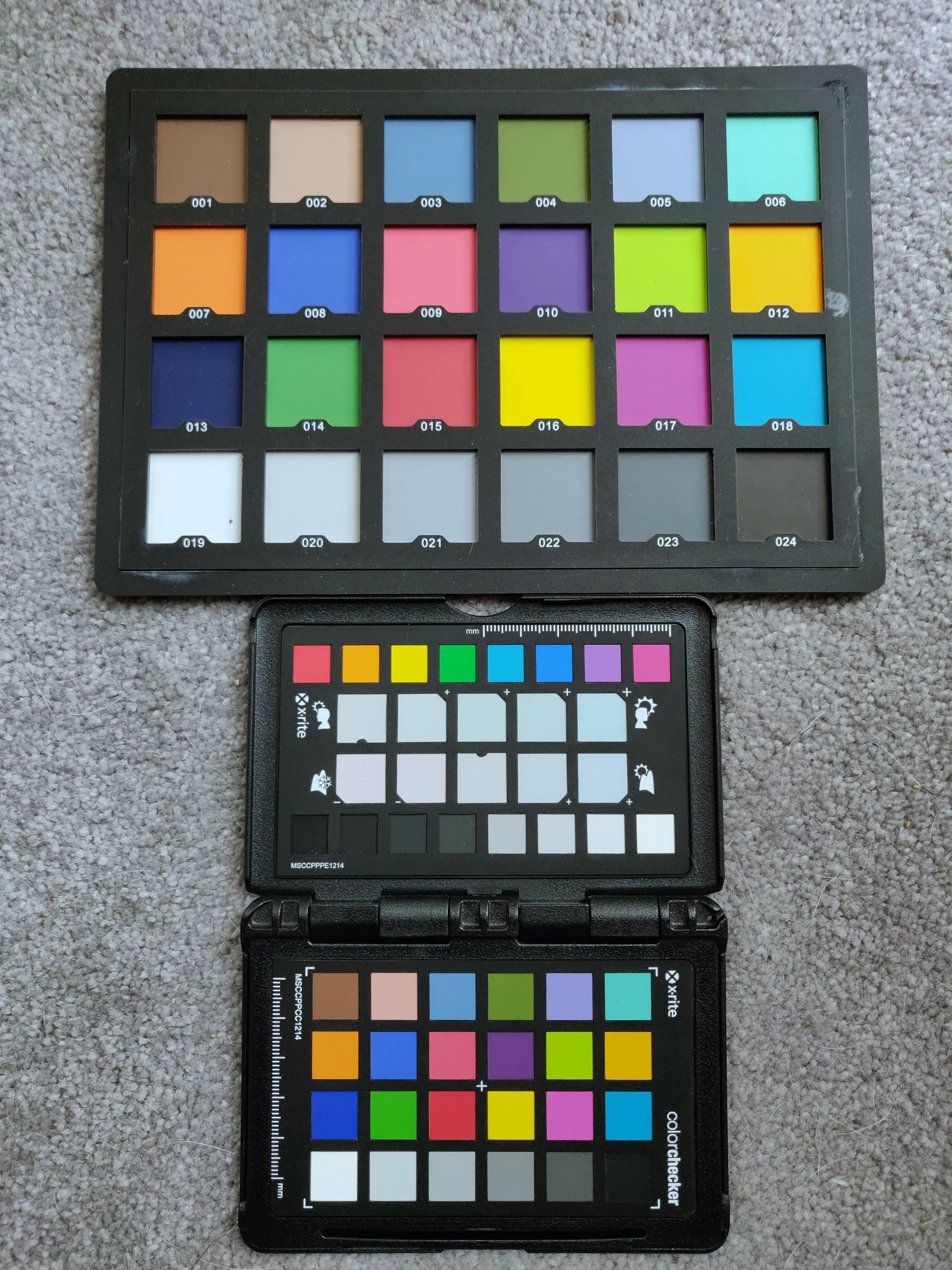

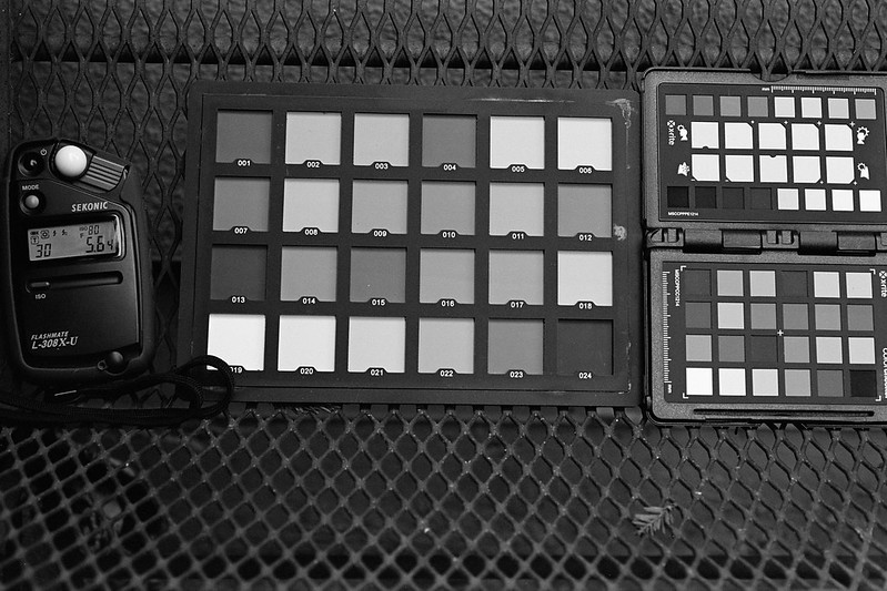

Finally looking at Scott's colour charts it rendition of what looks to be mid blur to me, namely square 013 does seem to be rendered very dark and yet the lighter blues of 003 and 008 are almost white while what appears to be a slightly desaturated red is rendered what I'd expect a panchro film to render it as.
So it remains confusing for me
Scott can I finally ask if the bottom set of unnumbered coloured squares marked as Xrite are the same as the topmost set which are numbered are different from topmost set of numbered squares. I assume not as they look different but based on the Xrite squares in shades of grey the red and blue are both darker than I'd expect a full panchro film to render them but red is clearly darker than blue and here the red appeared top be rendered as dark as you'd expect a genuine ortho film like Ilford Ortho 80 Plus to be able to?

This is really not neuro-surgery. Greg’s tests with the colour chart are pretty good. If you are unsure, it is very easy to test this for yourself and get a good enough answer for all practical purposes.
Thanks, michae-r, for that I was confused as to which colour chart the B&W charts came from in Scott's last post. As I said the rendering of the blues and reds as shades of grey seemed to vary and I wasn't which greys were the equivalent of the deep mid blue and mid reds. In one case the blue certainly looked darker than the red but no doubt Scott will elucidate
So what's your conclusions about how ortho P30 is based on either your experience or Scott's charts or indeed Greg Davies' chart in his video where both red and blue rendering looked to produce greys that were darker than I'd expect panchro to render them and looked both equally dark. I certainly found that a puzzle

I used two different charts, the X-Rite is the standard and the other I have used for indoor digital shooting. I posted the color version in case someone wanted to compare the numbers and colors. I captured the color images in the same light as the P30, but had to use a cell phone to do so (not color accurate, but shows the different shades). Below is a color chart of P30 using Silvermax developer using their 100ISO Silvermax film recipe (same lighting, overcast).
Since their red colors varied a bit, I captured both. I believe the ortho tendencies varies greatly by developer used. Another big difference is my images are scanned as images on a light table of 5000k. Greg made proper prints and if water wasn't so costly here, I would as well. TMAX Dev seems to be a nice, low contrast developer for most films I use it with, especially Acros and now the P30 and it give me the look I have desired from the motion picture variety used in the 60s.
Thanks Scott. I hadn't realised that the ortho tendencies of a film can be influenced by what developer is used Over the years my impression is that we spoke little of ortho films here on Photrio, simply because until Ilford's new film there was little of it about and what there was didn't seem to figure much on threads. Maybe others whose knowledge of such matters and interest in them is far better than mine can say if this is something they have experienced
What remains the case is that P30 appears to be a film where people's experiences if it and its "colours" do seem to vary by quite a bit and certainly if Greg's chart is right then both blue and red do seem to be rendered very dark grey which in itself is unusual - I think
As Andrew has posted above, a spectral sensitivity chart by Ferrania would be very helpful as would comments by them as to whether they discovered different developers affecting P30's ortho tendencies
I'd imagine that at the very least and until they publish a spectral chart, they might be able to confirm to what extent P30 did exhibit changes in colour rendition and whether in its present completed form how close it is to ortho
pentaxuser
pentaxuser, I went back and checked my print from Ferrania and it is the red and green patches that are very dark. The blue is much lighter than the other two. That would indicate the blue received more exposure, red and green less. I doubt very much that developers can influence how a film sees colors.
Yes, not only my red/green, but shades of tan as well are a bit darker. Is it possible developer speed loss makes all the shades darker as a whole?
Reds were always rendered extremely dark with P30, compared to pan films that I use. If it is a pan film, it looks like its sensitivity barely reaches red...regardless of developer. As michael_r stated, the developer has nothing to do with spectral sensitivity. I've got one roll left. I'll probably run it through D-23 1+3, most likely at EI 20-25, to see how that affects contrast, grain, tone, etc. I do hope they come out with 120. Would be great to compare it to Pan F.
