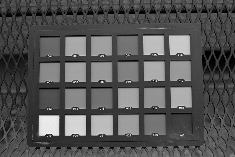

Looks like Ferrania P30 may not be panchromatic at all! May also be native ISO more like 32. Worth a watch.
Maybe his camera or developer has some type of issue. Density testing is closely tied to individual cameras and developer recipe/technique.
I've not experienced any ortho tendencies with P30 at 80 ASA. This chart is from P30 in Adox Silvermax developer, 80 ASA.
That's exactly what I thought !

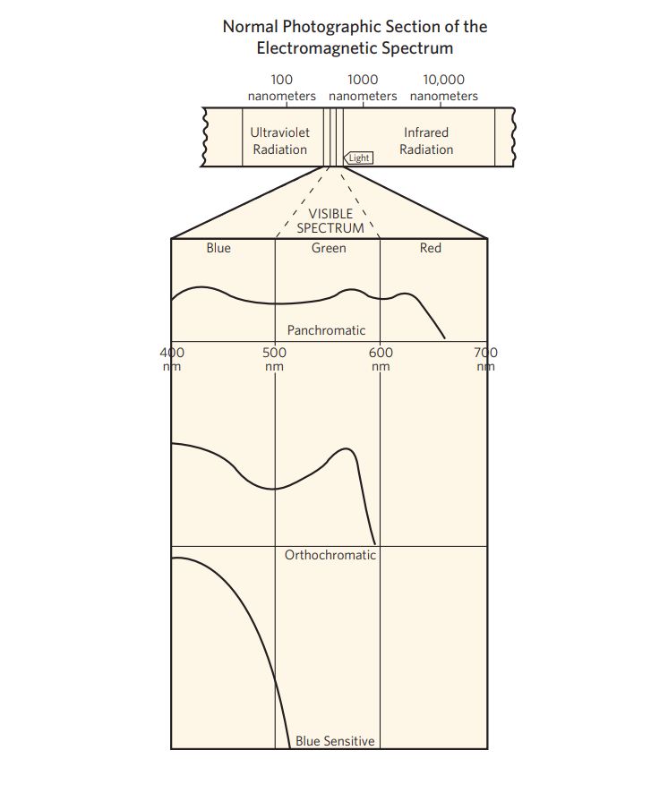

Orthochromatic films are sensitive out to yellow. Yellow is about 560-575nm.

An interesting video, Greg. I wasn't aware that ortho film was much less sensitive to yellow v panchromatic Does that mean that in say 3 portrait shots of you wearing a white, light blue and yellow tee shirt the brightness would be in that order but in fact it would be difficult to detect blue from white but yellow would be much darker?

Ortho is more blue sensitive, so theoretically at least, the yellow would appear darker than the other two. In this particular video, my skin tone (which is reddish) is darker than the Tri-X, and the light blue shirt is lighter. I don’t recall from memory if the yellow patch of the color chart is different than Tri-X.
Thanks Greg. I had to go back and look at the video again in case I had remembered it wrongly but in fact the yellow in the Ferrania was a lot darker From what I recall having seen how a panchro film renders blue and yellow it look as if the Ferrania renders it almost the exact opposite
What I am not sure about is whether all ortho films do the same or whether Ferrania has a quite unique rendition of colours that does differ from the rest of the ortho films.
Allowing for the vagaries of scanning even red looks to be rendered darker on Ferrania than say Ilford Ortho but this may not be accurate as I am not talking from actual experience but just seeing other users scans
